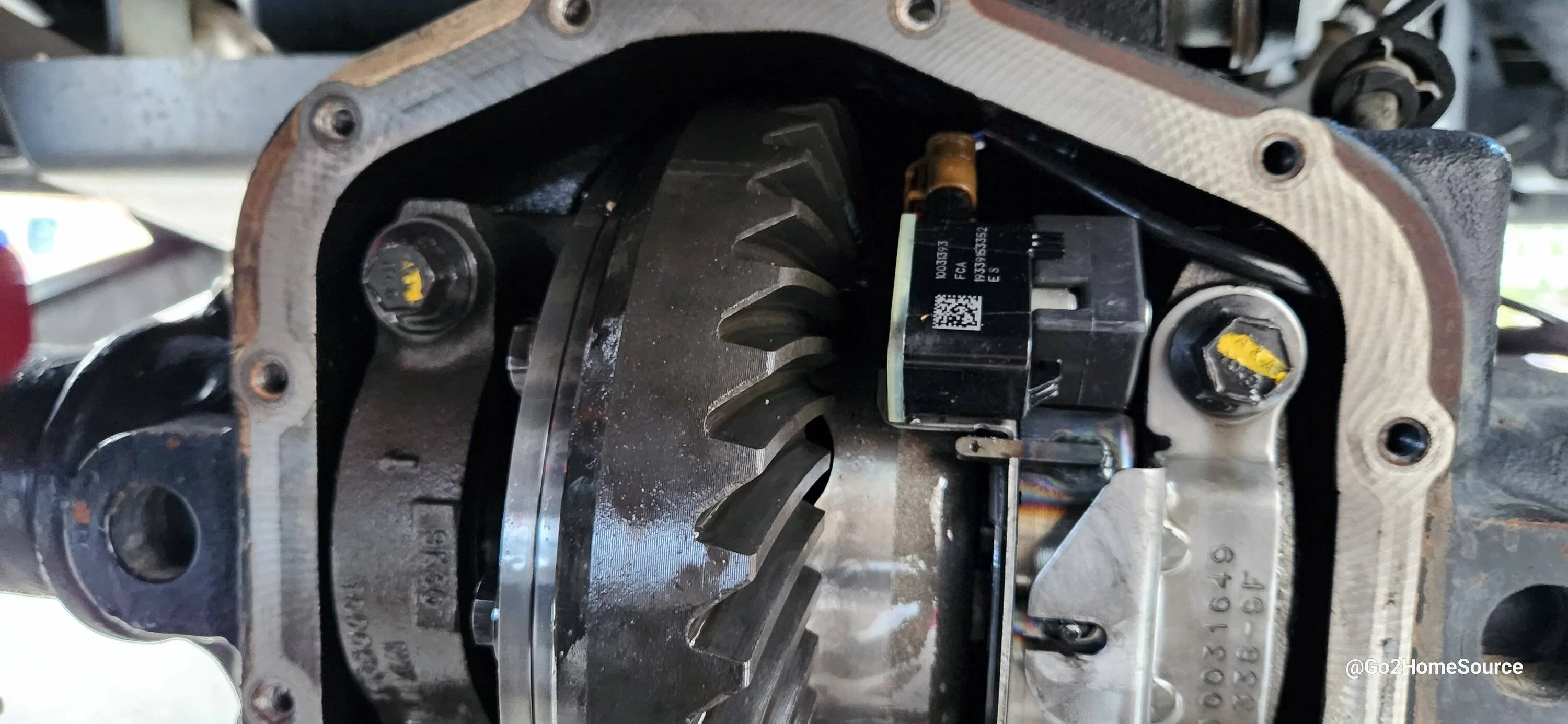

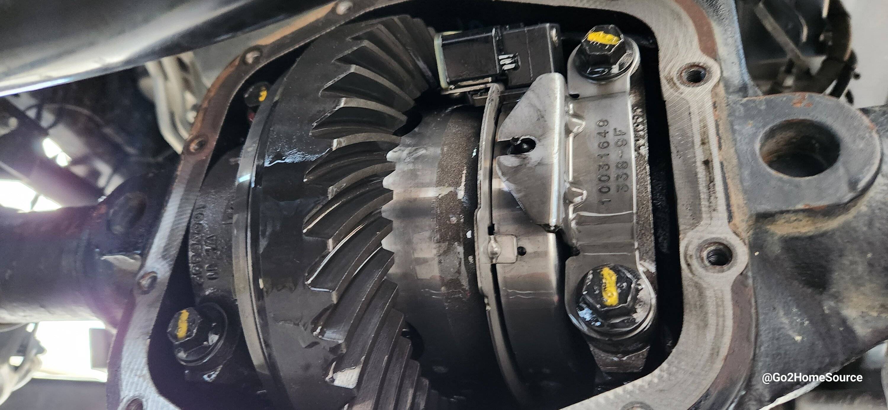

Would you still get the sound if you disconnected the front drive shaft (if noise was in front) I'm getting the whine above 45. Took off the cover and everything looked good but i notuce there isn't any yellow showing.
