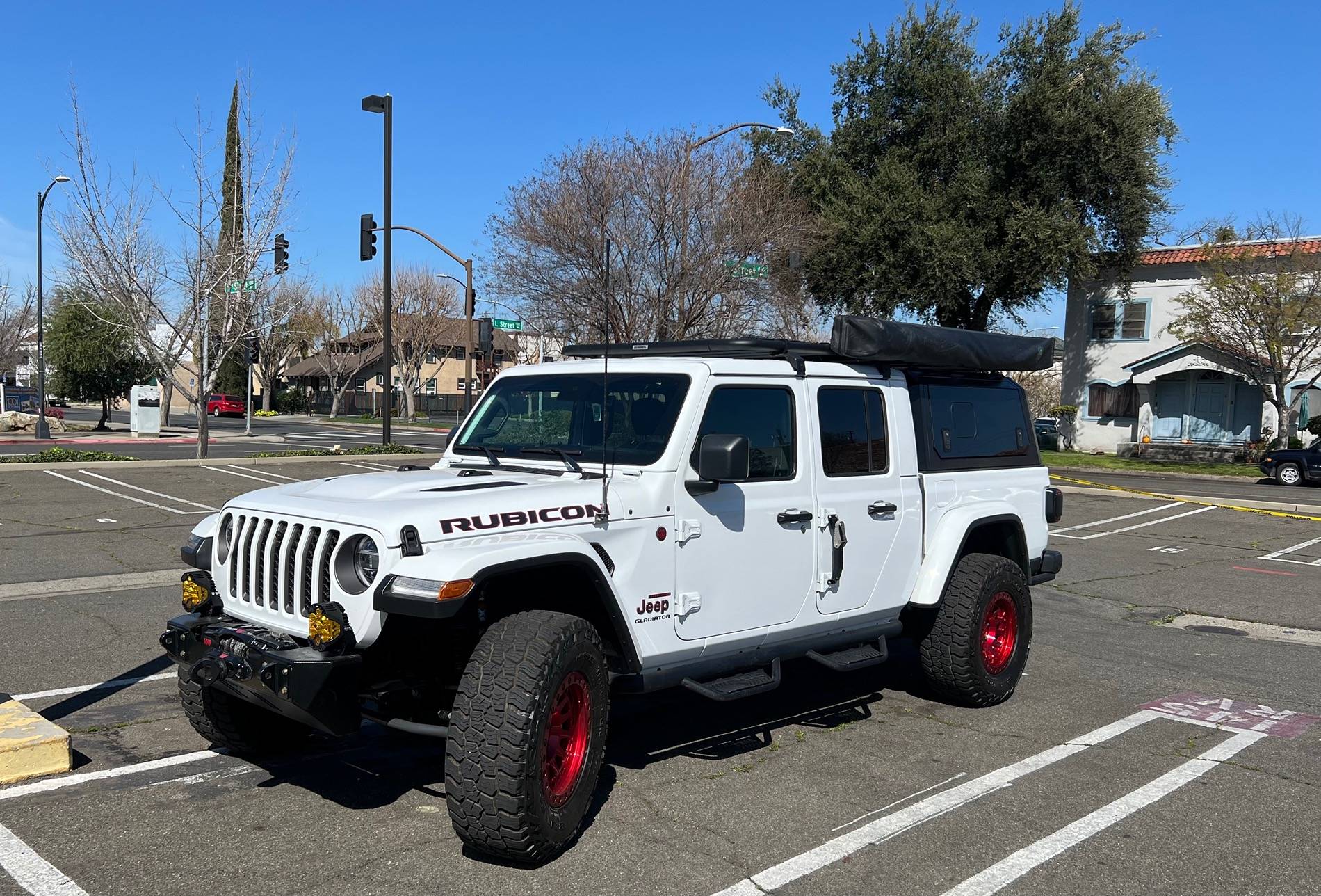

Hey all it’s me that new guy from Modesto nobody knows because he is new. I’m really not that bad. I promise.

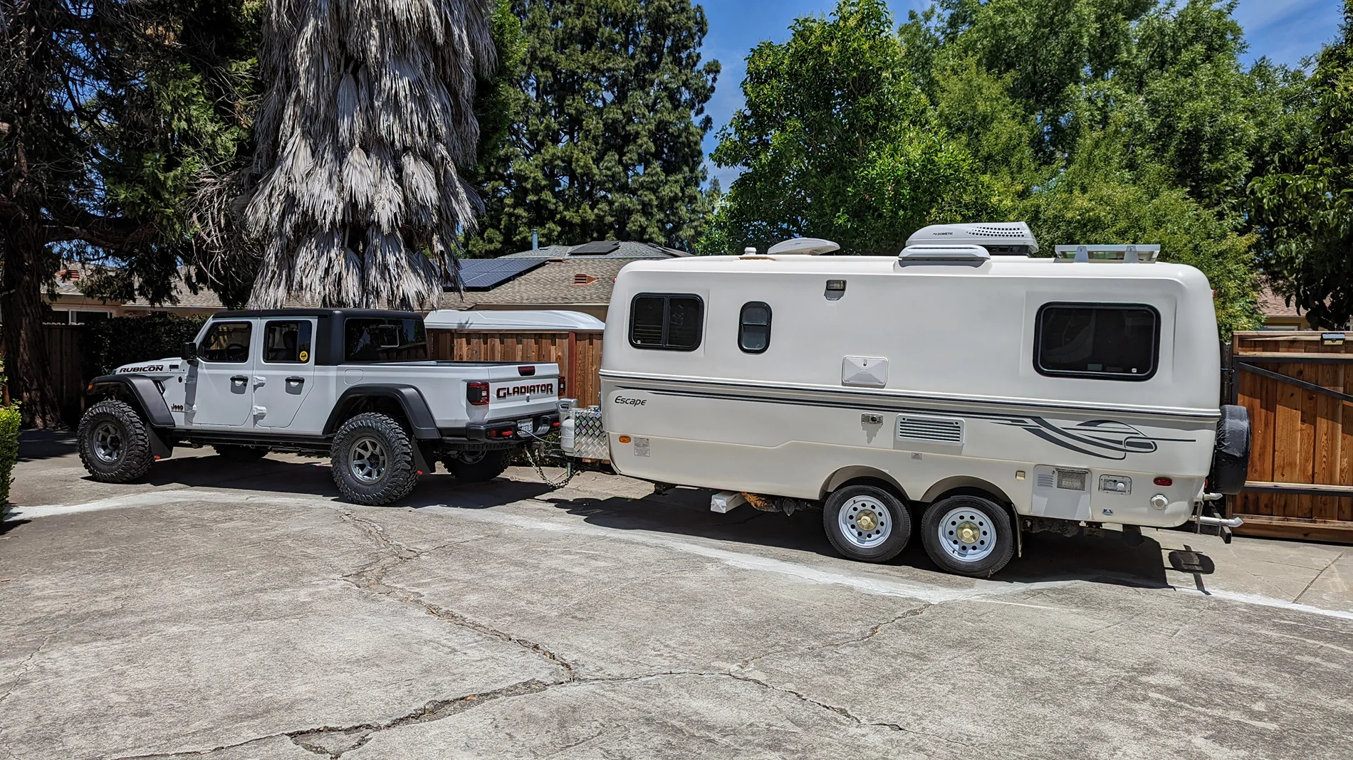

I have a diesel Rubicon with a Frankenlift: 3" RockKrawler Diesel front springs, 2 inch rear spacers with Airlift airbags in OEM rear springs, Icon CDCV shocks, MetalCloak sector shaft and track bar braces, Apex 2.5-ton tie rod.
Tires are 37x12.50R17 Yokohama Geolandar G003 mud-terrains on 17" Icon Rebound Pro wheels.
@ Rubicon4wheeler
You indicate you have the Eco Diesel on 37's and you pull a trailer. I was wondering how big and what kind of weight is the trailer. I also have the Eco and just got 37's, but still need the 3" lift this summer. I am wondering what gears you may have gone to as I am still using the 3.73. If I go to 4.30 it will be back close to stock RPMs but thinking about 4.56 which would raise my RPMs by about 200-250 which might be better for towing my 6k lb RV trailer.
(still trying to figure out how to do reference and quotes ) :(
I still have the stock 3.73 gears and on flat highway it'll idle along in 8th gear just fine until there is a significant headwind or I start climbing into the mountains. I've found no need to even consider regearing it. I haven't weighed my trailer but my calculations put it around roughly 4,000lbs. My Gladiator is particularly heavy, having been weighed empty on a CAT scale at 6,400lbs.
