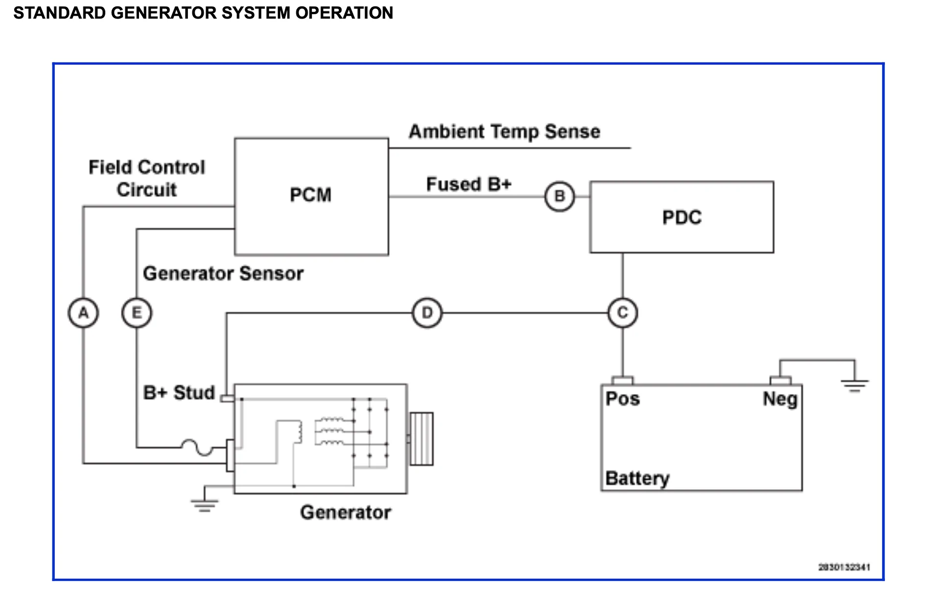

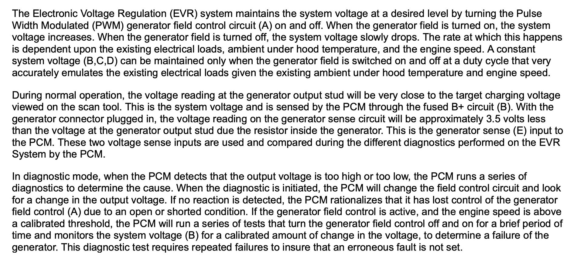

You can actually full-field the alternator to force a charge condition.
You need to disconnect the corrects wires at the alternator to do so, but it's possible to force it to see if it's alternator or control issue.
You can also check the state of the wires at the alternator - if there's field current and so on

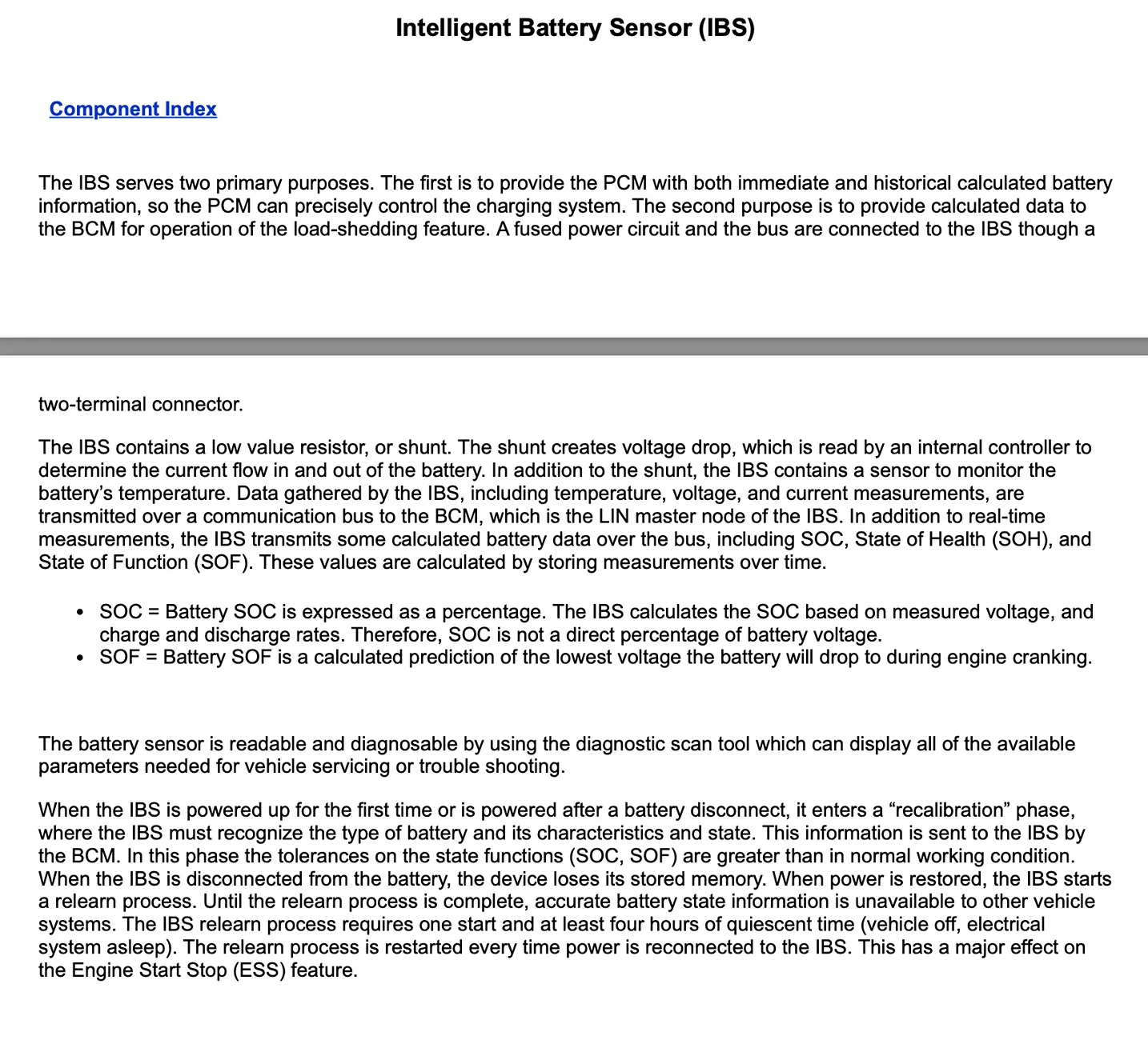

I would still look at the IBS. You could have a bad alternator. You said that you had battery voltage at the alternator. This could also have been the alternator output and that is what it is being told to put out. I would look at loose terminals, fender ground and the IBS connection.

Just out of curiosity, since the IBS senses battery temperature, if it were sensing an overtemp condition and preventing charging, would you get a message telling you that? And would it let the batteries run out and continue to not charge just for overtemp? It was stupidly hot yesterday, and I did drive the truck to lunch and back to work so it got up to temp and then sat there and baked all afternoon. Although to be honest even after waiting for the tow truck for hours in a rainstorm (i.e. it definitely cooled off) it still wasn't charging. I'm just curious if it would throw some specific "battery too warm" message or something.

If I just unplug the IBS and start the truck, would it charge if the alternator is good? I.e. is the default state of the system to charge, and the IBS restricta charging, or is it to NOT charge and the IBS enables charging?
That is a good question! You would get an ibs fault for sure. Would it put out full time? I don't have that answer. I don't know what an overtemp would be concerning the ibs. I have a similar battery sensor that is I believe 160f. No idea for our gladiator. I will look at the gospel.

I am just wondering if maybe I could have saved myself a ton of time and pain and a hotel stay if I had just unplugged the sensor to get home. Assuming that is actually the problem of course. The dealer has the key now and while they haven't started working on it, I feel kinda funny going and asking them for the key so I can work on my truck in their parking lot.
The only indication would be a cut back in the voltage on the gauge on the cluster if you were looking at the voltage display.
It might drop to something like 12.6 for example.
On a drive from Colorado Springs back to Iowa a couple of years or so ago, we were on the road so long in the heat at highway speeds that I did see the voltage drop back to 12.6 on the display.
Two things can do that - fully charged battery, or hot battery.
No warning, it just cuts the voltage back.
