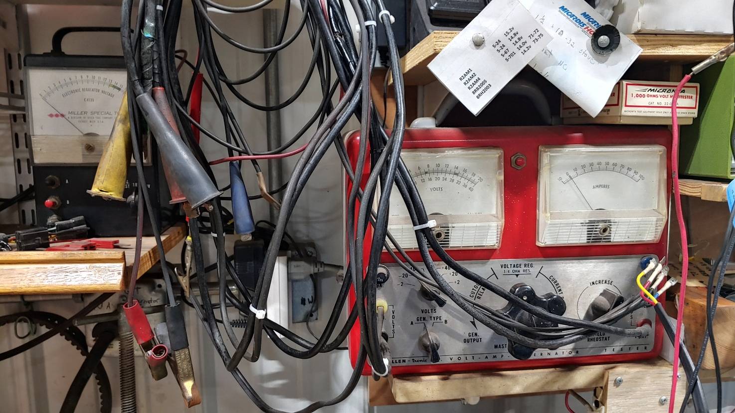

If he wants a simple place to start, he can buy the "classic" versions pretty cheaply and readily on eBay.
I've had mine for decades (and you can tell.........)
I also have the testing procedures as laid out by GM and others as I went to GM and Ford and Chrysler classes in the 70s and 80s and still, to this day, have the handouts. A lot was review from my college days but who can't use a refresher now and then? Or even to get newer or updated info (GM kept changing their batteries and alternator regulated voltages, it was hard to keep up - almost as bad as Microsoft updates LOL)

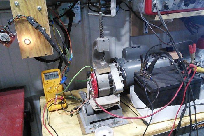

You can even load test alternators - even "smart" ones if you rig them with a 1970s MOPAR electronic voltage regulator.
In this case, I'm checking out a voltage regulator I designed and put into a PC board as a replacement for AMC Motorola regulators.

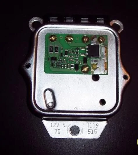

Nice! With the old GM Delco external voltage regulators, you can just pirate the PC board from a new solid state regulator and swap it in. Here is my Camaro's original factory-installed VR with new 'guts'.
Great idea - and could be applied to some other systems as well. All one has to do is make sure you match field types - A or B
(for onlookers, I'd bet lunch Jeff knows this since he's done a conversion) -
Motorola is type B - one side of the field is always grounded and the regulator controls power to the other side.
A is where one side always has power and the regulator controls it by grounding the other side of the field.
