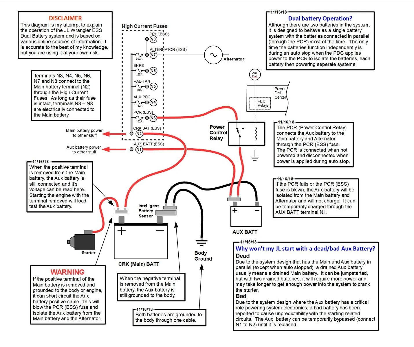

I had this same problem with my Wrangler JLU. The dealership "tried" to fix it 3 different times by replacing the aux battery to no effect. After much research, I found a post on the wranglerjl forums where someone mentioned the Power Distribution Block on there's was loose. Had the dealership check the block on mine and some connections were loose. After tightening, I never had the issue again. I did read that some people had the block replaced. I hope this helps!

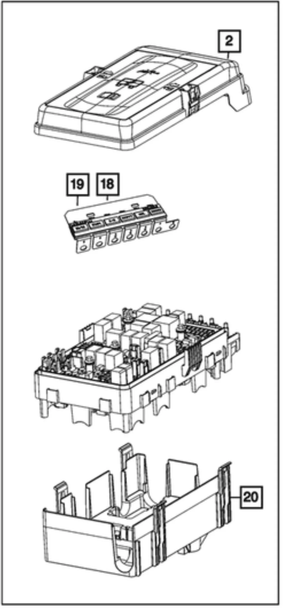

Is the PDB the fuse box?
It is not. The entire assembly shown in the image below is the Power Distribution Center, which includes the block and fuse box. The PDB is called out as "18 & 19" on the image. I am not 100% sure but I think the block is located
below the fuse box. I found this image on a mopar parts site.
