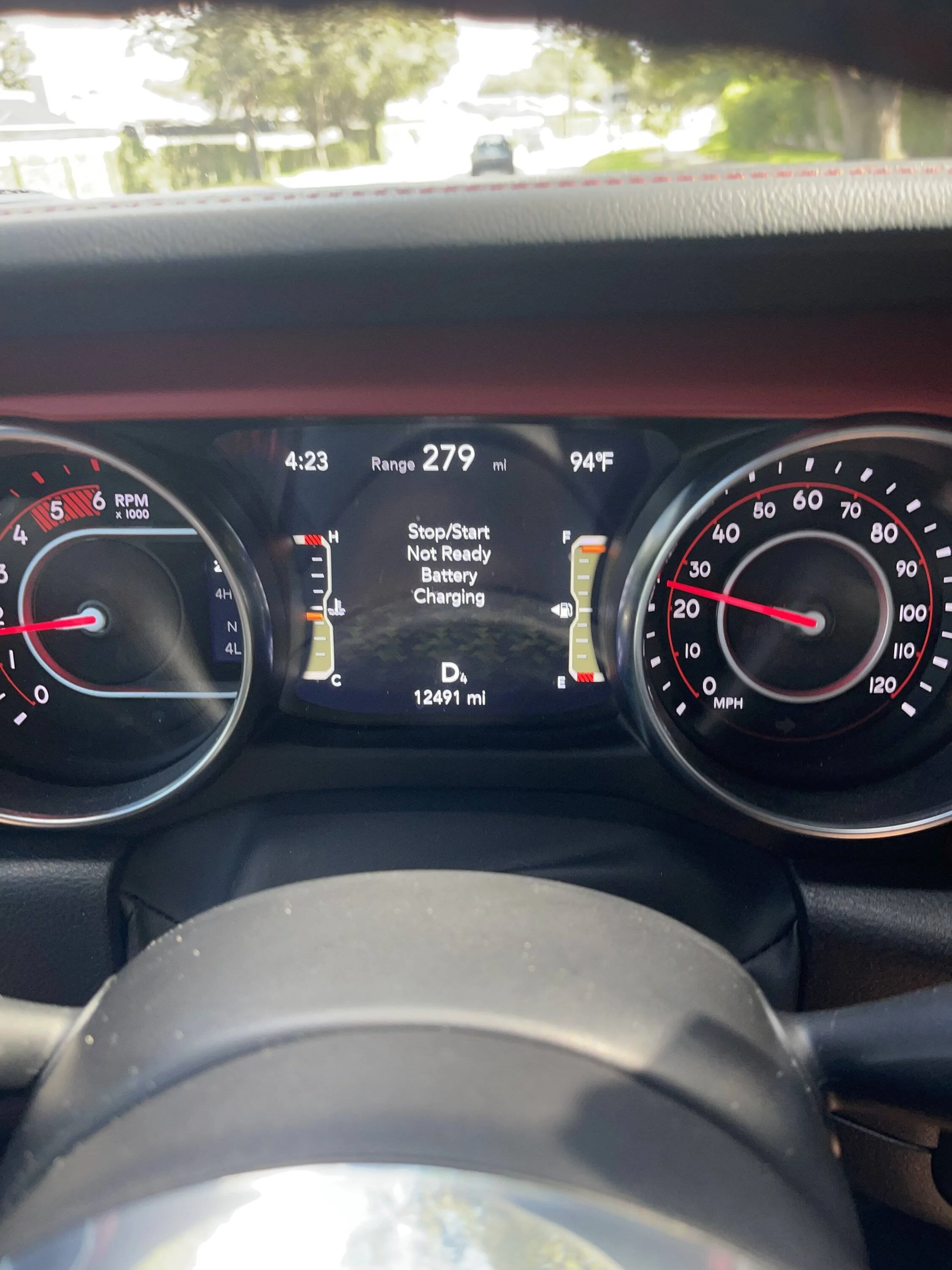

Bought a 22 Rubicon a month or so ago from a Ford dealer who took it in on trade for a Bronco Raptor. I keep reading abut people hating the engine cutting off at red lights and using the Tazer or devices to disable or turn off manually.
Mine has never turned off ever. Attached is the message on the screen. I have not done anything to the batteries and wondering if maybe the former owner bypassed the Aux batter? Or maybe there is a tazer module hidden in there and he never told the dealer.
Any ideas what would make this message appear? Everything functions normally and no error codes.

Mine ending up being the battery. Do you think yours has a Tazer installed? Look under the driver dash. I put one in mine after I had the issue so I could update my tire sizes (and permanently turn off the start stop as I have a diesel and do not want the engine starting and stopping).
