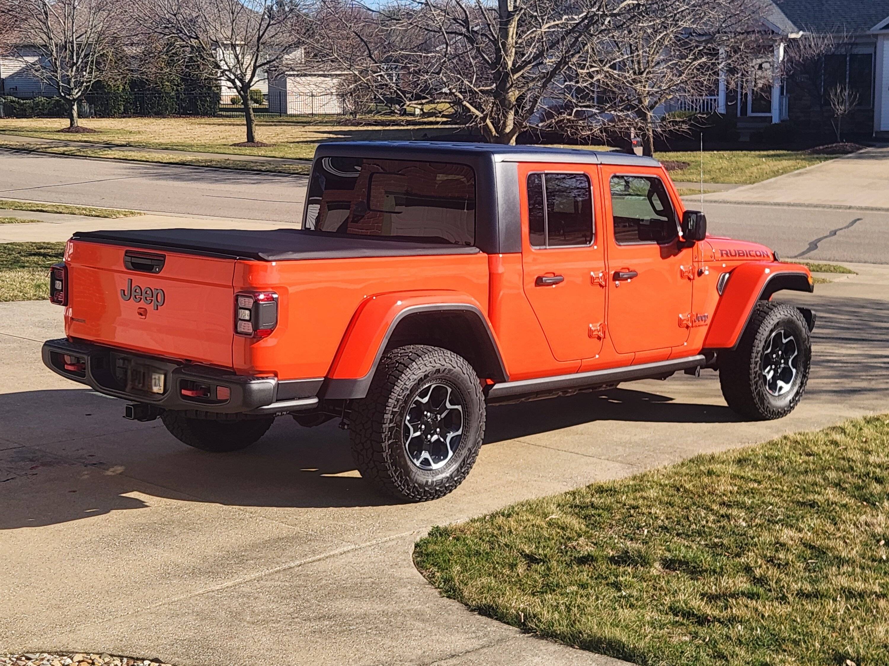

Thanks for everyone's input but I found an easier fix, sure not the cheapest but it works great now....just traded in my Nacho Willys for a fully loaded Punk'n Rubicon that my local dealer had at over $18k off. Everything works great now ???
