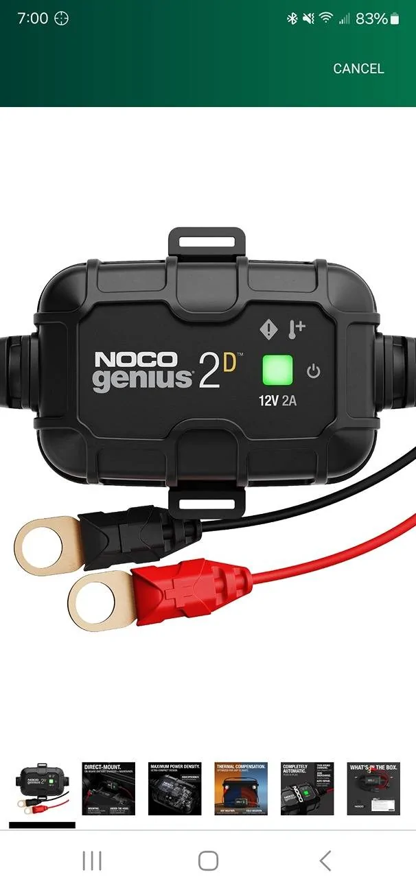

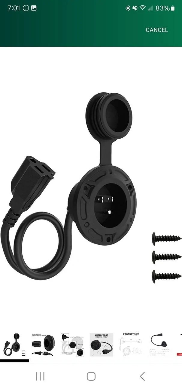

I don't mind using tools, I do have a battery charger the battery tender plus, i can use that. Thank you for your advice. Also, any good battery brands to get if replacement is needed for both main battery and aux battery?
Hello, thanks for your response.
Yes, that's the annoying part not knowing what they actually did at the dealer but still charging me for it each time!
Jeep Gladiator Stop/Start Battery Issue Screenshot_20241206_190124_Amazon Shopping
Jeep Gladiator Stop/Start Battery Issue Screenshot_20241206_190027_Amazon Shopping
I have the charger and 120vac adapter on several vehicles. No issues at all.
I use Interstate batteries when I need a replacement. I will probably go with Interstate for the JT when that time comes.

So, do you have the charger attached to the main battery? And if so, it doesn't cause any issues with the battery mounted underneath? I have had both batteries replaced 5 times now, with only 18k miles, all under warranty, but really! there must be a draw somewhere. Anyway, maybe something like this would help me keep the batteries charged. Thanks. What is the 120vac adapter used for? Thanks.
I have the NOCO installed next to the main. It plugs into the adapter making it easy to plug in, like an EV. I plug it in every few weeks or when I leave it parked for more than a week.
