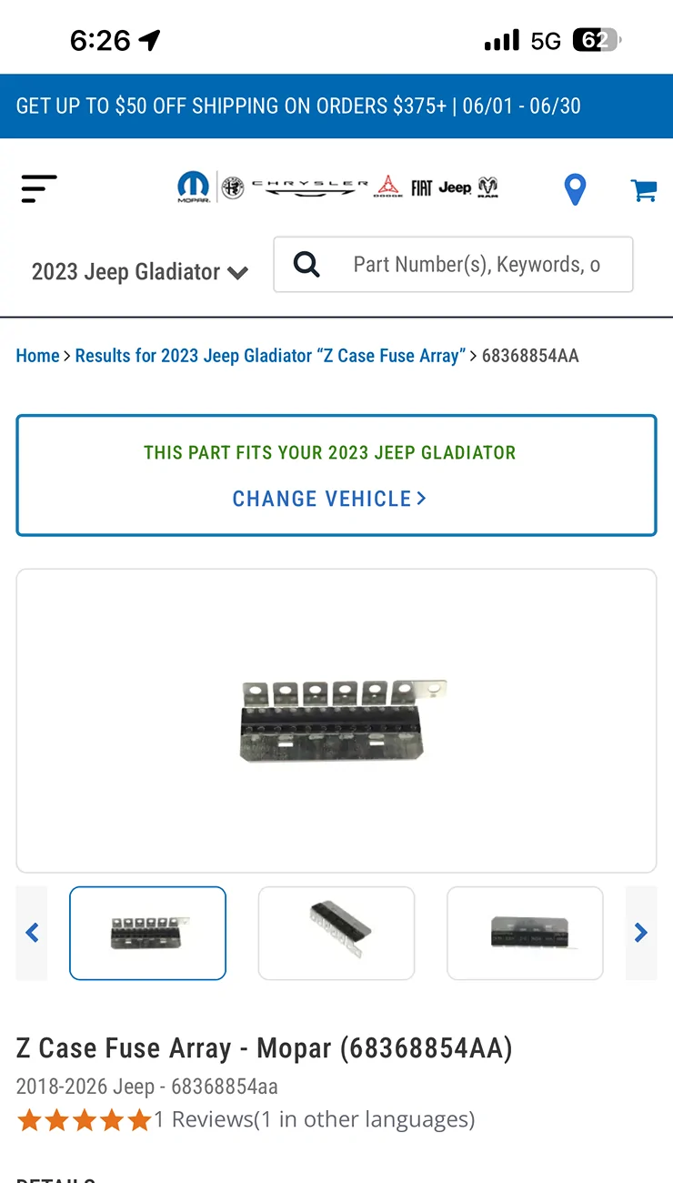

Hi Guys I got my Mojave 2023 and I got the same issues related to the batteries, the dealer already changed both batteries the auxiliary first and a couple of weeks the main but still the problem remains, anyone for here know what the root cause really is?

Hi Bill,
Here is the short version of my issue:
2023 Jeep Gladiator Mojave (3.6L).
  1. The first electrical-related repair was the replacement of the front auxiliary ESS battery under warranty in December 2025.
  2. A few months later I started noticing ESS-related symptoms:
    • Auto Start/Stop became inconsistent.
    • The engine sometimes struggled to restart after an ESS stop at traffic lights.
    • ESS availability gradually decreased.
  3. Then I started getting the message:
    "Aux Switches Temporarily Unavailable – Battery Charging."
  4. Shortly after that, I experienced a complete no-crank condition:
    • Dash powered up normally.
    • Accessories worked.
    • Engine would not crank at all.
  5. I used a NOCO GB150 jump starter and the vehicle started immediately.
  6. The dealer diagnosed the main battery as failed:
    • State of Health (SOH): 49%
    • Voltage: 10.44V
    • Multiple low-voltage DTCs were stored.
  7. The vehicle was then kept at the dealer for an extended diagnosis. So far they have:
    • Replaced the main battery.
    • Replaced the starter motor (or starter assembly).
    • Replaced the Power Distribution Center (PDC / fuse box).
  8. Before the no-crank event I had already experienced:
    • ESS becoming less available over time.
    • Slow or hesitant restarts after ESS stops.
    • Battery charging messages.
Based on NHTSA documents, Jeep forums, and the symptoms, my current suspicion is that the issue started somewhere within the dual-battery ESS system (aux battery, PCR relay, IBS sensor, battery management strategy, or a combination of those components).
The truck is still at the dealer, so I am waiting for the final repair order and root-cause determination from the dealer.
"Has anyone experienced a similar sequence where the aux battery was already replaced, then the main battery also failed and replaced, followed by a starter and PDC replacement? If so, what ended up being the actual root cause?"
Thanks a lot!

Now they are saying this is the component involved:
what’s your opinion guys?
