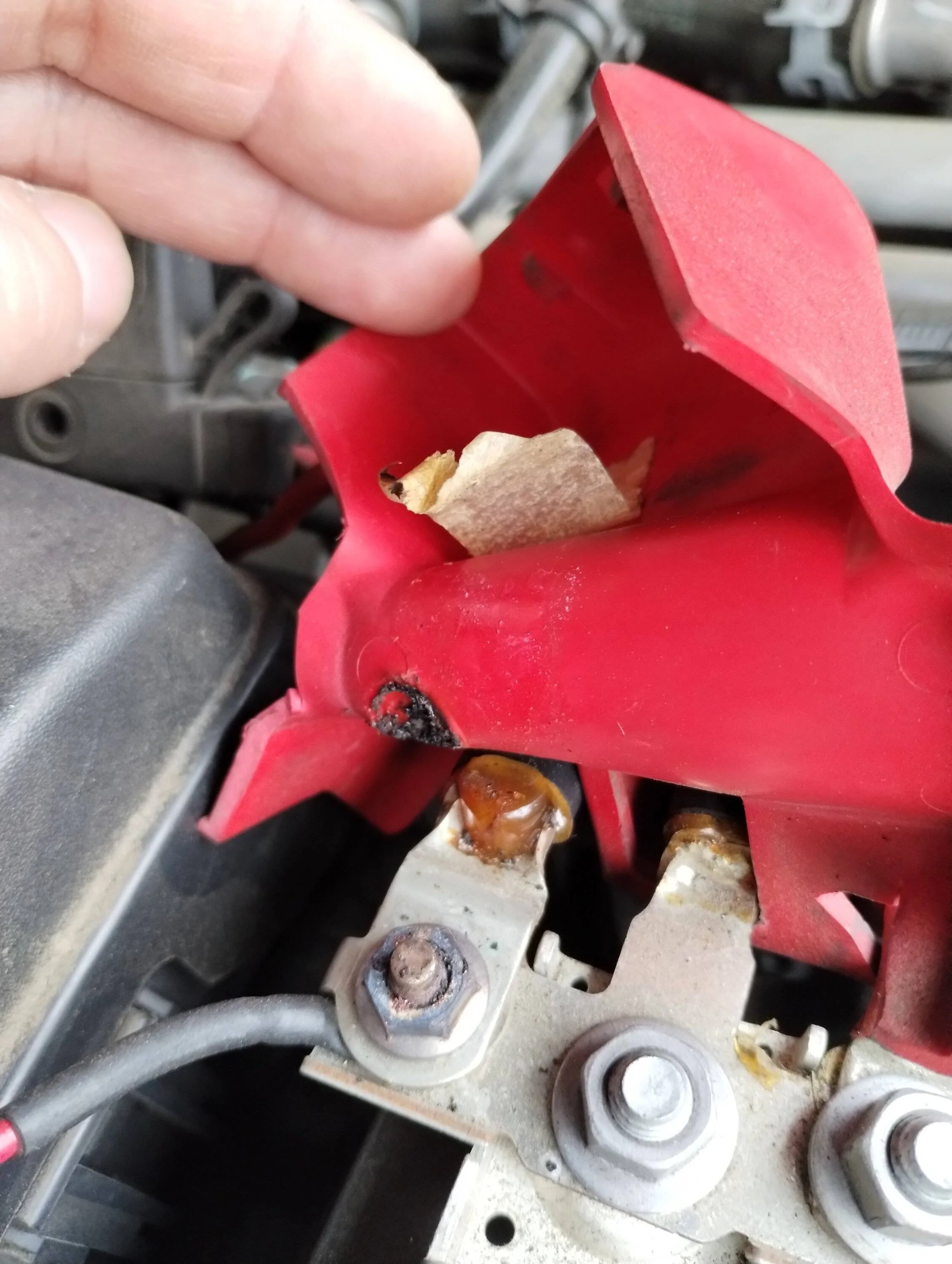

About four months ago I had to replace the aux battery after I started getting a message saying that the aux switches were disabled due to battery charging. The dealer said the aux battery was bad. SInce then I've had no issues, until about two weeks ago. Two weeks ago my ESS stopped working and a couple of times the aux switces have been disabled. Two days ago I monitored the battery voltage for about 15 minutes and the voltage, while idling, would fluctuate from around 13.0 to 15.7 volts, at the same time the engine was idling in tune with the battery fluctuation. I opened the hood and found an orangish/amber colored substance on the end of the power wire at the terminal and a burned spot in the red batteyr terminal cover.
Any ideas on what may be happening to my truck? I'm worried it may catch on fire if I drive it, but it's my daily driver.
Jeep Gladiator Start Stop Not Ready - nothing else IMG_20221222_090002820
249
40,542
54,177
15.7 volts? Yikes.
BTW - obvious (to me, anyway) that wire's been hot. That's what you are seeing. Look at the red rubber cover.
Where does that small red wire go - the one in the lower left?
Possible loose connection there, causing the heat. The fluctuation is not normal - get it in and checked out before you do have a fire.
My first thoughts - that nut isn't tight, causing resistance and heat.
That terminal has been crazy hot.
Did you add that wire or is it factory - I can't recall mine having that but I've not totally taken the positive side of this one apart yet.
15.7 volts is crazy high and the fluctuation in the engine idle RPM is likely due to the loading and unloading of the alternator - 15.7 volt output will really load an engine down.

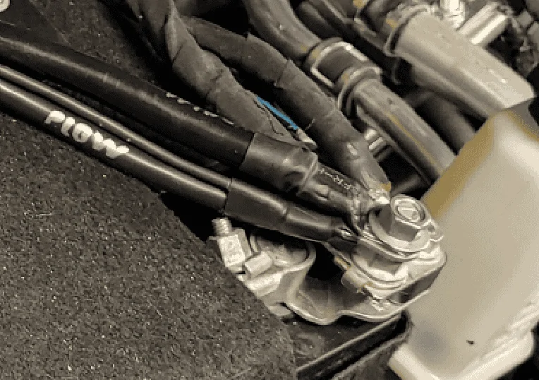

I would probably replace that cable. At least clean the terminal. The add-on wire should be on top, not underneath.
249
40,542
54,177
Very true. An added wire should be on top of the others.
In fact, I do it by placing the added wire on top of the existing nut and then putting a nut on to secure my added cable. This way I can remove that at any time and never disturb the original connection. I don't want to remove my wires and have the truck's systems see any interruption.
I can disconnect any accessory and never interrupt power from batteries to truck.

Looks like the heat shrink may extend too far on the added connector - impacting the integrity of the connection under the existing connector as mentioned by others.
I'll check it...that wire was installed by a dealership full of retards so I'm sure they screwed it up

You're clamped down on the insulation of this wire, causing a bad connection that is heating things up, including remelting the heat shrink on the battery cables causing the orange substance.
249
40,542
54,177
And it takes some fair heat to melt that glue/sealer in heat shrink. My heat gun on high will do it, on the next setting down, it barely does it. That means it was really hot. The corroded nut and melted cover is all one needs to see.
Put that added wire on TOP of the others. Make sure the nut doesn't pinch any insulation but is only on the METAL of the wire's end.

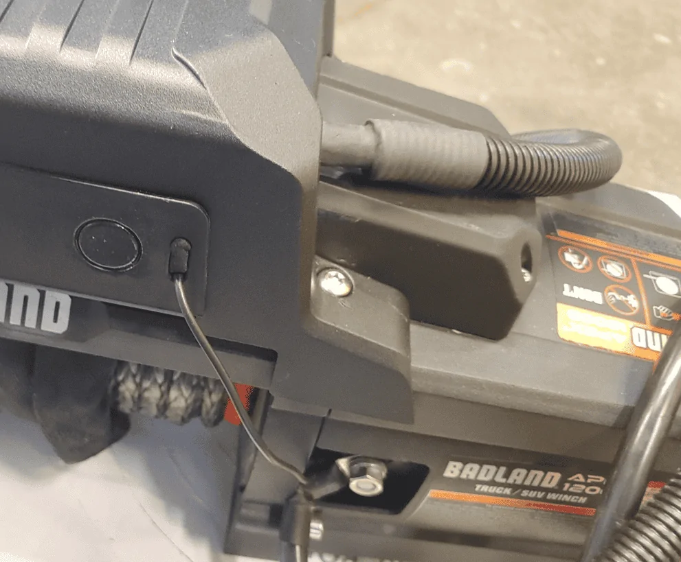

LOL - not "PC" but I get it. I can relate - the closest dealership to me said my winch was draining the batteries while it was sitting. Uh, BIG RED SWITCH next to the battery - anyone here knows what a switch does?
Their solution? Move the winch GROUND cable from the top of the IBS (where I have it - in the picture above) over to the fender ground stud. And guess where that black cable from the battery goes? Yeah, over to the fender ground stud. Geesh. Besides, even if they had taken the ground cable completely off, the winch body is grounded to the FRAME of the truck!
Yeah, I can relate.
I about flipped when the service writer told me that the winch was draining batteries and then I saw how they had "fixed it". LOL - yeah, let's ignore the big red cut-off switch there and ignore the fact that winch is grounded, cable or not.
Gee, let's look at where that big black winch ground cable goes to ->
