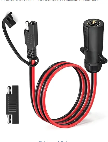

I have a battery tender attached full time to my 67 Camaro in the garage. I will pick up another one to use on the Gladiator to at least try and help prolong the battery life. I will probably go with the NOCO or Ctek. The easiest method for maintaining the battery for me is with the trailer plug adapter. Has anyone used this one or something similar they can recommend?
AMAKE 7 Way Trailer Plug to 2 Pin SAE Power Supply,7 Pin Round RV Trailer Plug to 10 AWG SAE Cable 12V Connector with Reverse Adapter for RV Truck Trailers (2Ft)

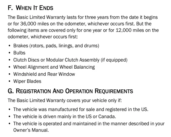

I'm having battery issues in the cold with my Glad, it's manufacture date is 12-2023, I bought it in May '24, and the dealer says there is no battery warranty. You would think it would be at least like a 36 month battery warranty and give a pro rate, but no. Apparently it's common practice in the auto industry to only give 12 months on the original battery or batteries (Aux ESS battery) so it's not just a Chrysler thing. Doesn't that make you want to jump up and buy an OEM from the dealer to replace it?....NO.
I'm letting them do the diagnostic under warranty, then since I'm almost out of warranty (36k miles) I'll do the ESS delete and only change the main battery. Thank you government for requiring these ESS systems....
You may need one with a fuse.My Battery tender came with a 7.5 amp fuse in line to the battery.
Thanks for the info. I will look for one with a fuse.
https://www.midtronics.com/blog/how-to-explain-battery-warranties-and-pro-rated-coverage/
The dealer you were talking to is misinformed. The factory batteries are covered under the 36mo/36k mile basic warranty. Only the items specifically noted in the exceptions list fall under the shortened 12mo/12k mile warranty. See your warranty booklet HERE.
I also have a 2023 and they have replaced my batteries twice under warranty. Didn't pay a penny and it's not the dealer I purchased the truck from. Interesting that yours is being difficult. May want to go to another dealer if you have that option.
