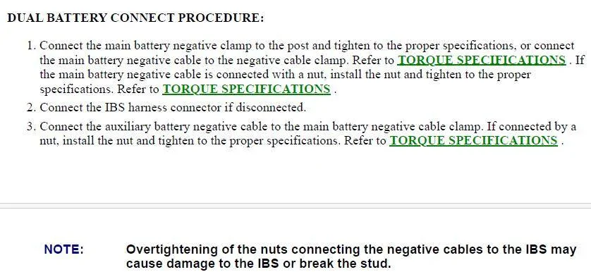

1. Question is - sequence to re-connect everything?
Below is the procedure from the FSM that applies after disconnecting/isolating both battery negative cables. So, the procedure below starts with both positive battery cables connected.

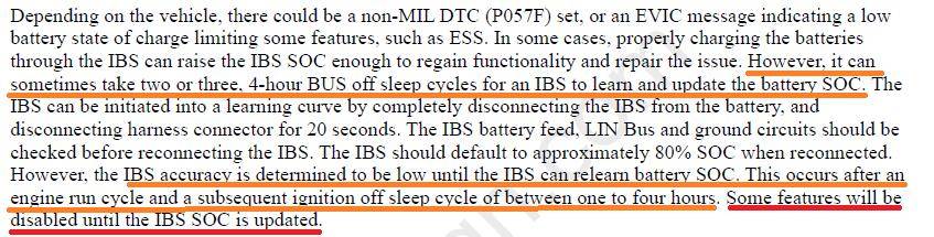

The IBS needs to re-learn the battery SOC. This can take some 'cycles' and things like the ESS may not work until it upates.
Again, from the FSM:
Jeep Gladiator 2021 Jeep Gladiator - Start / Stop - Replace Both Batteries - Sequence ? 1734813977355-f
