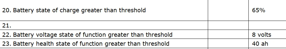

Electronics are electronics. Upgrade to handle lower voltage?
The aux handles more than the PCM.
They run everything off aux in an ESS stop event and leave the crank battery for cranking. They don't want the electrics of the system taking the crank battery down low enough it won't crank and start the engine again (although it takes very little for an ESS start on these)
They monitor the aux battery and restart the engine when it gets too low.
You don't want to be trying to crank it for a restart if the crank battery gets as low as the aux battery can get...........
Jeep Gladiator Both Batteries Dead 2020 Gladiator $898 to replace!?!??? 1655309815781
