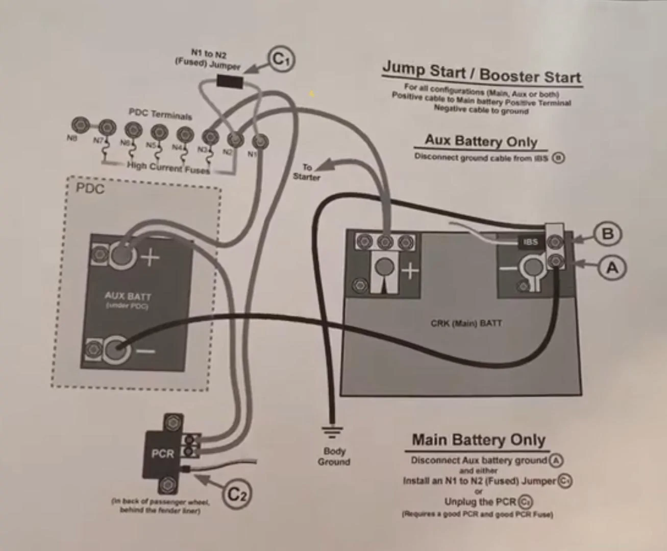

How are you separating the batteries to do that?
Jeep Gladiator Both Batteries Dead 2020 Gladiator $898 to replace!?!??? 3043D074-F4F2-412C-A817-6A64BEAD5B5A

Why would it? The dual battery configuration is only for ESS. It has nothing to do with the rest of the electrical system. The PCM is still tracking via the IBS - every mA that goes in, every mA that comes out, and detects SoC and adjusts alternator output accordingly.

Interesting since the batteries are in parallel and charged together. The drain while sitting in the garage pulls from both batteries. They are not independent.
[/QUOTE
I can assure you that if one goes dead the truck will not start. I come from a. Place of experience.

I connected them straight to the terminals
So you’re receiving different report data for each battery while they are connected to each other? Curious, have you tried comparing that data to when the batteries are completely disco’d from the system and each other?

You cannot measure individual battery voltages when wired in parallel. Any measurement will be the levelized of the two.

Yes, makes me curious as to why the reports wouldn’t be almost identical.

Has to be a tolerance spread between the two measuring devices and/or time sampling difference. Each device could also be doing an averaging across time measurement.
