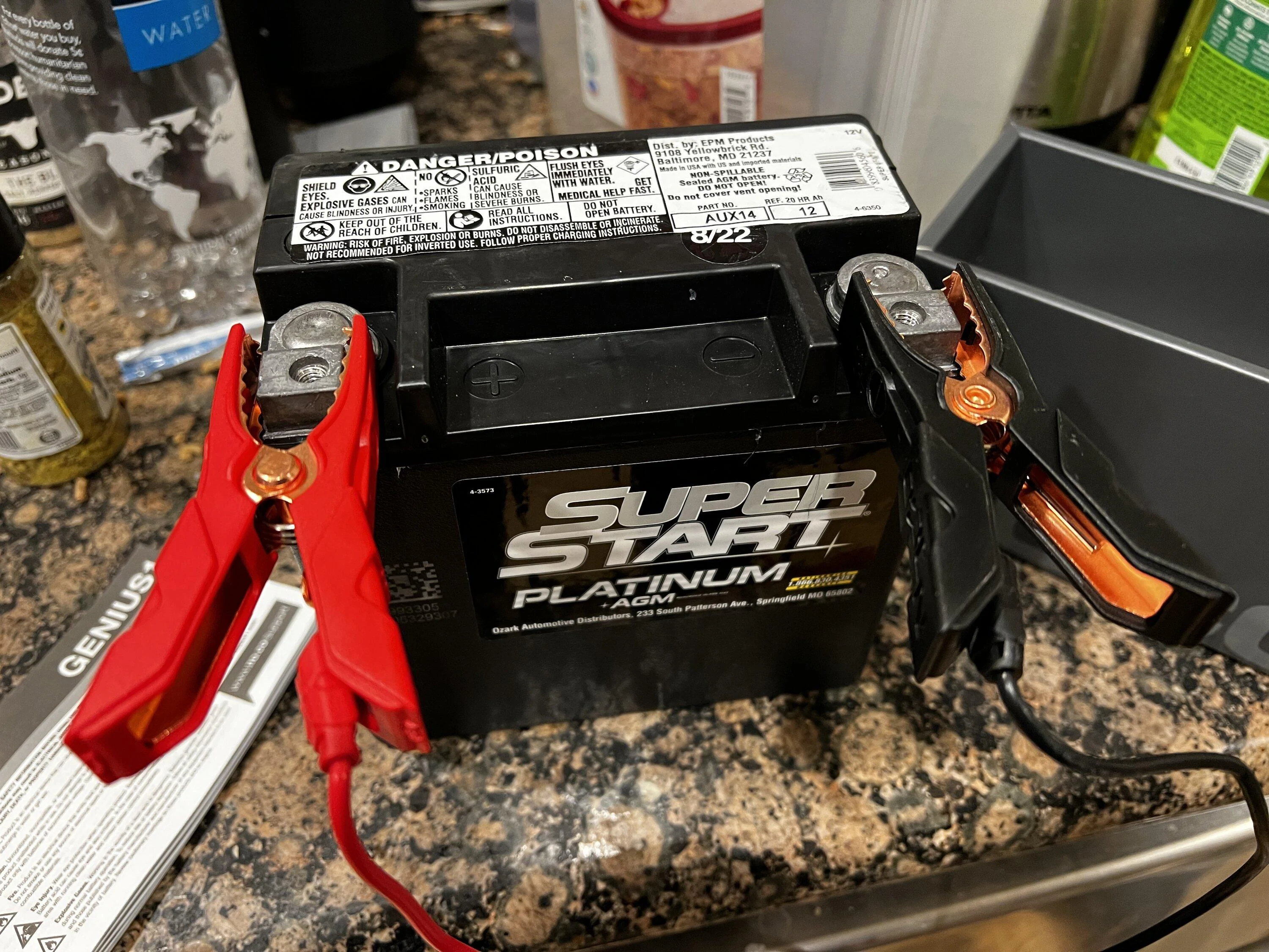

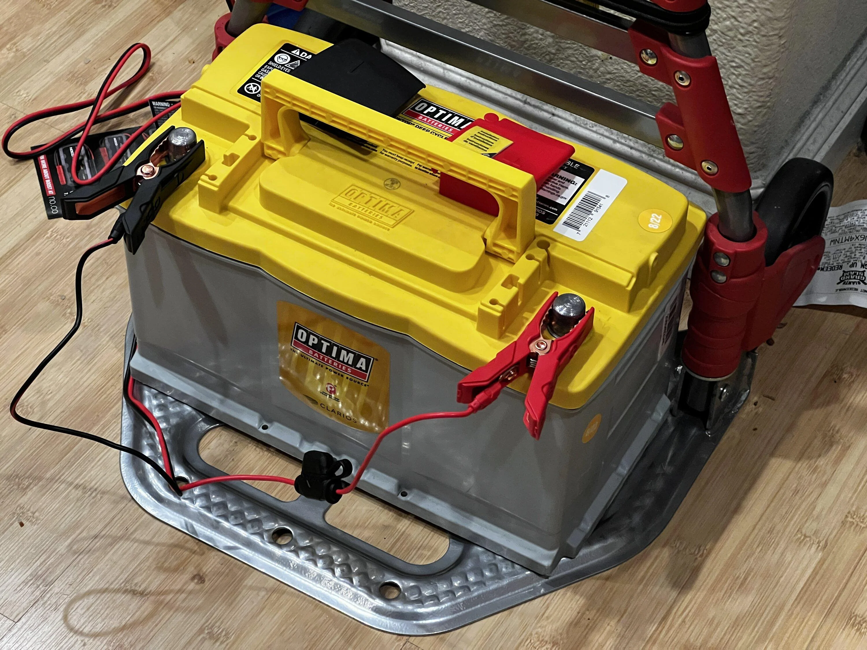

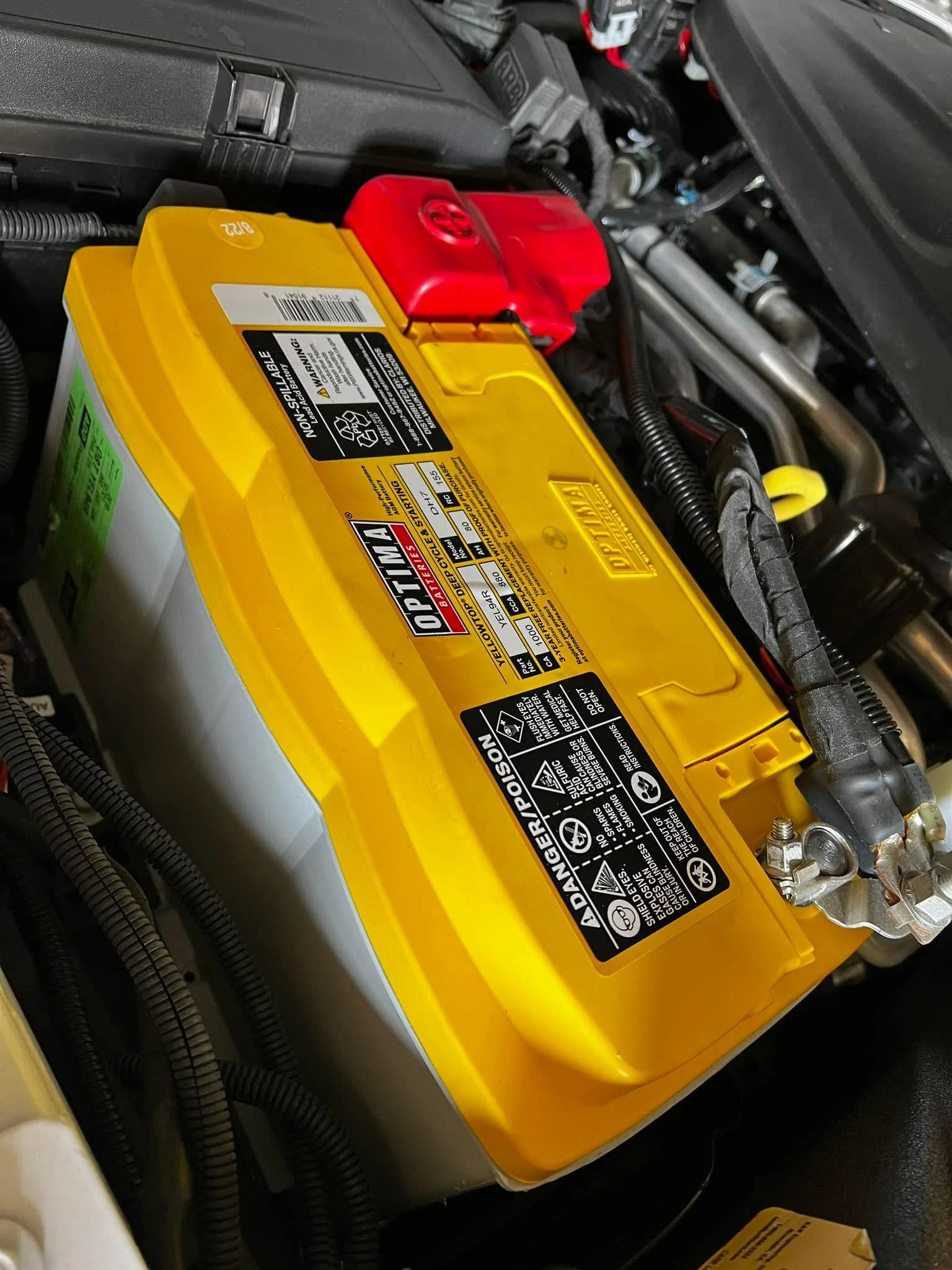

I just swapped out both batteries this morning.
Hardest part was hoisting the new 60lbs YEL94R Yellow Top, THE BIG ONE, over and into its new home. As for the Aux battery, I went with an Orielly's SuperStart Platinum AUX14. I went through the wheel well, so much easier.
Please note that the Optima YEL94R is longer than the OEM battery. So a cleat has to be removed in the battery well for it to fit.

Is the optima taller though? I have my vosswitch controller mounted driver side above the battery with not a whole lot of room underneath and was wondering if the optima's are taller as i'm a fan of the yellow top.
I don't have the numbers in front of me but after dropping the battery in, it didn't look taller.
