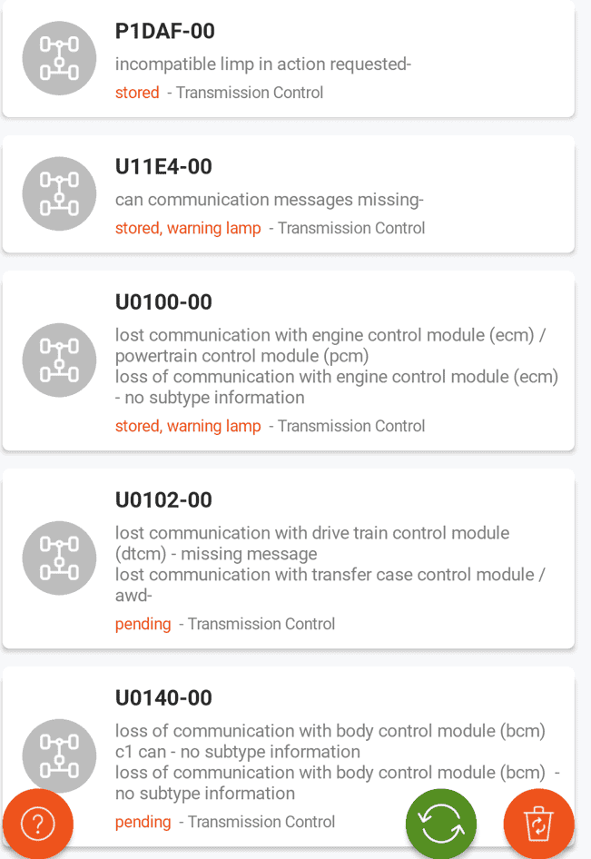

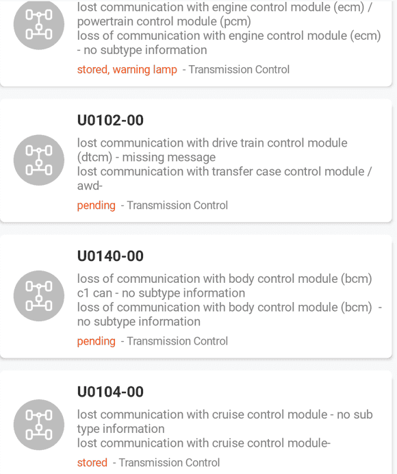

I know that when the CEL (Avengers! Lol) light comes on, everyone's first action is to replace the batteries. Obviously there are a number of things that will initiate a CEL light, but there are a few things that can be quickly checked before you spend $300 - $700 on batteries or $1000+ on a dual battery setup. I made a quick video to show those few things and where they're located. Check it out!
