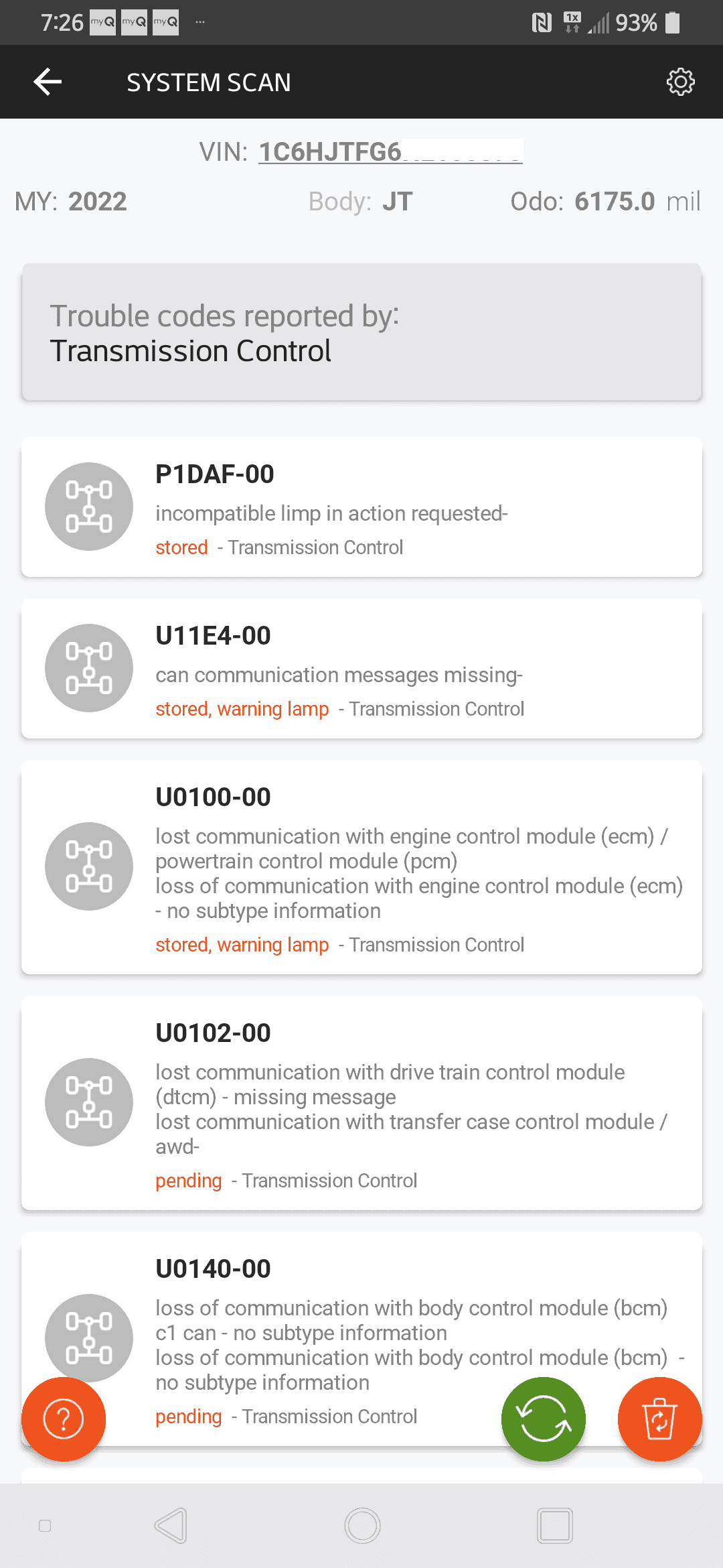

IMO, one thing is to watch for a pattern of messages, not always the message itself, but combinations, orders of the messages. It involves "pattern recognition". Low voltage will trigger certain messages followed by others, while connection issues look different.
I'm still getting used to these because these systems aren't like the networks I'm so used to where there's a handshake, a packet is sent, reception confirmed, error correcting and so on ( there's always UDP, a connectionless protocol)
If there's any sort of a connection issue, you can get weird errors like invalid message, out of order messages and so on.
Communication issues ->
Jeep Gladiator For everyone that has electrical issues, replacing the batteries doesn't have to be the first thing you do. Screenshot_20221108-072659

So much truth to your comment. People don't understand that the error messages give you the answer.
Way back in Sept 2020, my dash lit up like a xmas tree. It would do it at random times. I couldn't find the issue. Then one day I pulled on the battery negative terminal, the entire connector came off. No matter how tight it was it would come right off. I put a screw in it and kept driving. For another 30,000 miles. Haha!!! Finally when the battery actually died, I replaced it and no more Xmas tree dash. The problem was the terminal connector.
Had multiple weird error messages just like you posted. Disconnected, invalid, no data. Just like you said, the pattern.
Battery terminal issue: (Fast forward to 5:26 past my talking)
