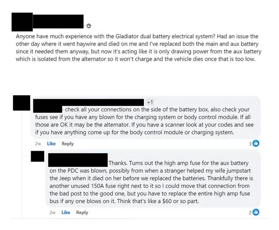

I know that when the CEL (Avengers! Lol) light comes on, everyone's first action is to replace the batteries. Obviously there are a number of things that will initiate a CEL light, but there are a few things that can be quickly checked before you spend $300 - $700 on batteries or $1000+ on a dual battery setup. I made a quick video to show those few things and where they're located. Check it out!

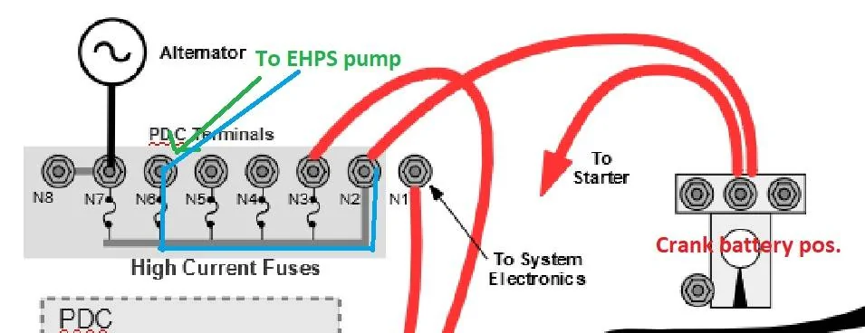

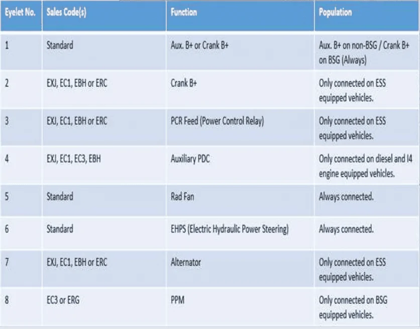

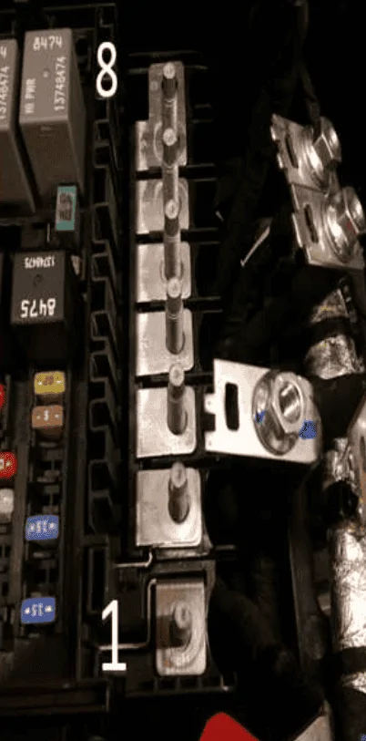

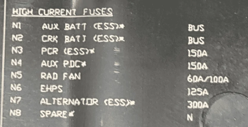

As for moving connections on the Z case fuse ( high amp fuse array), the connectors are "keyed" to the corresponding terminal on the fuse array. This is to prevent using a higher amperage fused circuit for a lower amperage circuit, such as a 150 amp fuse for a 80 amp circuit. I add this just to say use caution in bypassing different terminals on the Z case fuse.
