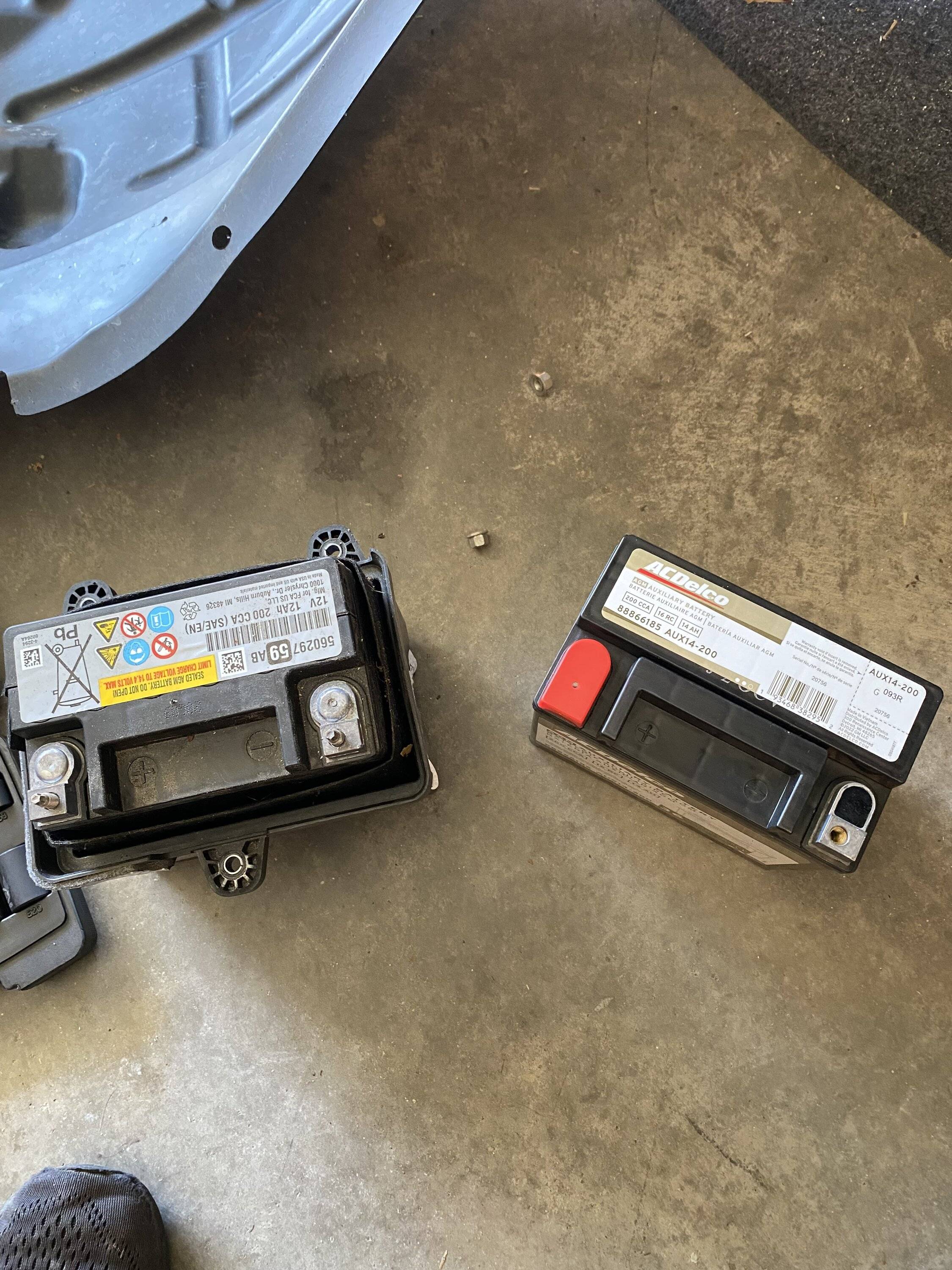

factory main battery failed the autozone test- 2.5 years old. Figured we just didn’t quite get the full 3 years most others get. Replaced both main and auxiliary. (Stuck both on Chargers before installing to ensure we’re full) duralast platinum agms- September and October manufacturers production date.
Few days later voltage in the cab is reading 12.2-12.3 @ start up. Had a long 150 mile drive for the weekend running voltage fluctuated from 13.6-14.4 (normal- I think). Next day again low 12’s
Pulled both batteries put them on a charger… auxiliary battery was basically full/topped off. Main battery read less than 80%… will leave until full, then leave off the charger for a few hours and will check voltage settled amount.
checked the fuse array- all passed continuity, pulled ALL fuses… ?… micro fuses… checked the canbus plugs under/behind the glove box. So far not finding any “ah-ha’s” -
Almost wondering if we picked up a bad main battery?? As it seems we have the opposite problem to most, in that the auxiliary is charging fine in the car, but not the main…?
Anyone have any other troubleshooting ideas or thoughts that they would like to share?

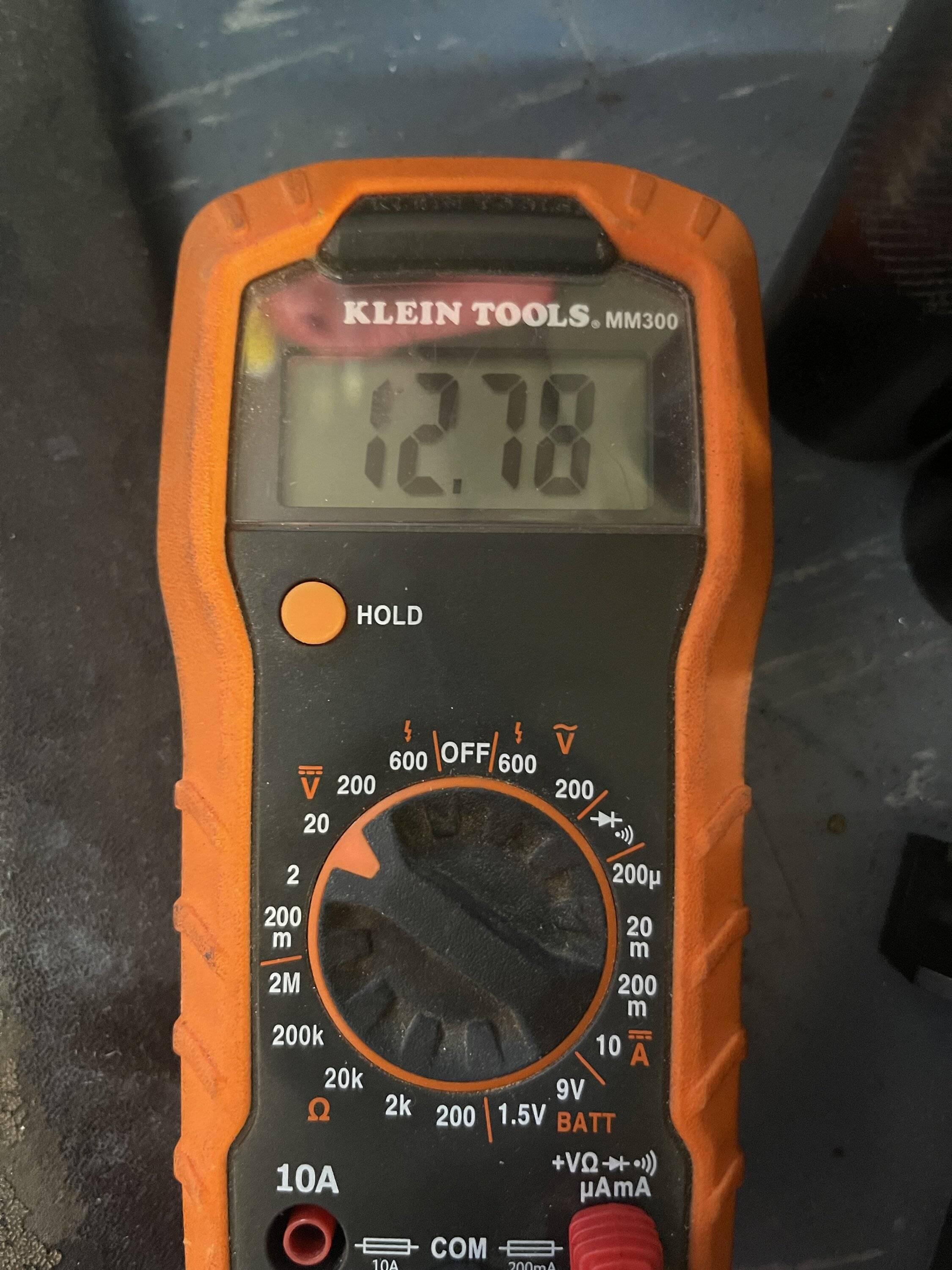

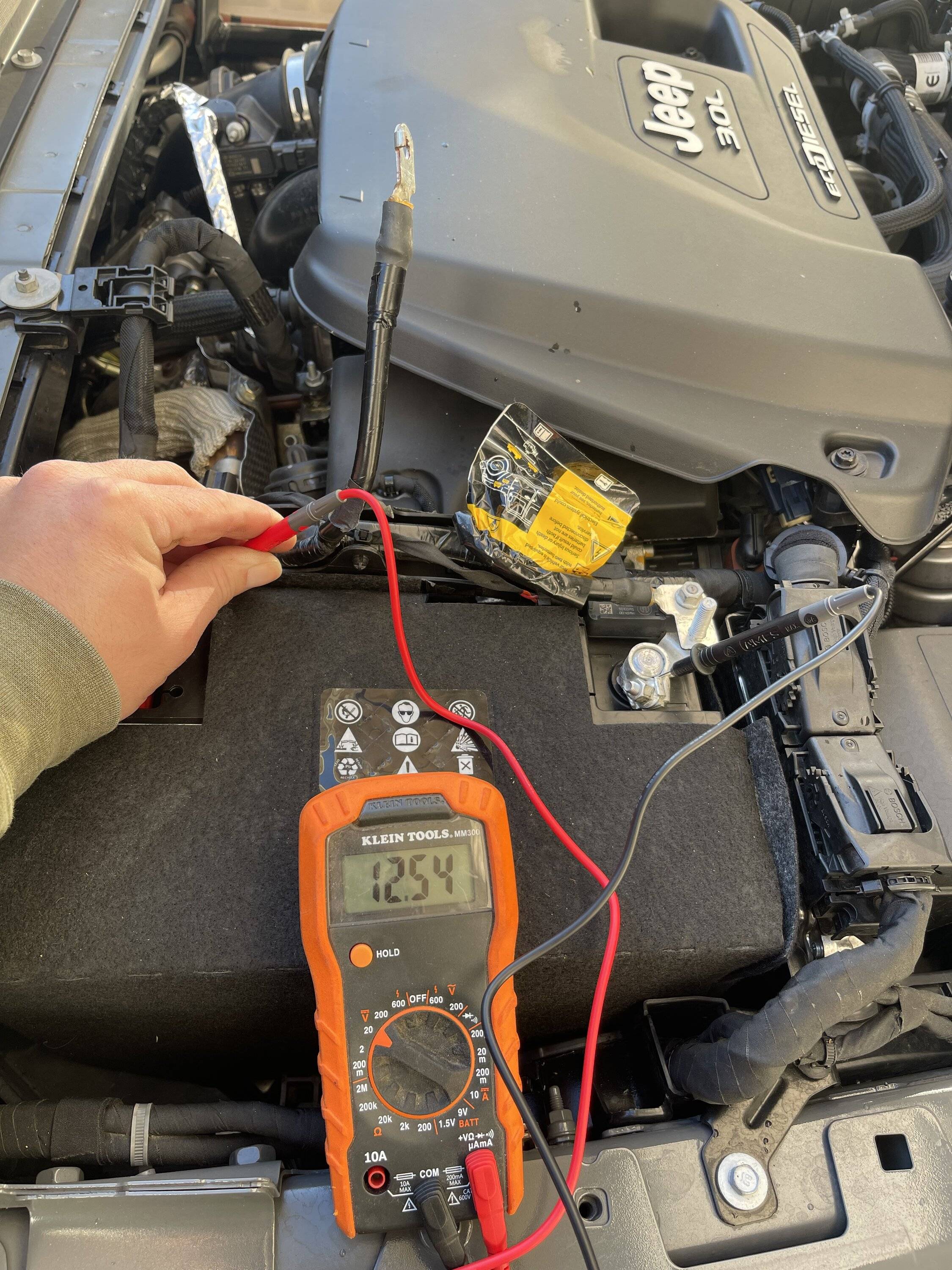

12.78V after sitting 12 hours on the bench. - Going to play with it more today, but if I can’t get anything to shake free I’ll run it for a draw down test and exchange it ??‍♂
Jeep Gladiator On this episode of "Batteries gone bad" IMG_2362

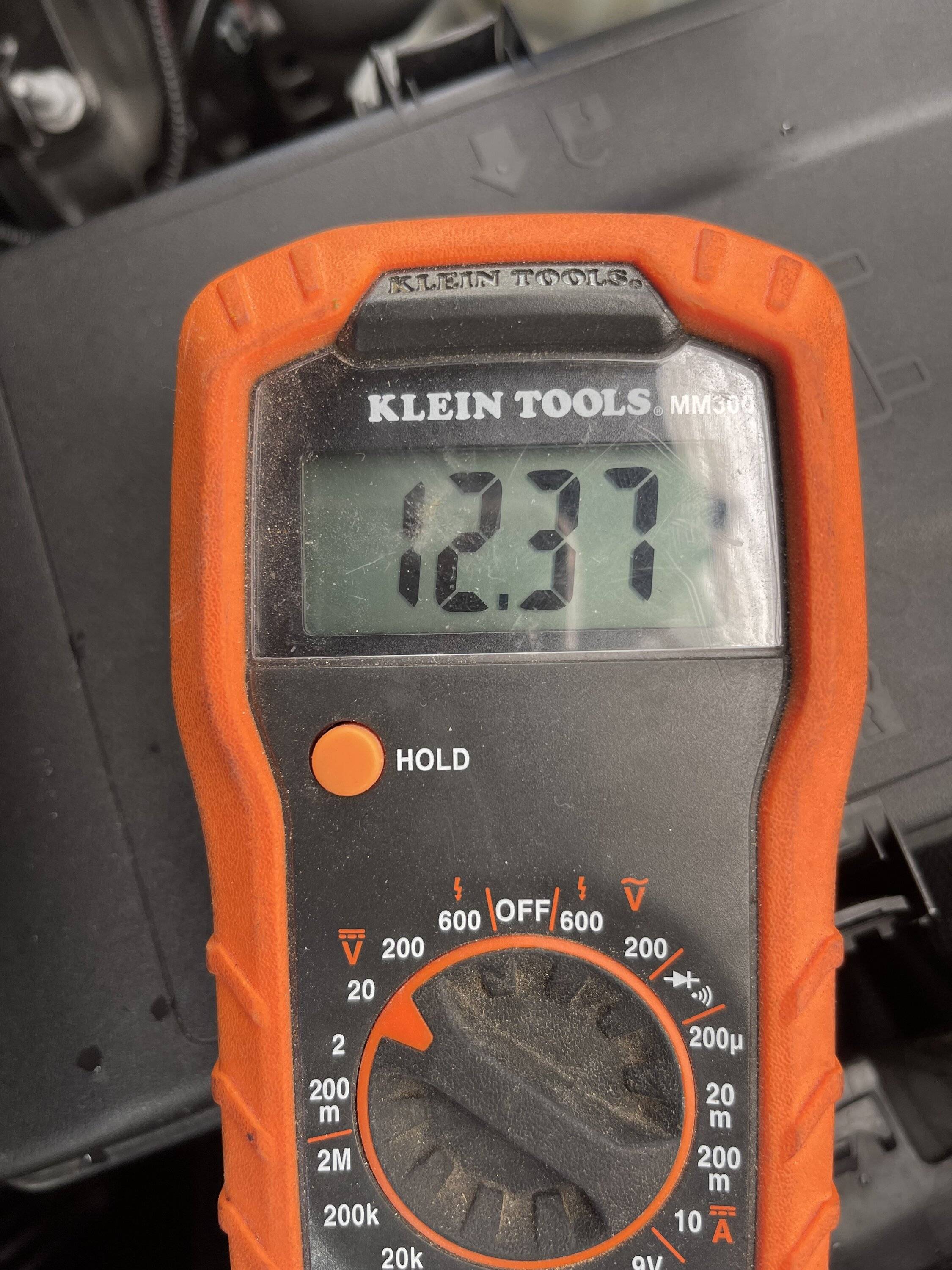

connected in the Jeep- haven’t opened any doors. (20 min after taking bench reading)

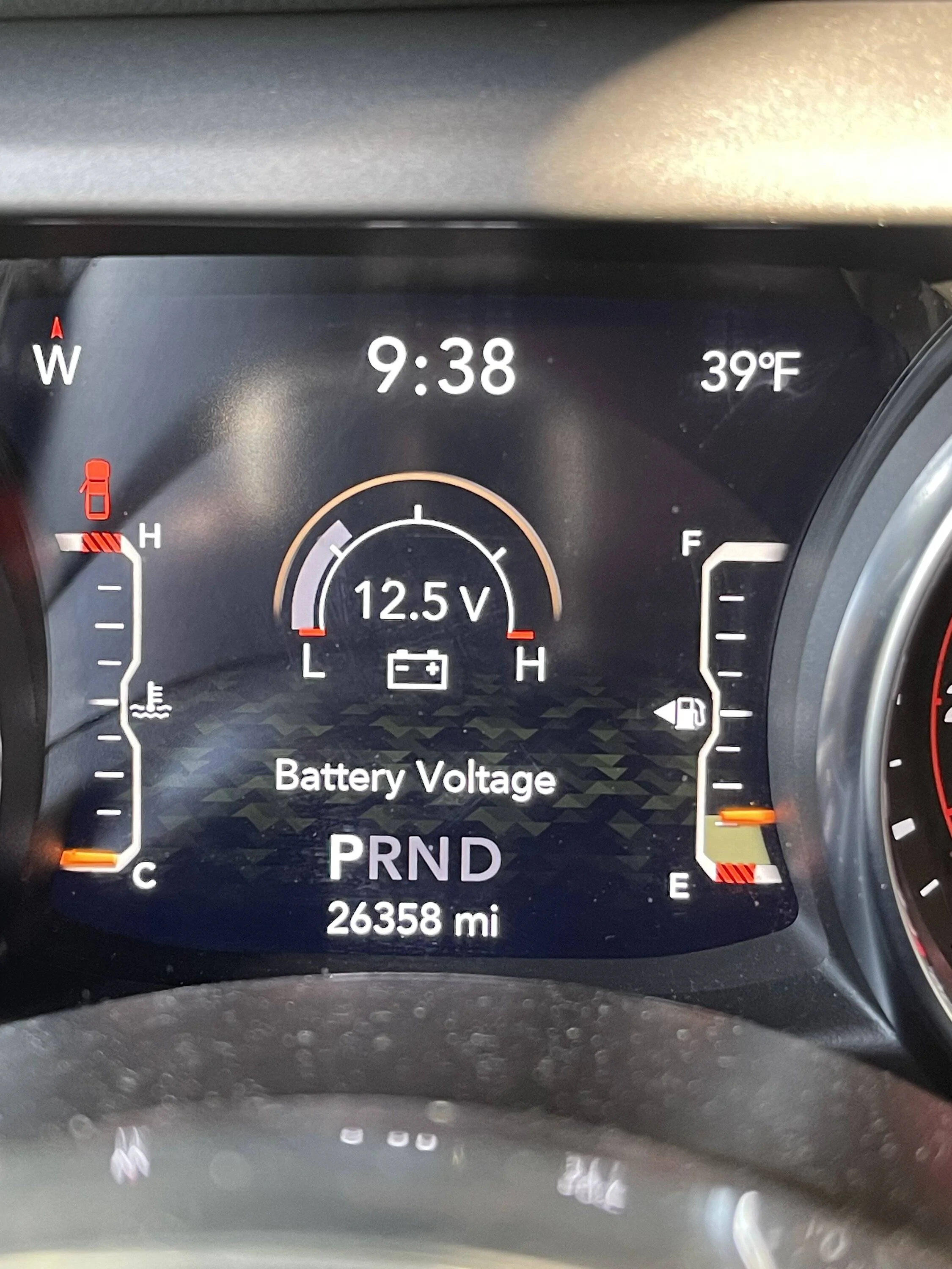

Jeep Gladiator On this episode of "Batteries gone bad" IMG_2367
Reading after shutdown

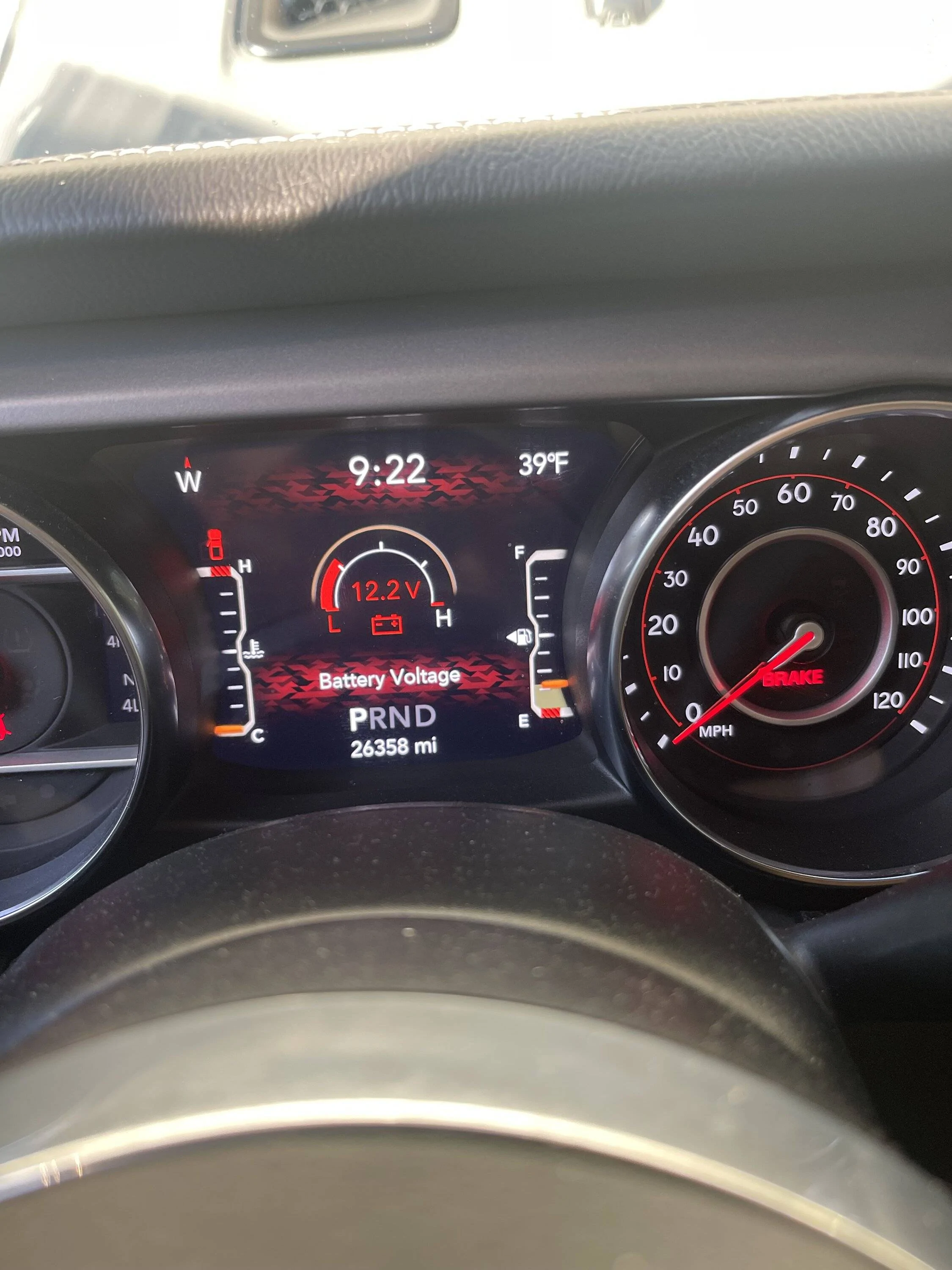

Jeep Gladiator On this episode of "Batteries gone bad" IMG_2368

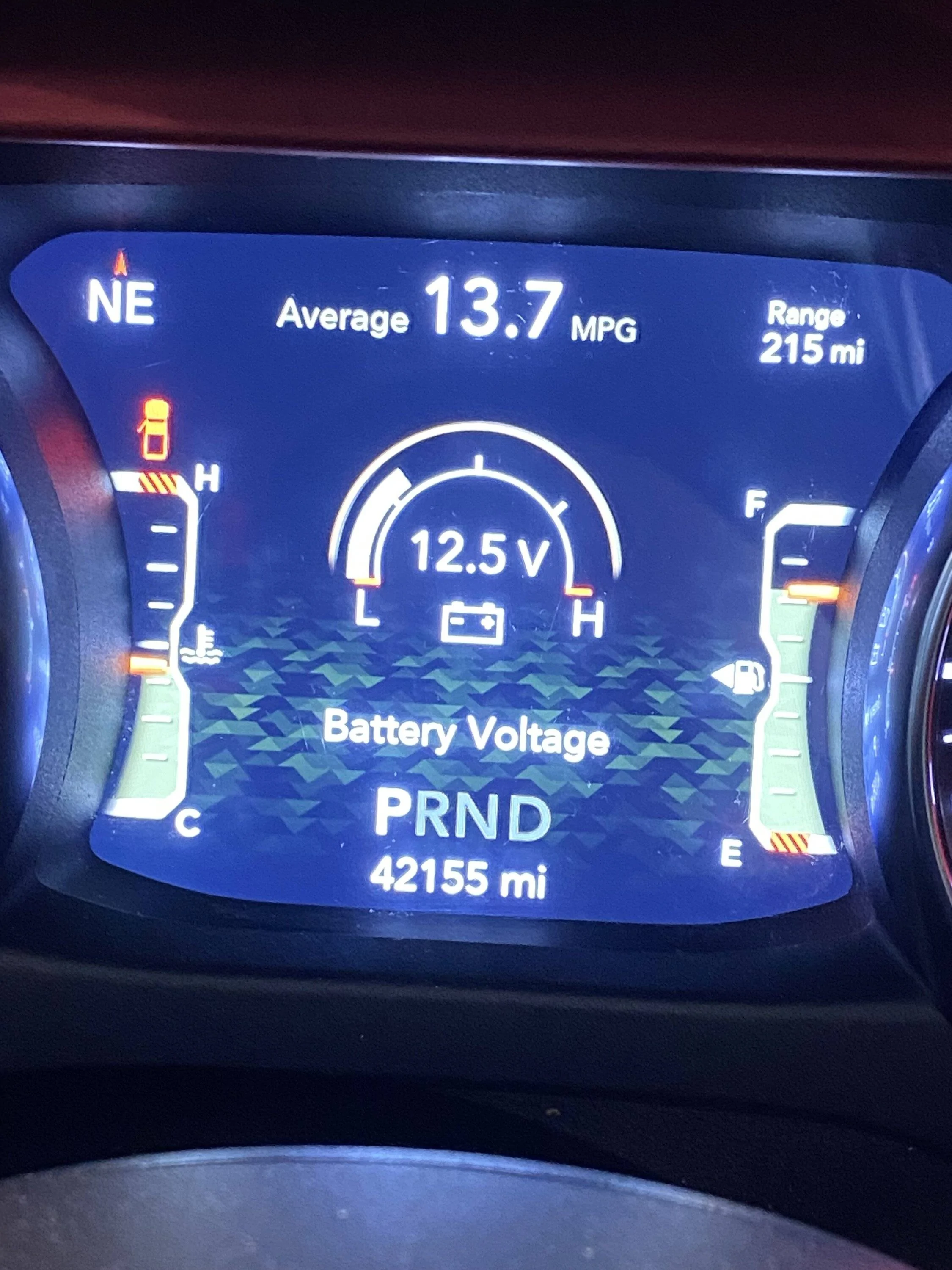

reconnect- vehicle off voltage read 12.2 -started and jumped to 12.5.

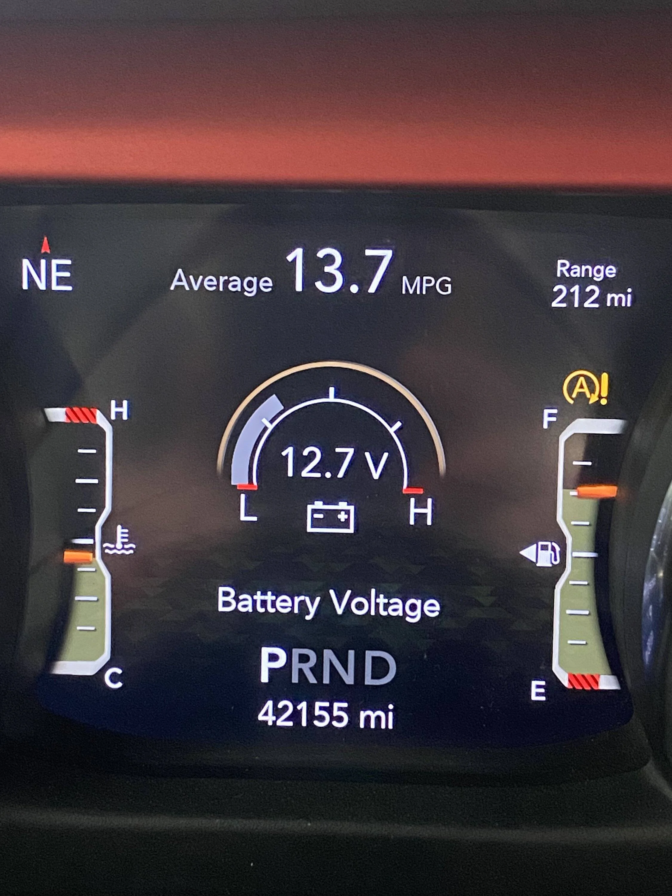

Jeep Gladiator On this episode of "Batteries gone bad" IMG_2369

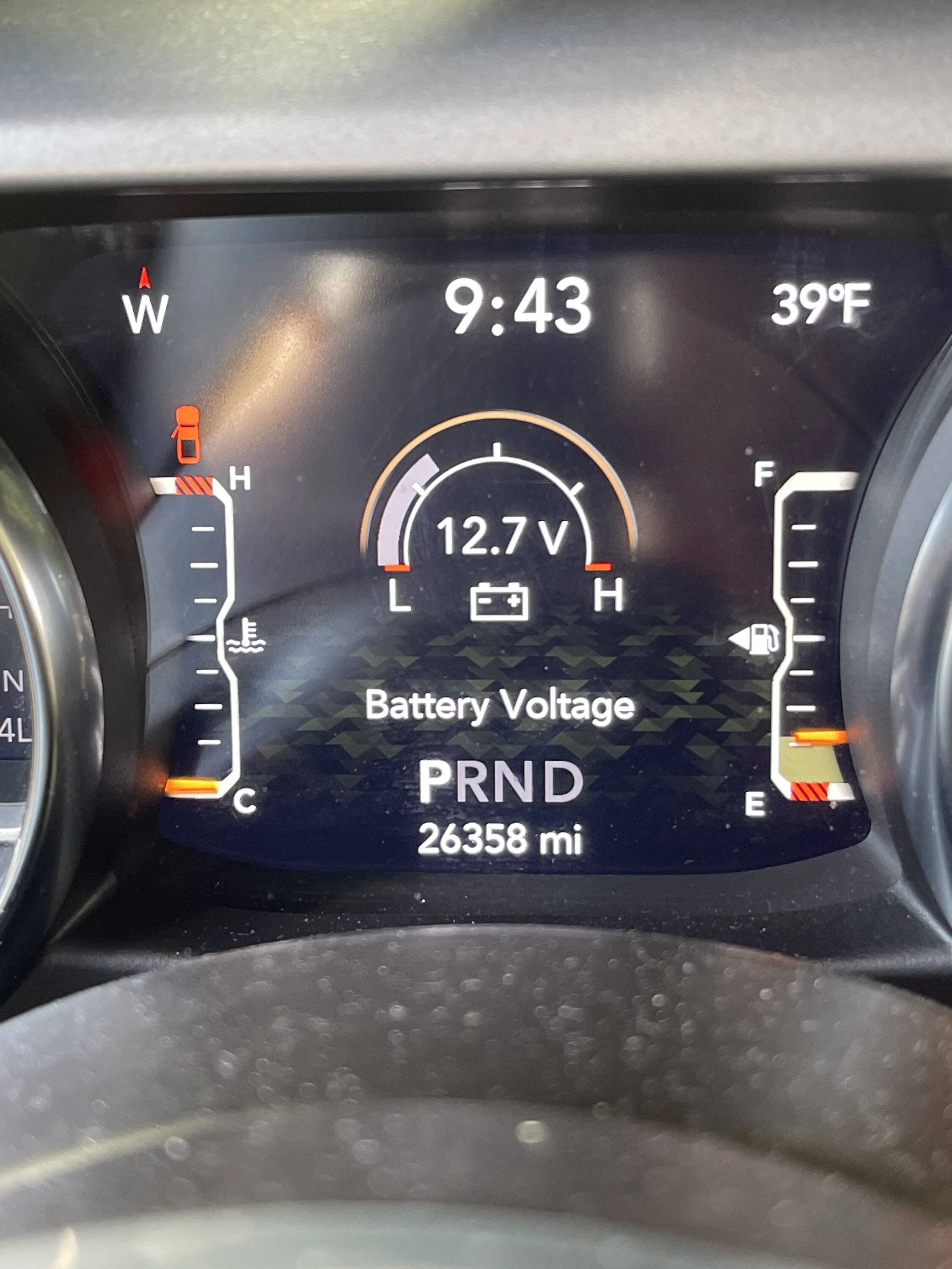

Idling now and voltage is slowly rising…. 12.7

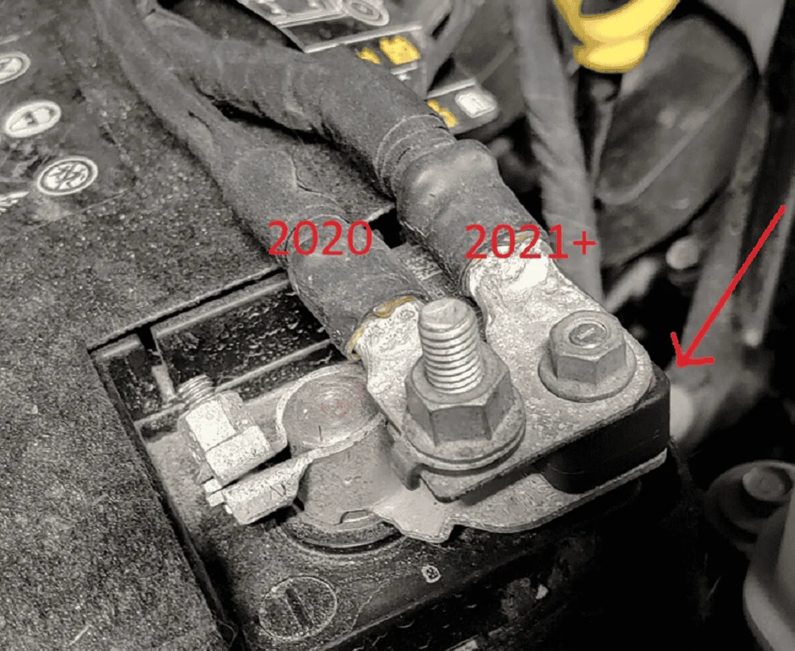

I didn't see or missed it maybe, but do you still have the aux battery in place? If so, it could be pulling the main battery down that badly when you hook things back up.
This may be a case of both having failed.
If you have the aux battery in place, try charging just that one - take the ground cables off the main battery, take the two ground cables apart from each other.
One goes to the chassis ground, the other ground cable goes to the aux battery negative.
Leaving the positive connected on the main battery, but having the negative cables both off the top of the IBS, connect charger to the main battery positive cable and the charger negative to the black cable going down to the aux battery.
For a 2020 Gladiator model year, the cable marked 2020 goes to the aux battery negative and is used to charge it
For a 2021 and later JT, the cable marked 2021+ is the negative for the aux battery.
The arrow points to the IBS - take the right nut off to remove the cable assembly from the top of the IBS, and take the nut off the taller stud to take the two cables apart from each other. Don't let either touch the main battery negative through any of this.
