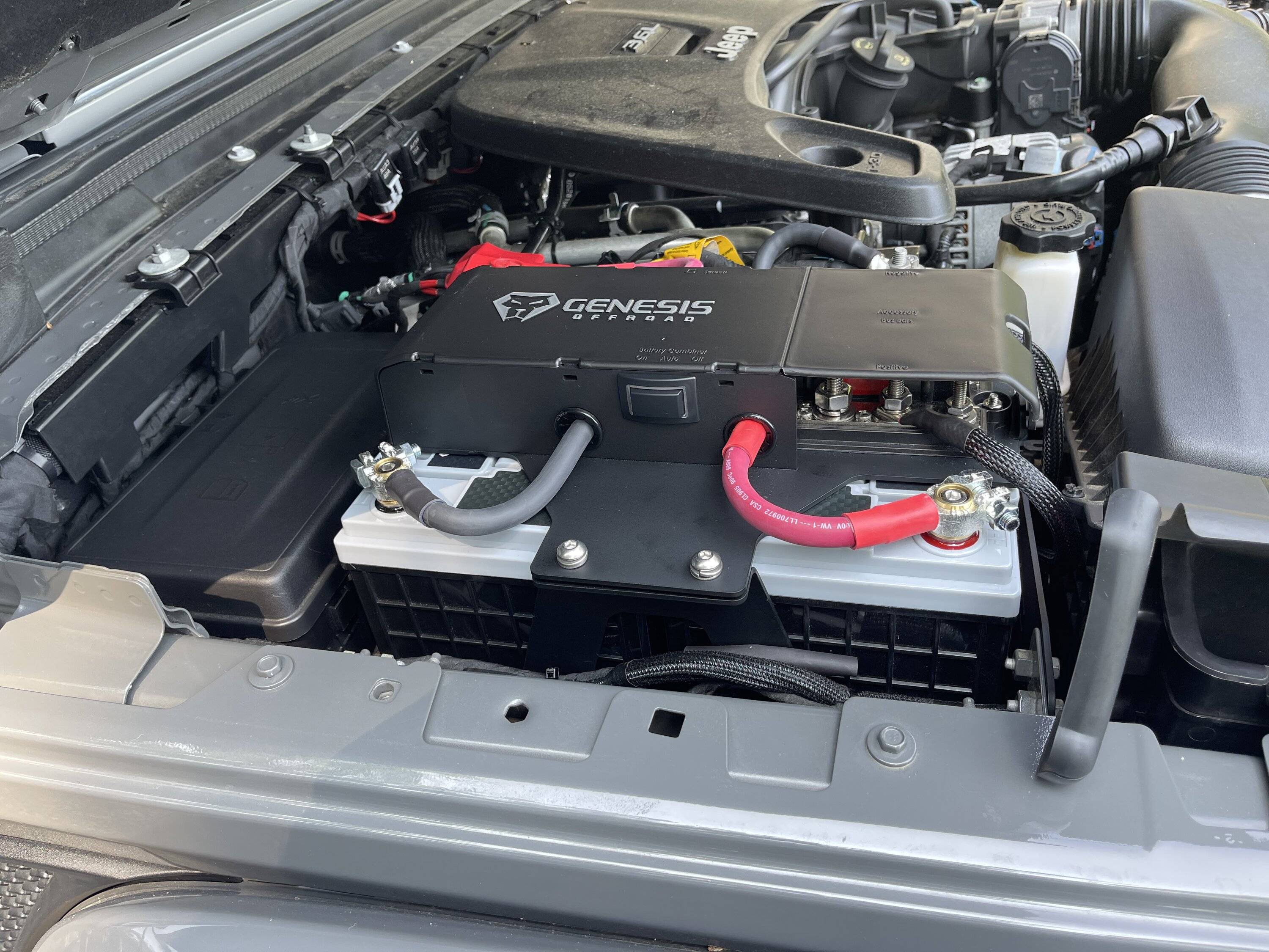

So the aux battery is only 14aH, would it be beneficial to add something higher like 28aH or higher?
Only if your ESS turns off and restarts the engine a great amount of times during your regular driving.
The purpose of the Aux Battery is to keep the computers and electronics stable during ESS events. They are paralleled together all the time, except during the startup test to see if the Aux Battery is there and at an acceptable voltage level, and during ESS events. Otherwise, the system sees the two batteries as one. The two battery design is intended to prevent marginal batteries from causing the computers to reboot from low voltage during ESS events.

Is there a way to add a full size battery in place of teh small aux battery?
Not easily. The Aux Battery is where it is because there is no room for it in the engine bay.
I added the equivalent of a Genesis dual battery system and left the factory setup in place. The Smart Isolator is mounted near the Main Battery, and the second battery is attached to the frame behind the right rear wheel. It has been in place over four years. It gave me the ability to jump start with the push of a button when the Main Battery started to fail.
