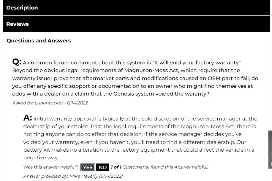

From Genesis - " Our battery kit makes no alteration to the factory equipment that could affect the vehicle in a negative way. "
But, as others have pointed out, the service manager is the judge and jury, at least in the lowest level court. You can try another dealer or you can take it to arbitration, should you need to.
