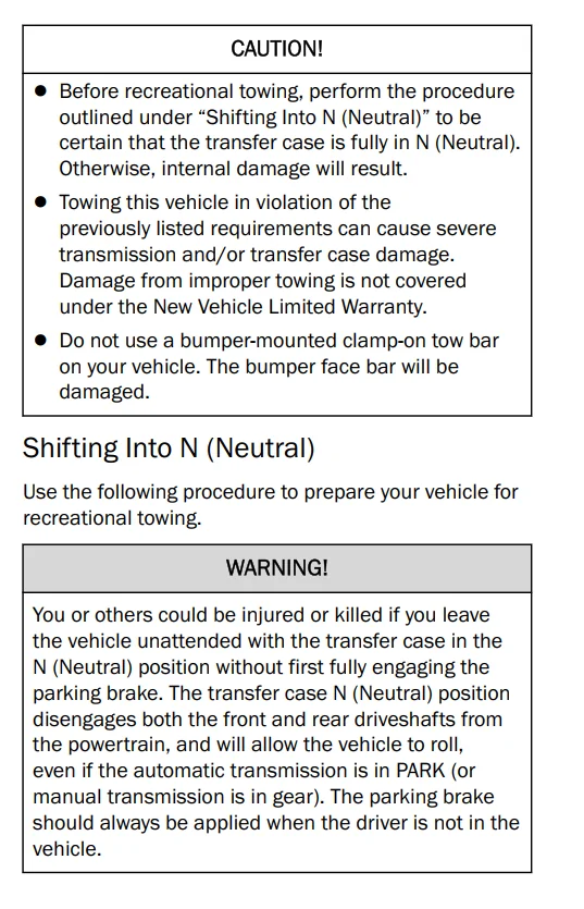

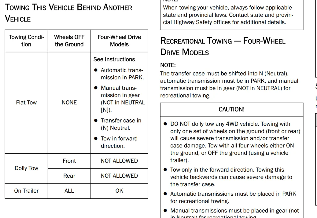

Flat tow is very easy. Just put your transfer case in neutral and flat tow all day. This is the method used by those with large motor homes here in the US when they flat tow their Jeeps behind it so that when they get to a camp ground, they still have a vehicle to get out and about with.
BUT, if you are referring to a 'flat tow' behind a tow truck, i.e. front end off the ground with the rear wheels on the pavement, then, yeah, you've got a problem as towing that way, even with the t-case in neutral, can mess up the t-case. Don't remember how, but, do remember reading references to that issue.
