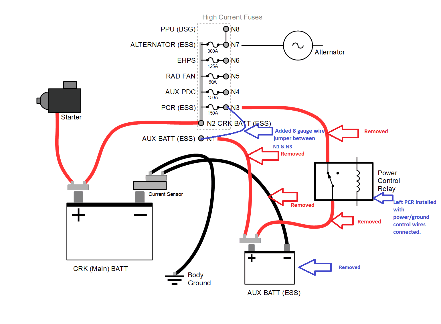

You can go to a single battery pretty easily, and it will be fine for most users.
The Genesis is a bit of overkill if you're not doing anything but replacing the factory setup to maintain ESS and a two battery system.
It's great if you're overlanding, winching a lot, or using any other heavy to moderate draw accessories.
There are numerous threads here, numerous Youtube videos, and numerous threads in the Wrangler forums on the several ways to accomplish the delete or bypass. The bypass can be done in minutes. The full delete is more involved, especially if you're pulling out all of the unused cables and harnesses for a cleaner look.
Caveats - Jeep changed the ground cable orientation around mid 21, so you need to make sure that the ground cable that you remove and isolate is indeed the one that goes to the AUX battery.
https://www.jeepgladiatorforum.com/forum/threads/single-battery-conversion.62056/
Jumperless Aux Battery Bypass | Jeep Wrangler Forums (JL / JLU) - Rubicon, Sahara, Sport, 4xe, 392 - JLwranglerforums.com
Jumperless aux battery/PCR bypass | Jeep Gladiator Forum - JeepGladiatorForum.com
Image credit @Hootbro (or at least that's where I got it)
