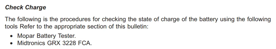

They want your vehicle in order to do their diagnostic which consists of a series of charging/discharging sessions with computer printouts that they have to submit to Mopar for execution of the warranty, so you get the inconvenience of them wanting your vehicle for the day/afternoon (as it takes several hours).
Where's that come from?
I have the battery testing document here and there's no such "3 charge/discharge" cycles in it.
You check the state of charge - and if it's below a certain point the battery must be charged to reach that SoC
You use the following to check state of charge -
Jeep Gladiator Dealer can’t get battery 1689539148030

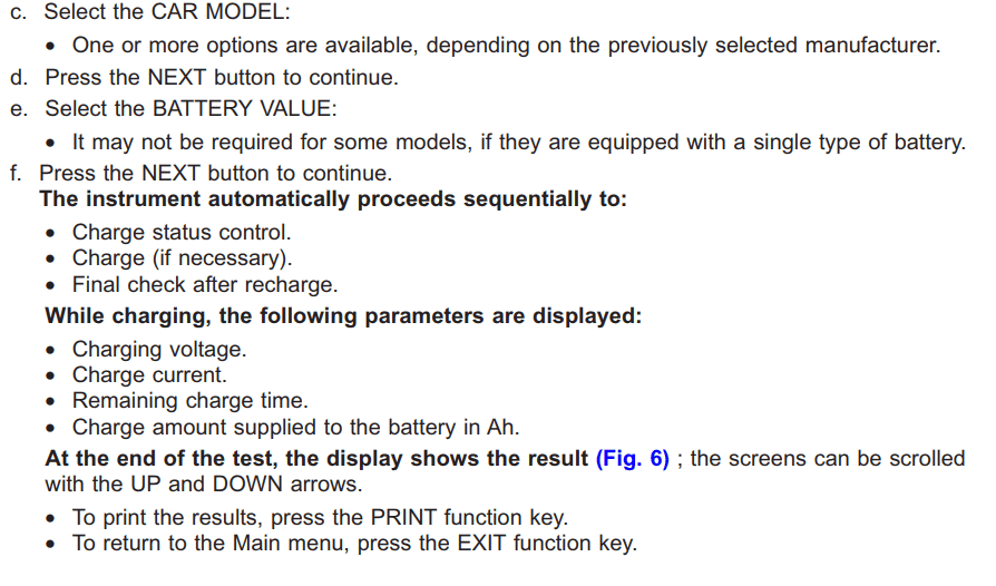

Then when you reach that point, you test the battery - no charge/discharge cycles.
They can do it in short order if you go in with a battery over about 12.4 volts.
Once they know it's up to level to be tested - this is it, nothing else to it -
Jeep Gladiator Dealer can’t get battery 1689539265973
Check SoC
Charge if necessary
Test
Print result (which are sent to Jeep via wifi)
There is no long sequence, it doesn't take all day.
People here have gone in, had batteries tested, and left the same morning with new batteries.
Check SoC
Charge if necessary
Test
