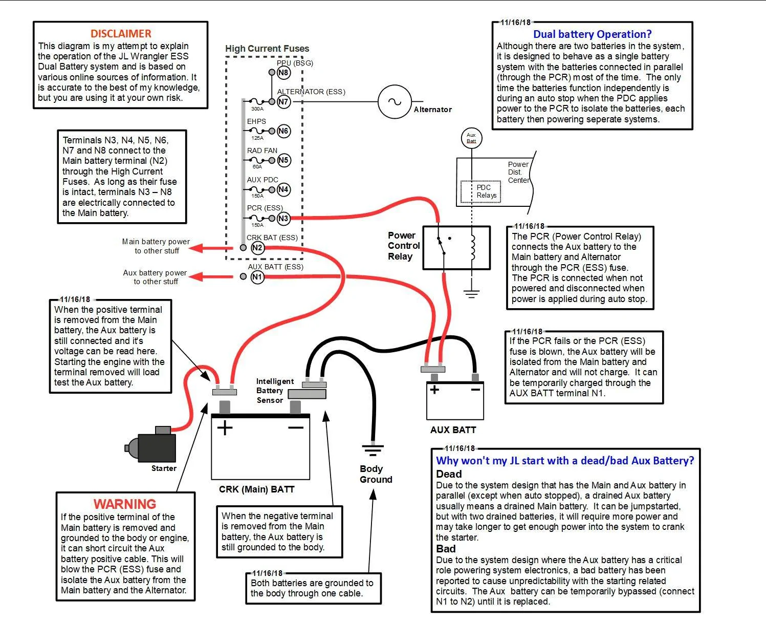

This drawing, from member Jebiruph, is one I refer to when participating in threads like these. This is the best illustration I have seen regarding the Jeep dual battery system.
You need to determine if you are having battery problems, charging problems, or system problems. I suggest starting over with your testing. The first step would be disconnect the batteries from each other, allow them to sit for several hours (to bleed off surface charge), and then test each battery. New, fully charged batteries should test ~12.8vdc. Both batteries should test the same.
