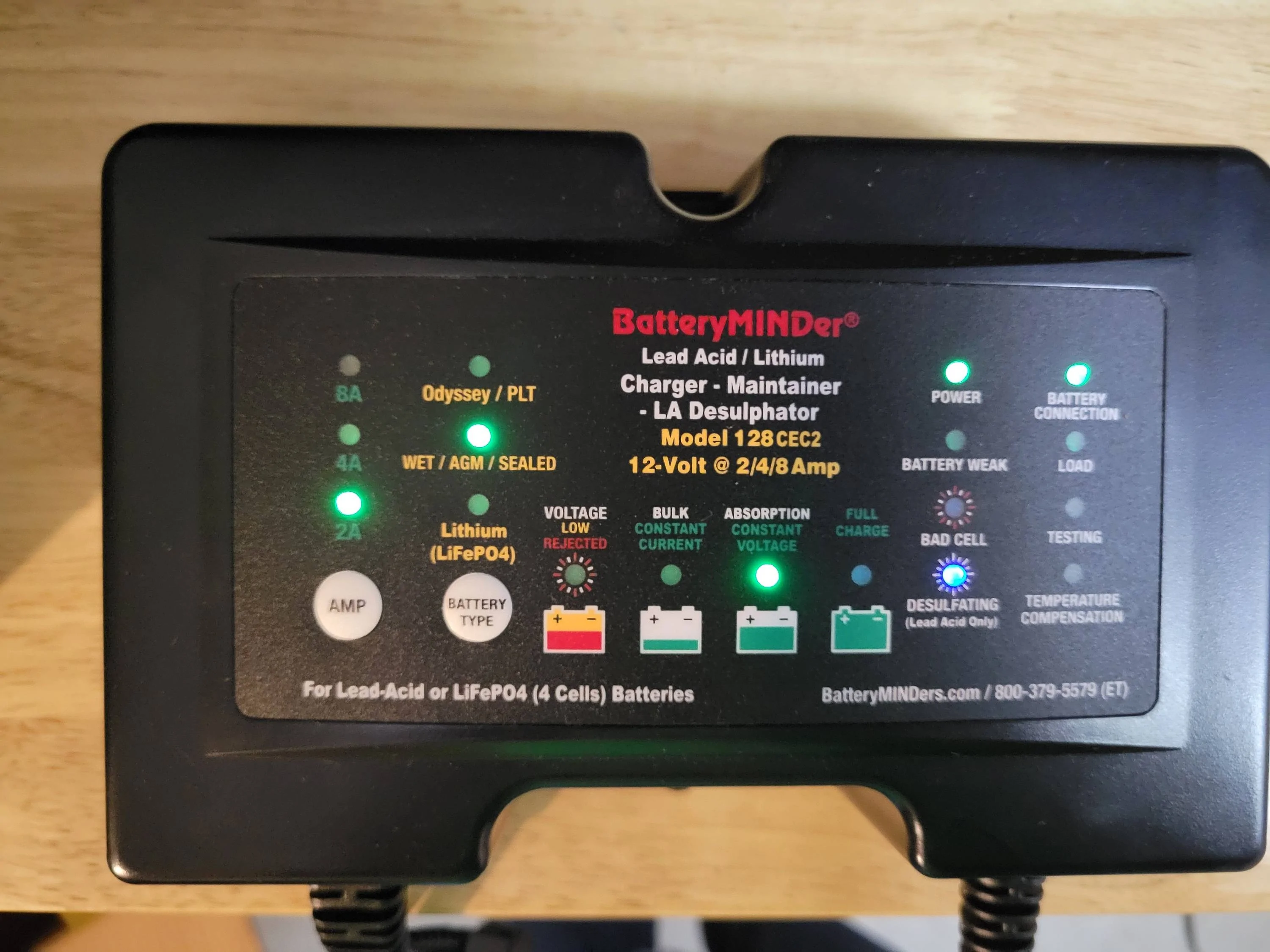

Yeah, the key here is to keep your batteries maintained, although it sounds like you had either a weak or bad battery to begin with. Our Jeep is only driven maybe once or twice per month, and I don't have any battery issues since I keep them on the charger/maintainer/desulfator. I literally have less than 2,000 miles on the Jeep and it's a December 2023 build date. I bought the Jeep on April 12th with, I believe, only 17 miles on the odometer. I'm guessing the Jeep only spent a few months on the lot before I purchased it.
Eventually, I'll switch to Odyssey batteries for the main and auxiliary, but I'm hoping to keep the factory batteries in good shape for at least 5 years. In the picture below, you can see where I installed a connector for the battery charger/maintainer/desulfator. We have three diesel powered vehicles. Once per week, I rotate which batteries gets charged. This is good practice and keeps the batteries in healthy condition.

I just have a quick connect on the battery that requires me to open the hood to connect
I did the same thing and that got old quick, which is why I installed the quick connect (no pun intended) on the front bumper. I use a 25'-foot cord that connects to the charger/maintainer/desulfator in the garage. This allows me to monitor the charging status.
