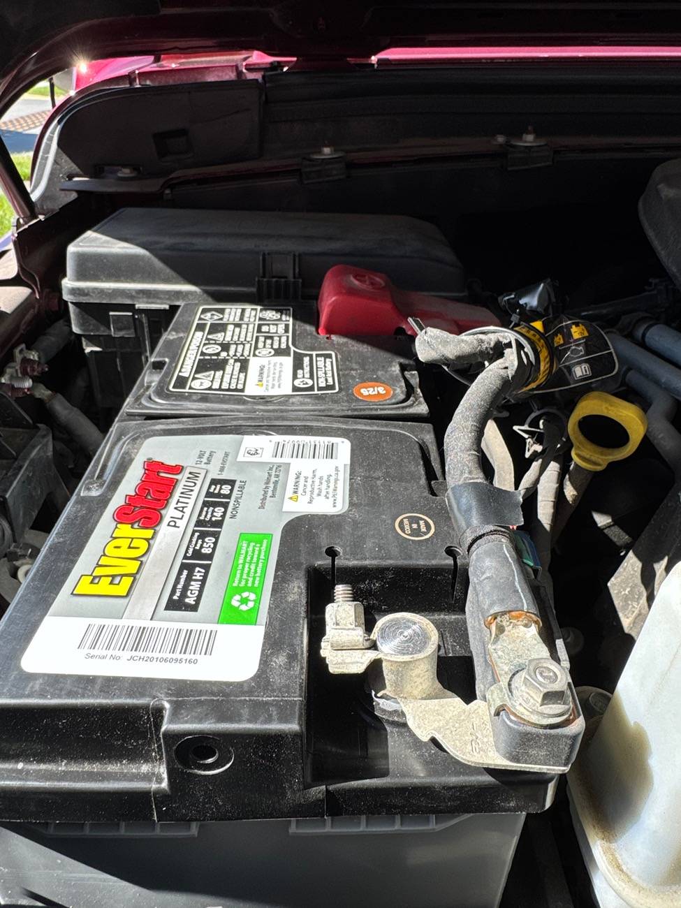

Just joined the club today( Aux delete) . I will first say the NOCO jump starter worked awesome. Had to jump it like 5 different times because the battery crapped out at the worst time. I’ve had the A on the dash for months so I knew it was coming. Dealership quoted me 785 plus tax to do both, thankfully they were out of stock of the main battery. Called a local shop and they couldn’t get me in until Wednesday. I had a lot of kid stuff going on so just wanted it fixed on Saturday to get it done. Ended up just throwing a Walmart special in there for 179 this morning with an 4 year warranty and got it done before my son’s first soccer game. The battery was bigger than my OE battery so I had to take out the spacer for it to fit. 2021 purchased in January of 21 with 38k on the dash. Must of lucked out with good batteries to last 4.5 years. Can I buy another battery cover to fit the larger one? Is it a big deal to not have the heat cover on the battery?

Just joined the club today( Aux delete) . Can I buy another battery cover to fit the larger one? Is it a big deal to not have the heat cover on the battery?
I'm in South Carolina where it gets hot-hot-hot. My Walmart battery is not covered and it has not been a problem. Covers are available if you feel the need. I'd check Amazon.
