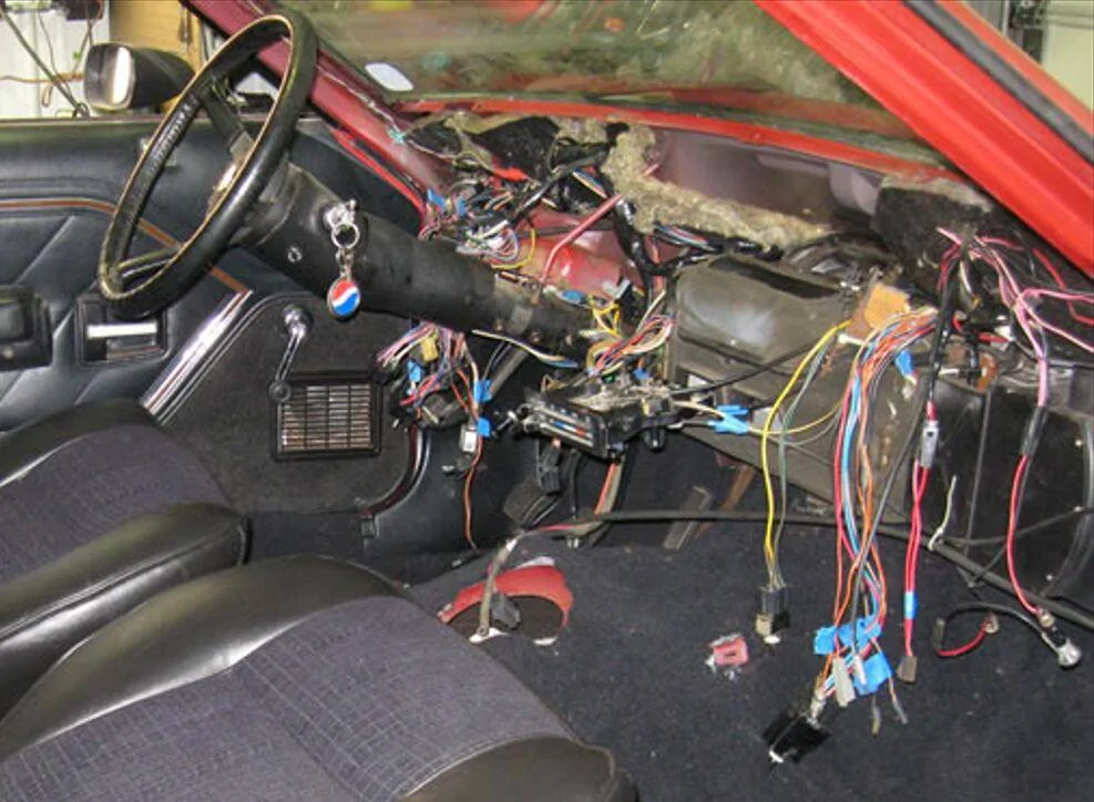

But then I've designed automotive wiring systems, designed and built electronic voltage regulator circuits for classic cars and have done that sort of thing for over 50 years and feel totally comfortable doing any of it.
Some of what I see out there is rather scary - even from shops............
