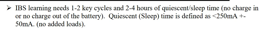

This is directly from MOPAR's STAR people -
Jeep Gladiator Replacing both batteries 1656945390407
One document that appears to be assembled by someone else states 5 cycles but I have not seen it take that long personally, and since the above is from a 2020 STAR document, I'd trust it more.
But I also keep in mind - there have been roughly 4 iterations of the IBS used by FCA.
Key cycles do not include remote starts, only normal "get in vehicle, push button on dash to start" type starts.

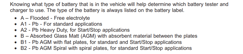

A battery is not a battery is not a battery is not a battery - even AGM has multiple types -
Jeep Gladiator Replacing both batteries 1656945724268
Note that B1 and B2 types and A2 are the only ones that mention ESS - the others FCA apparently doesn't deem fit for ESS?

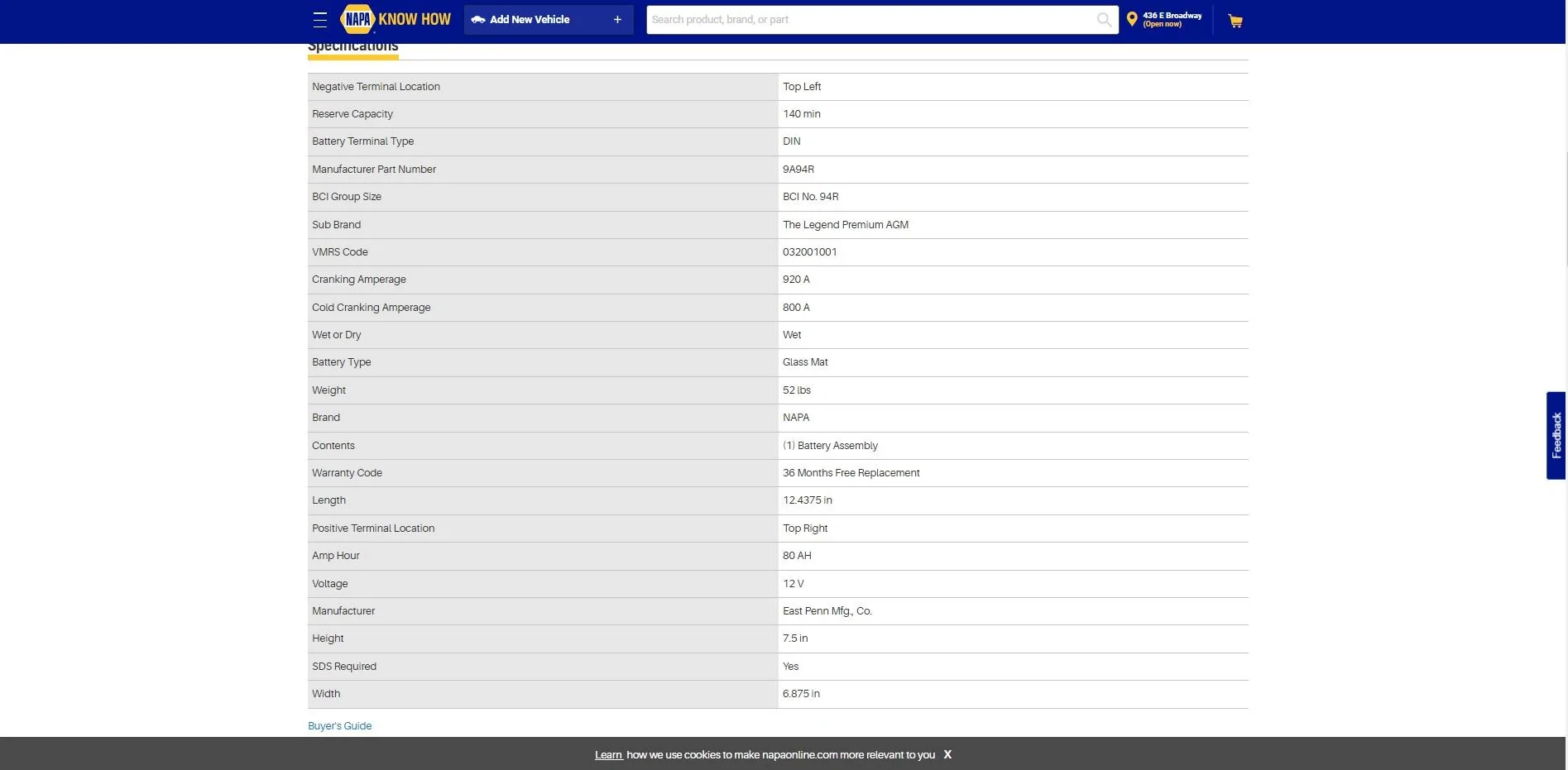

First off..papa...youre the man!
I NEVER knew the whole battery cycle for new batteries. Very cool to know. With that in mine ive had two "cycles" so far. Ill keep an eye out and see of the voltage changes.
any idea where the "type" would be on the battery? Looking at the info on the NAPA page it doesnt specify, at least as far as I can see. I know "the label" is the obvious answer. Just curious if its one of those weird designations that is molded into the plastic in a weird place.

I've not yet found the specifics on this particular battery other than it keeps popping up as dual purpose, and that sort of thing. It looks like it can handle a lot of "cycles" compared to others.
That means it can be run low - not fully charged every time (oh, like these Jeeps do to batteries HA) and it will still hold up. Some have said up to 900 cycles compared to a typical 400-500.
It's a pretty well respected battery.
