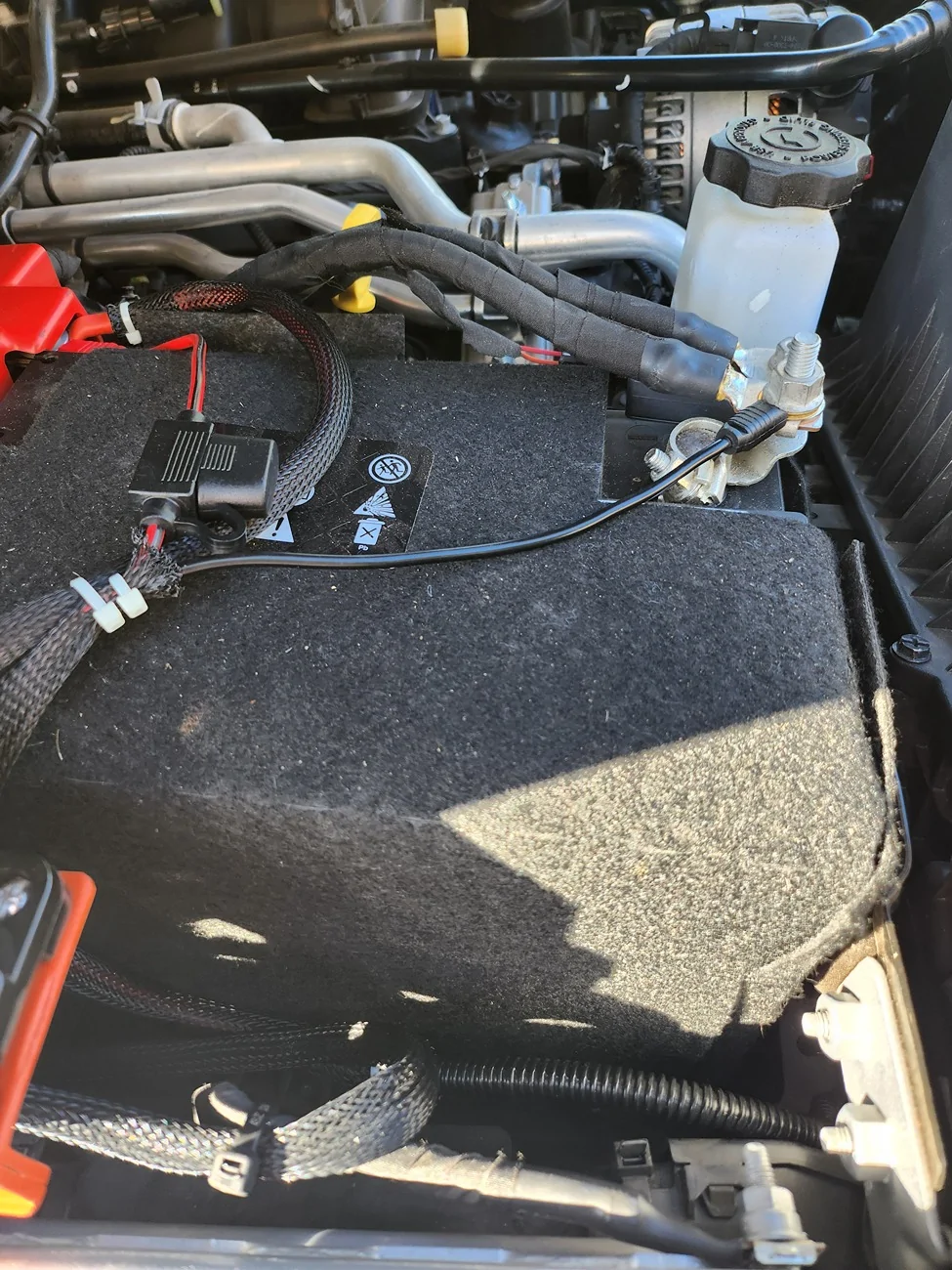

Yes you can hook up under the hood. Just be sure to add the charger pigtail to the top side of the block on the negative terminal.

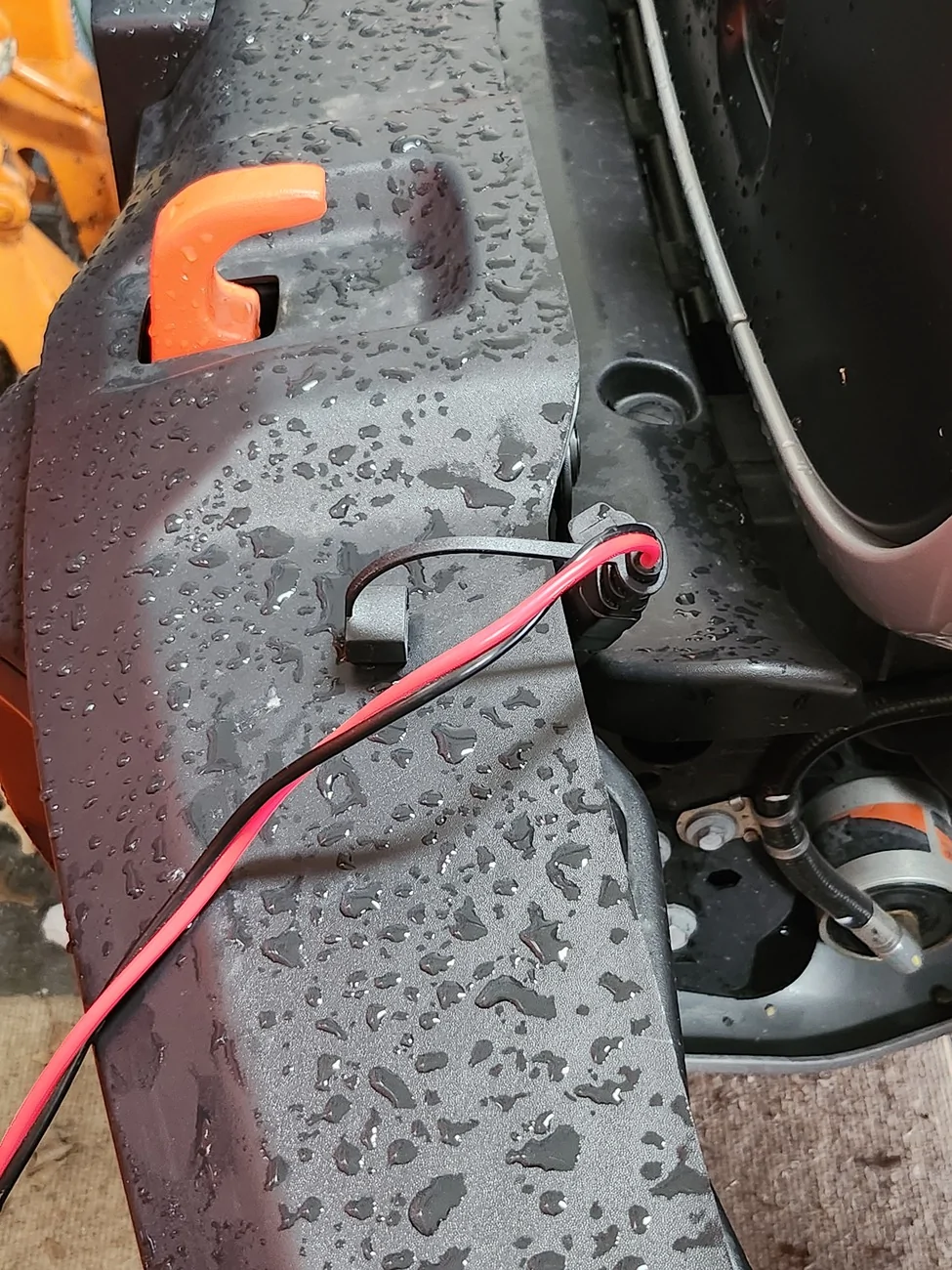

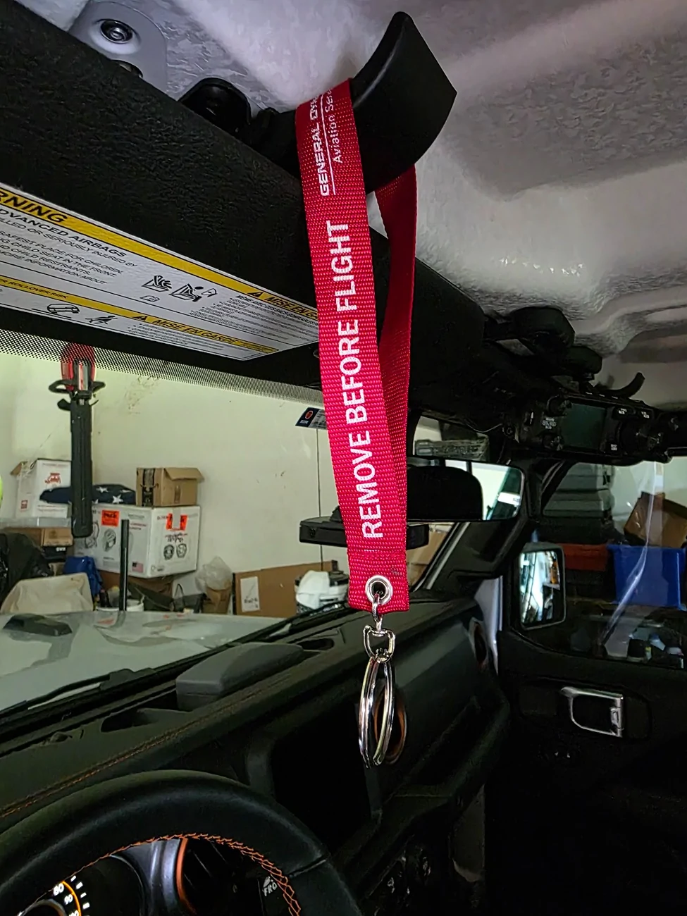

I ran the NOCO pre-made lead from the battery to the left front of my Mojave. If I need to ever do another battery charge wiring, I would just use the 7pin like others have recommended.
I thought running it up front, would allow me to never forget it was connected yup I did it, (pull head out of ASS ) Backed out of my garage in an extreme hurry forgot it was connected. Destroyed connector, at the Mojave.
Since then I now have a giant red tag hanging in front of the driver inside. It let's me know I'm connected.
Regardless which direction you go a warning indicator you are connected to your charger is a must. Shit happens.

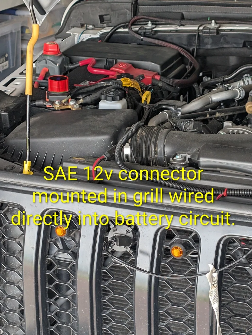

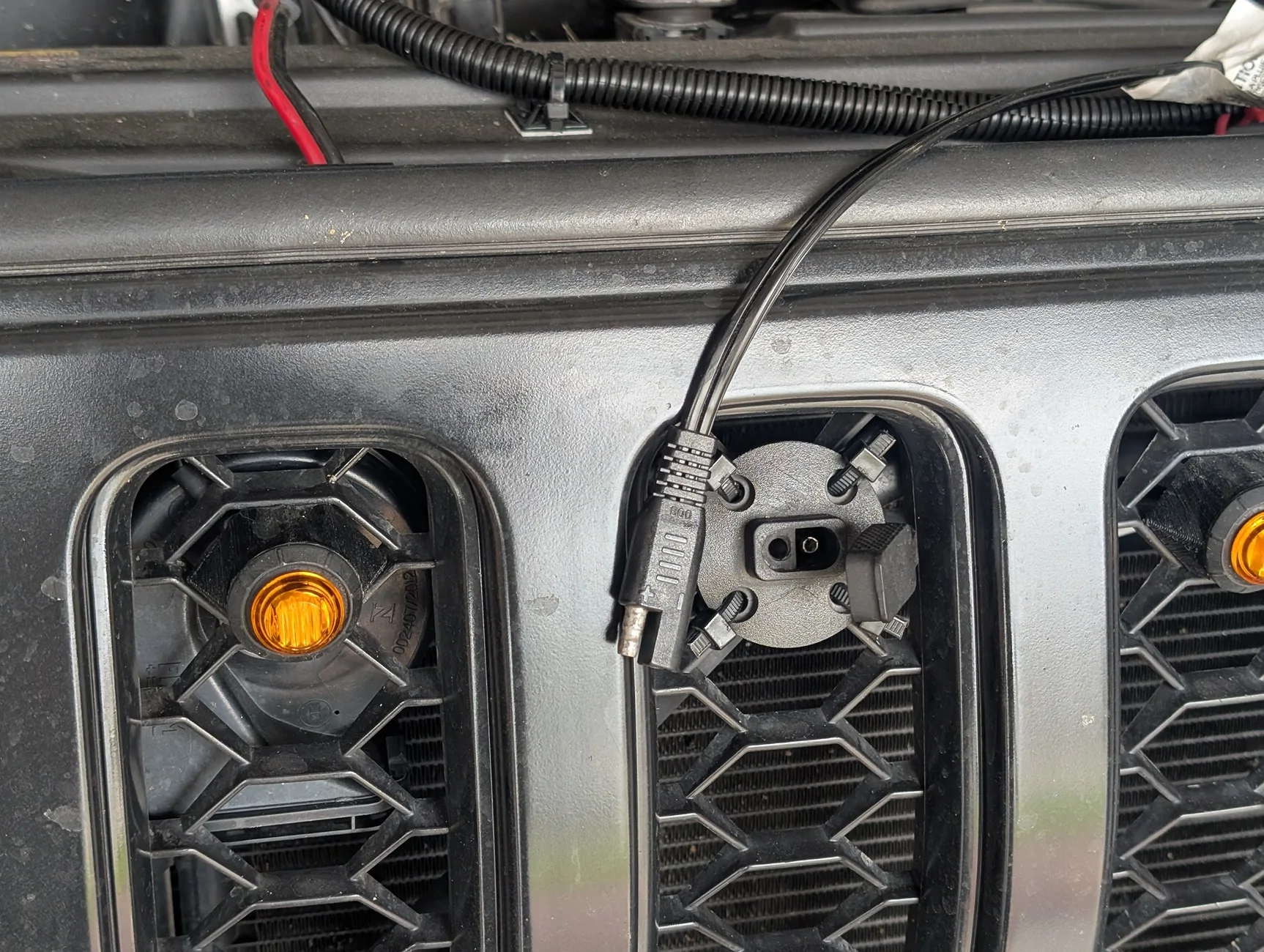

I use a simple quick connect plug up front, using a simple standard SAE 12v plug. The charging cable drops down from my garage ceiling, so connecting is a snap, and I can't miss it before driving off.

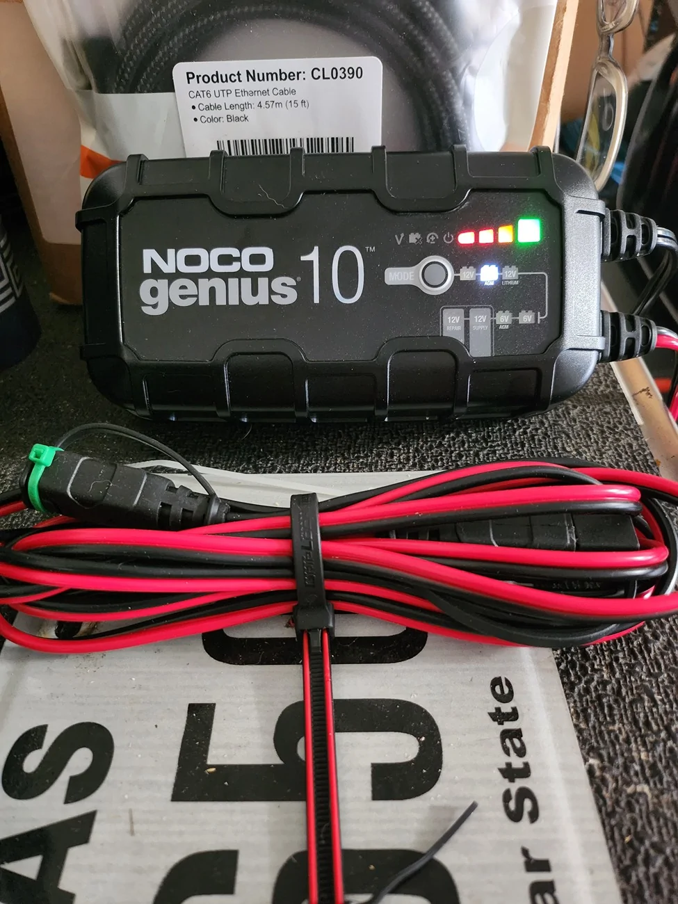

Don’t know if this is what you were talking about or not. I considered this route, but decided against it. I went with a Noco genius 5, and the Noco power port, that I mounted to my inner fender liner. I had to cut through the aluminum with a 2 inch hole saw, and it mounted perfectly. At some point in the future, I will purchase the trailer connector, to have the option of connecting, to either end of my rig. The Noco, is permanently mounted under the hood, on a bracket I made and painted. The port has a cover to make it weatherproof when not in use. Awesome setup
