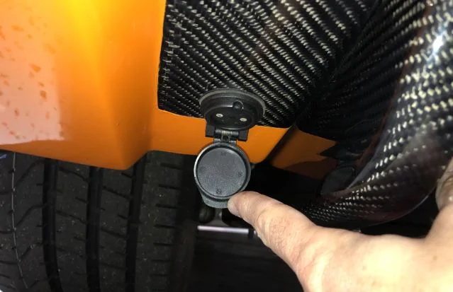

With the cost of batteries today, any battery, even a basic wet lead acid battery, a .5 or 1 amp battery minder or battery tender is really cheap way to extend the life of a battery. They way more than pay for themselves.
And many have quick connects on the cable so you can hard wire a pigtail to the vehicle and disconnect or connect without ever opening the hood.
I believe there are even magnetic connectors so if you are absent-minded like me and would tend to drive off without thinking of the connection - no biggy, the magnets let loose before any damage is done. (and because the connection is away from the battery, no sparks to blow the hydrogen produced while charging a legacy wet battery.
Yep. MagCode magnetic connectors. I added then to two vehicles already.
