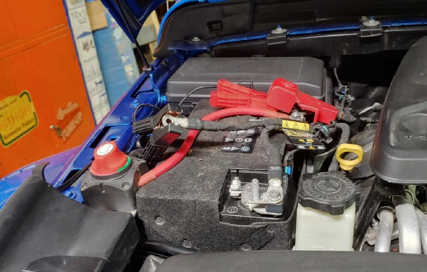

The small battery ground cable can be disconnected, which disconnects the small battery.
Right - take it off the top of the IBS on the crank battery neg.
Just be sure to leave the cable from crank battery to body ground alone!

The body ground cable runs from the main battery to the fender. Disconnecting this cable from the fender disconnects both batteries.

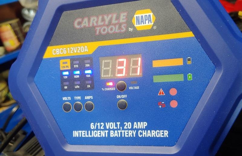

I've been sick and have gone nowhere for over a week - last place I went I took my car. The truck has been sitting in the garage, not started, for I think about 10 days now. I can't recall going any place before the car show a week ago where I would have used the truck. So figure at least 10 days sitting.
I went out and checked the voltage - 12.19 by the Fluke.
Battery charger says 31% with both batteries still fully connected, and charger connected in such a way it was "seeing" both batteries.

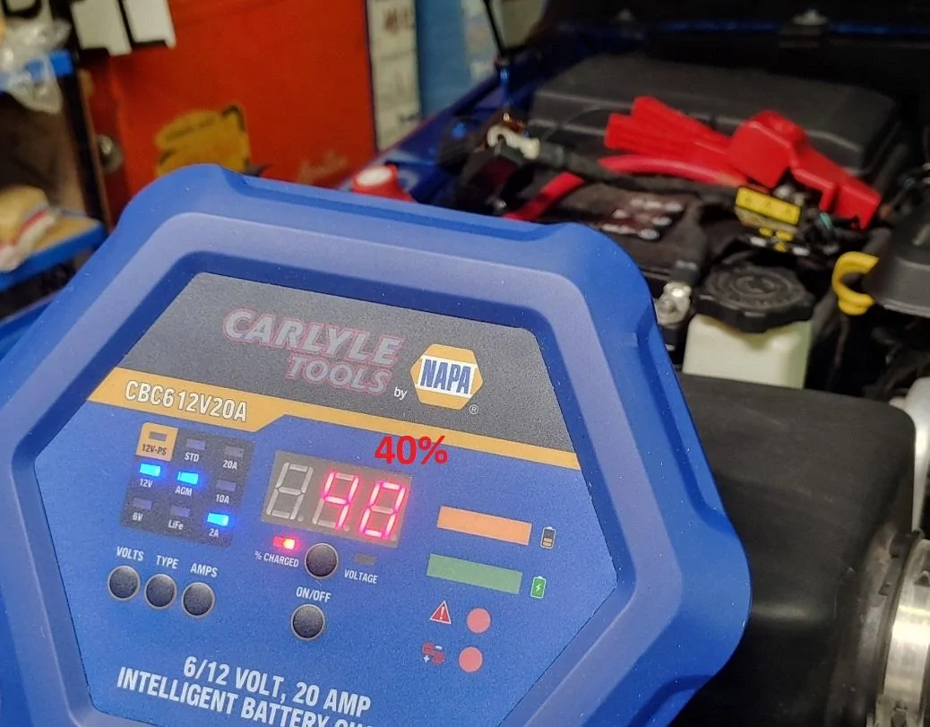

I disconnected the AUX battery at the crank battery negative post, isolating the two batteries from each other.
The main battery then read 12.6 by Fluke, the AUX measured 12.9 volts by the Fluke.
The charger connected only to the aux battery said 40% state of charge.
I didn't try, but I'm confident it would have started.
And Mr_Bill can correct me if wrong, but the 12.19 reading was based on voltage while things were still totally connected and the slight draw from the system.
With them isolated from each other and the system unable to pull voltage down, that's my explanation for the voltage reading higher once I pulled the aux negative cable from the IBS.
When I first went out and measured - 12.19 volts and 31% charge based on both batteries still connected in parallel and to the truck electronics->

Aux negative removed, charger connected only to aux battery electrically ->

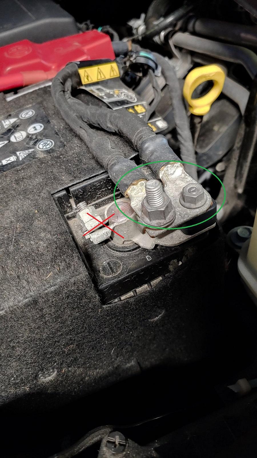

This is my 2020 IBS. That tall stud is a good place to connect the negative of a battery charger or battery tender/minder.
Not where the red x is because that bypasses the IBS - Intelligent Battery Sensor.
They want to track every milliamp going in or coming out.
