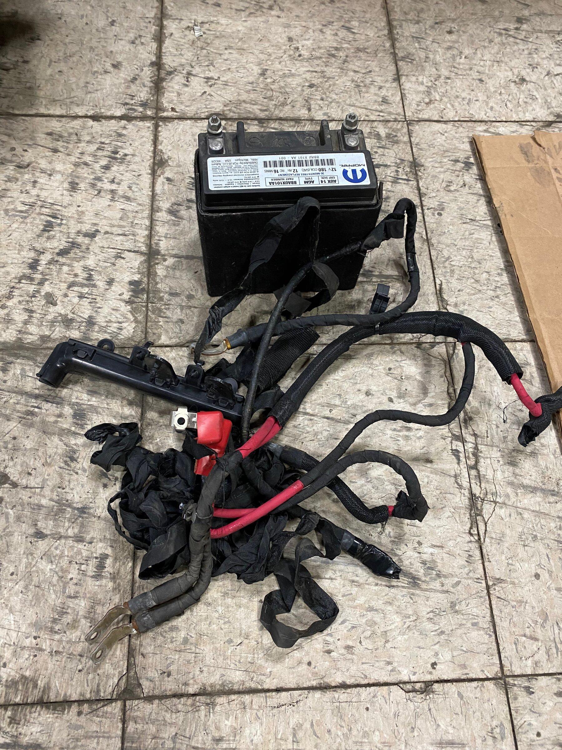

I've been researching what to do in case mine goes this same way, and I think the simplest, cheapest, and easiest solution is found here.
https://www.jlwranglerforums.com/forum/threads/aux-battery-ess-system.85696/page-2#post-1791098
Remove the auxiliary battery and associated cabling and make a simple non-fused jumper to move all of the electrical to the main adult-sized battery. Install a quality full-sized battery and you are done.
If you need lots of auxiliary power, the little hard to get at battery was never doing that work anyway, so then you can consider spending $1300+ on the Genesis setup with two full-sized batteries.
Here's the collection of crap that gets tossed.
https://www.jlwranglerforums.com/forum/threads/aux-battery-ess-system.85696/page-3#post-1792466
Jeep Gladiator Both Batteries Dead 2020 Gladiator $898 to replace!?!??? IMG_0951

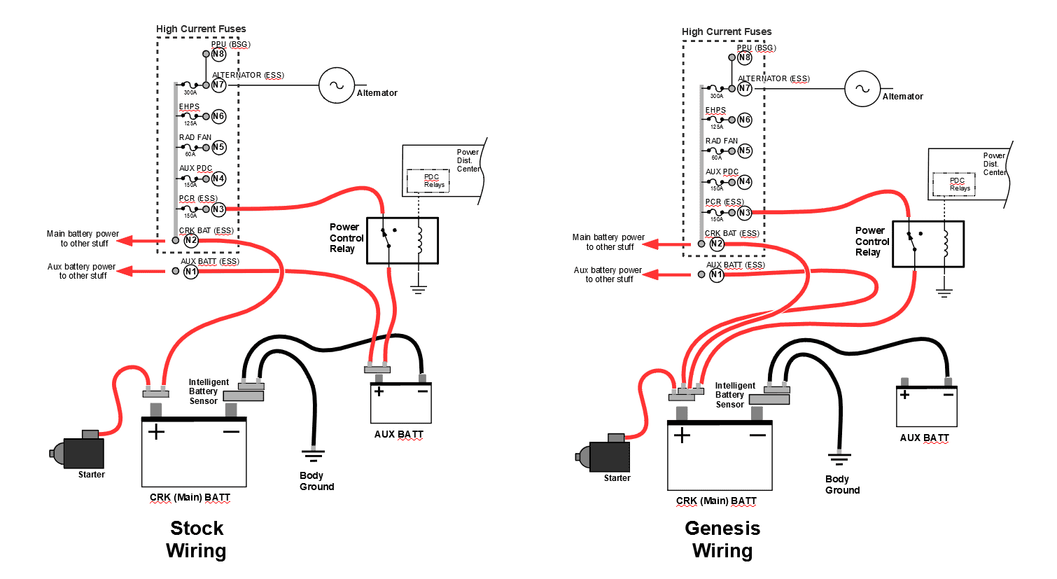

Knowing the system as well as you do, do you think that a genesis kit, and using the second battery as a replacement for the factory aux battery, would be a option to consider for those worried about it and about being stranded?

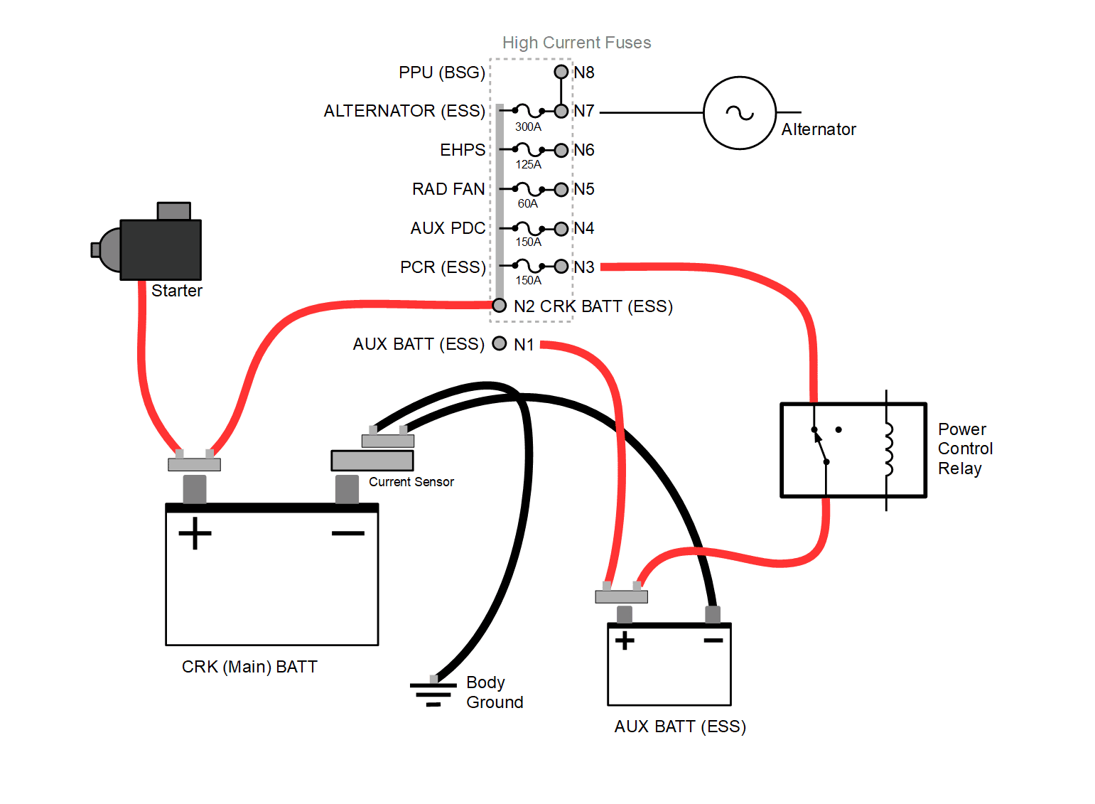

interesting. thank you for this info. thats quite a lot of stuff. So how does the alternator tie to the battery then. Isn't the harness that goest to the alternator, main batt, and secondary batt all one wire?
The alternator ties back to the main block at the fuse box and the jumper moves everything over to the main battery only. There are some diagrams in that thread that might explain it better.
Jeep Gladiator Both Batteries Dead 2020 Gladiator $898 to replace!?!??? 36L dual batteries
It also helps to watch the Genesis installation video, as many of the same components are handled to move the auxiliary battery workload over to the new full sized secondary battery.

It doesn't delete the auxiliary battery in function, just physically. It replaces it with another full-sized battery.
It may still void the warranty, but that would be worth challenging since it simply upgrades the little lawn mower battery to a full-sized one.
The Genesis system converts the 2 battery ESS system to a single battery ESS system with an extra battery by moving the aux battery cables to the main battery. The second battery in the Genesis does not perform the function of the aux battery in the ESS system.
That's how I heard it in theri video.
