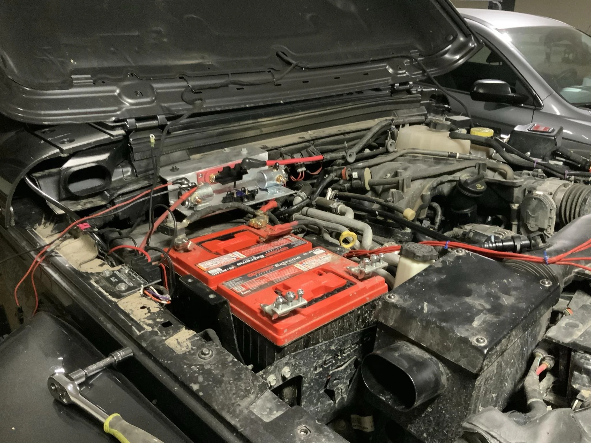

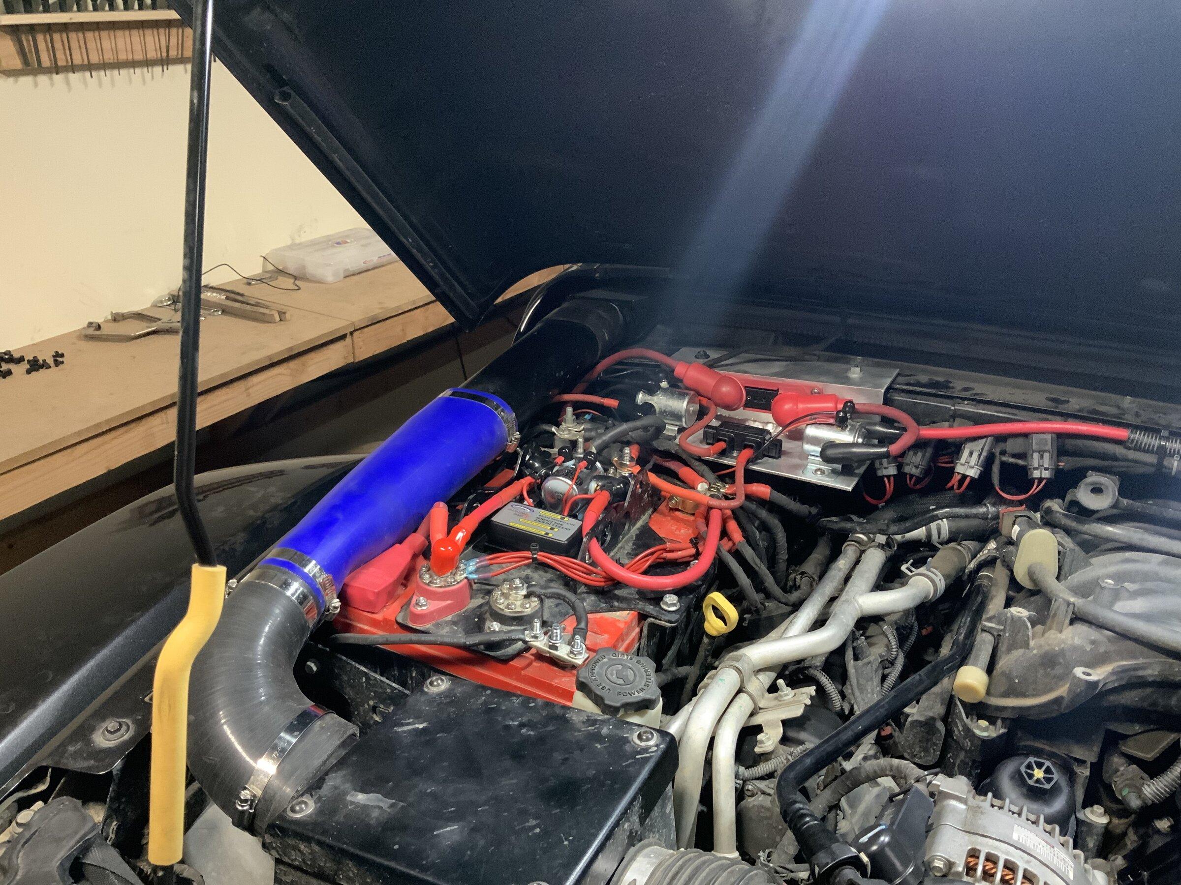

I know I’m not answering your questions, but: At that price you could swap in a dual battery system + two group 25 batteries. Been running this setup for a couple years now.
Way easier to work with than the stock system and the second battery can act like a built in jump, while taking the load of any accessories.
This is a great solution to the terrible AUX battery. Just sucks for anyone with extended warranty as it would void the entire electrical system which is probably the biggest $$$.
edit: turns out I am wrong.
From Genesis Off-road in JL forum:
"Just a quick note about the warranty question. We cannot speak for your local dealership's policies, but I can at least tell you that in 10 years of making our dual battery systems, we have not had a single customer call us to report any cases of a dealership denying a warranty claim simply due to having our dual battery kit installed.
As mentioned before, a dealer has to prove that the modification caused the problem. Essentially all we are doing is giving you additional battery capacity (with some additional bells and whistles). Yes, we move the positive wire from the small aux battery up to the positive post of the main cranking battery, but that by itself will not cause any problems that can lead to a warranty claim.
It is still possible to have an improper installation that leads to a problem, such as a pinched wire, allowing a wire to be too close to the exhaust, or whatever, but the same thing could be said for any other type of modification as well.
My point here is don't let worries about your warranty stop you from using the benefits that our dual battery system provides.
Oh, and we have kits in stock and ship same day!
-Shane"
