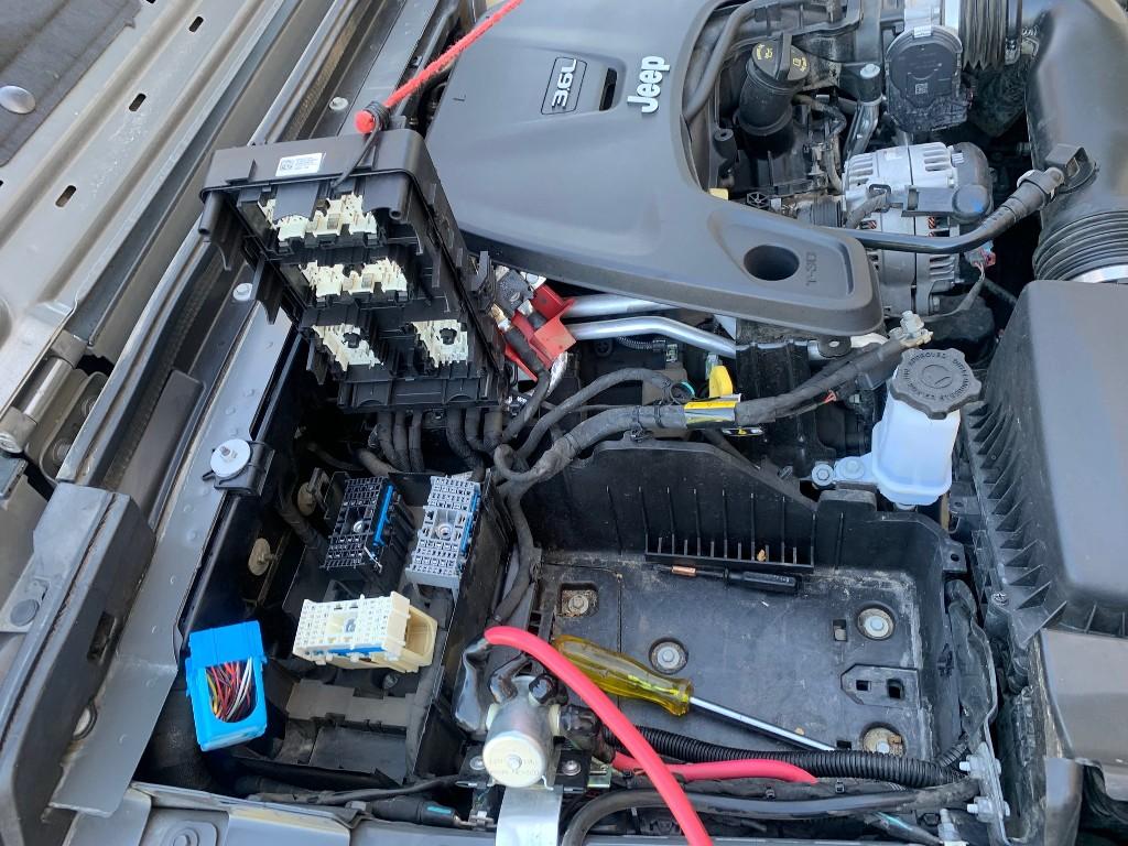

Basically, when the small auxiliary battery goes, by the time you notice it's already taken out the main battery. While I'm sure the dealer also banged ya dry for list price on parts, there is a stupid amount of labor involved to change that aux battery. Especially at dealership labor rates. Take a look at where they shoved that thing. Basically your choices are take apart half the engine compartment, or remove the fender and go in that way.

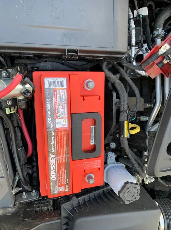

I just changed both of my batteries at 42K miles. I bought an Odyssey 94 group for the big one - around $350, and I had to buy the accessory battery from the dealer - $150. I could not find an aftermarket one in stock. Replacing it yourself is not that hard. There are videos on you tube on it. To replace the accessory battery, you have to lift out the fuse box. Here are some pics:
Note: My ESS has been turned off since zero miles. I have never used it. I knew my accessory battery was bad because my aux switches were not available in the morning. They would only work after the alternator got going. My big battery was still starting the JT, but, I noticed how slow it was turning over after I put in the new Odyssey battery -- which now turns over the motor super fast.

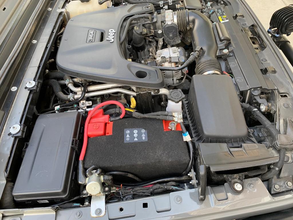

Has anyone installed the genisis 2 battery system with the aux switches? From the posted pic, it looks like it takes the space of where the wiring is at. thanks for any input. Also wondering if the genisis system would void warranty.

It’s sad that Jeep or any other auto maker would put a battery where the auto stop start battery is on these gladiators undoubtably the engineers that come up with this crap has never changed out a battery before
the fing little motorcycle battery is just there to keep the float charge with engine off higher. Instead of upgrading the PCM to handle the drop in voltage they added a second battery during ESS events.
People have been completely removing them and bypassing them as a good main battery handles it fine.

Mines got 51,000 miles on it and I haven't had any issues. A tech told me that sometimes if you don't use the ESS system and keep turning it off that the battery won't charge or something and that it was wise to let the system do it's thing. He said some of the issues they have saw is when people use weird ways to disable the ESS and then start having battery issues. I always let mine act as it should and never turn it off. Not sure how much truth there is in what the tech said but mines been fine.

I know I’m not answering your questions, but: At that price you could swap in a dual battery system + two group 25 batteries. Been running this setup for a couple years now.
Way easier to work with than the stock system and the second battery can act like a built in jump, while taking the load of any accessories.

I think he was more or less meaning people who try to trick the system to have it stay off by pulling the plug under the hood or other things, like disabling it permanently. He did make the statement to best let the system do it's thing, unless you have to to turn it off for some reason. I have always let mine do at is should, never turn it off. I don't see why it wouldn't charge though if you turn it off everytime by pressing the button.

Mine is a hybrid Genesis Off-road DIY kit + National Luna Battery Management system. I spent around $1k on it with batteries, and it took me 4-ish hours to install. Genesis sells full kits too, which are probably a little more expensive.
It’s a really easy install if you have basic electrical experience, take the time to do it right, and think through your wiring paths. Lots of good info on this forum if you search for the Genesis kit.

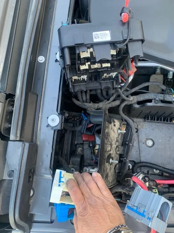

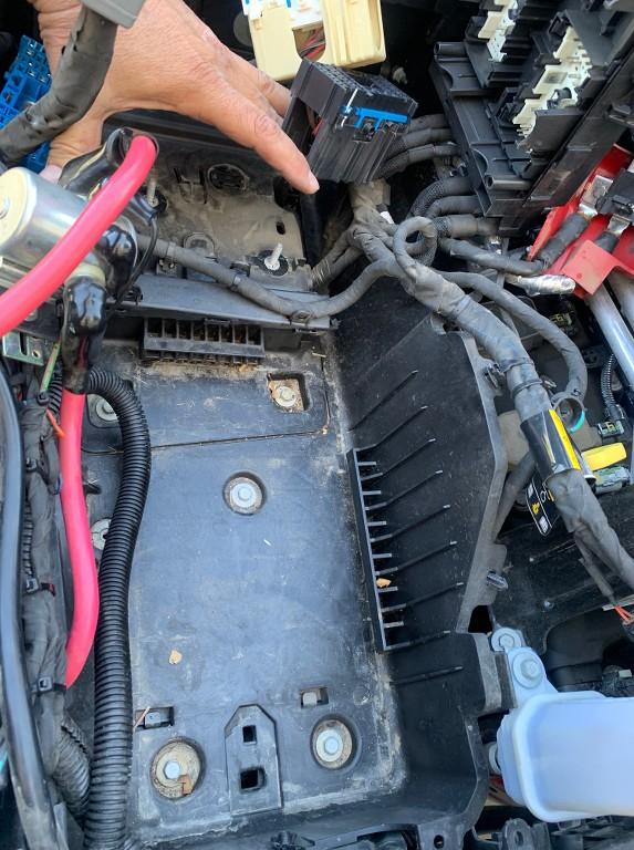

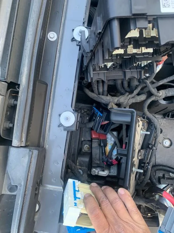

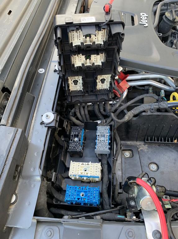

getting to small battery does not require taking apart half engine compartment. fuse box off, tie up to keep out of way. pick up connectors unscrew cover and there is aux battery. a little time and pain keeping connectors up and out of way but not a tear apart.

It took 30 minutes with cleaning dirt & leaves and dust out to replace the aux battery in my 20 JTR, from the top. It's not complicated.
