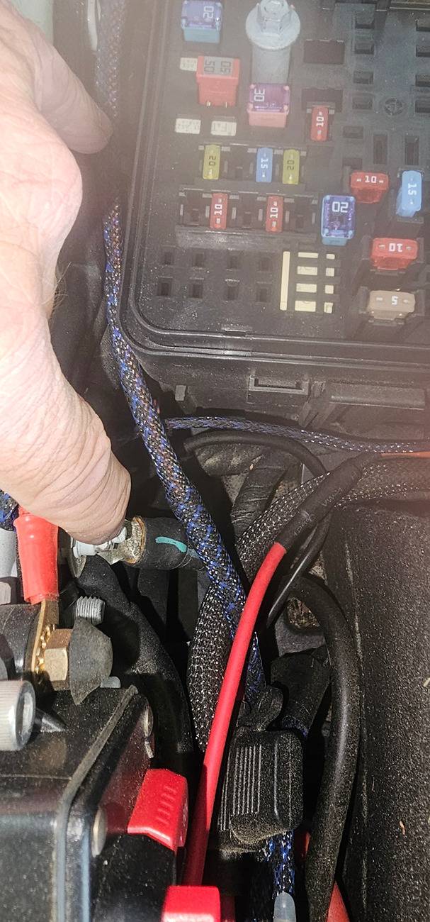

Gonna try this after swim class. You keep referring to fender ground, where is that located in relation to the negative battery cable location? Normally I just pull that and hang it on the washer fluid filler neck. For charging the aux, I may zip tie it there to be sure.

Yours may be less crowded than mine. It will kill power for both batteries. The top plate above the IBS has the other end along with the Aux battery negative cable.
