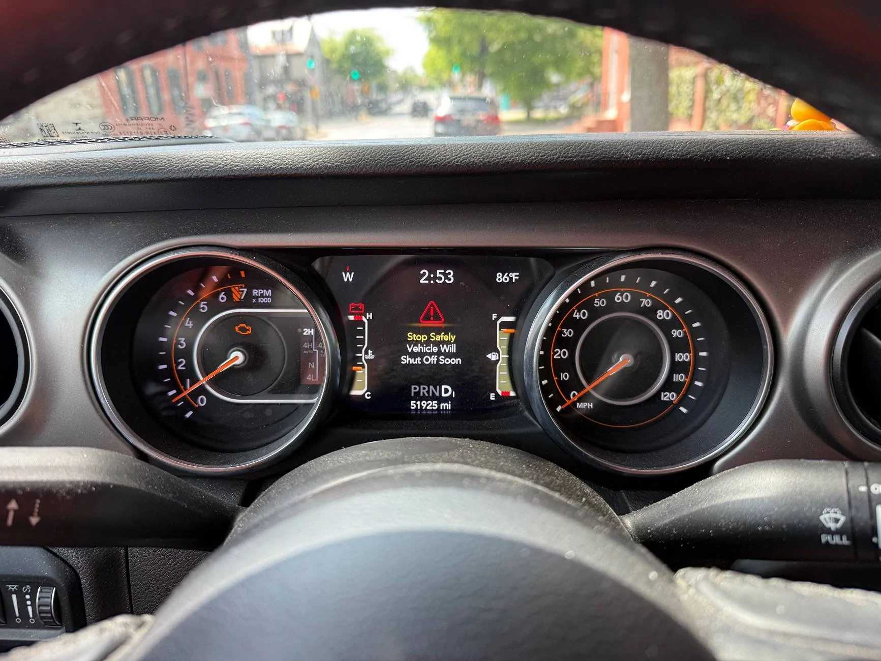

Ok, new test just now:
Main (engine on) 12.75v
N1 12.65v
N2 12.75v
N4 12.75v
N7 12.75v
Main (Engine Off, leads disconnected) 12.9v
reads to me like your alternator isn’t pumping out enough juice.

Same. I actually thought that might be the case by the end of the first page when OP stated he made it two blocks down the road after installing new batteries and the truck was reporting 11.8v on the dash while (assumedly) charging, I just didn't want to chime in and derail the thread due to my ignorance on how these trucks work. Plenty of folks here that seem to know much more about this than I do....but I for sure would be testing that alternator the first chance I got.

I thought the getting down the road was an issue because N3 was blown? Damn cars are too complicated haha.

Could be. I have zero experience with replacing the batteries on any of three Gladiators we have had. Lucky I guess. But my old man way of thinking wouldn't let me leave the parts store without at least testing the alternator. Assuming thats possible without some extra bits or equipment for these trucks.

If you fully charged your batteries using your trickle charger, those voltages might be fine: since the alternator output is variable depending on the needs of the system, why would it run at 14.7V when the battery is reporting fully charged? I.e., when I use my charger for a few days before driving (or just driving for hours on a long trip), my voltage will be in the high 12s on the dash while driving. Everything is fully charged = no need for alternator to keep pumping high voltage

i Was worried yesterday it didn’t fully charge the main battery because I didn’t isolate it. So I’m doing that now.

Finished charging the isolated main (I read the above, but since I started this well before I kept going) and disconnected ibs for 15 minutes. Started up and saw 14s across all N posts (alternator too) and in the instrument cluster. Will see how it looks tomorrow morning I suppose.
