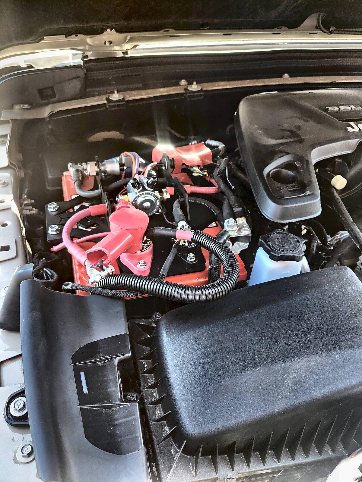

It had been a couple weeks that I hadn't driven my Gladiator when I saw something related: An alert at engine start that the aux battery wasn't properly charged and therefore the aux switches would not work. Naturally I tried an aux switch (for my air compressor) and it did not work. The odd thing: My aux battery is a full-size Odyssey AGM battery, not the little OEM motorcycle battery. Not only would a problem with it disable my air compressor, but it would also keep me from turning on my comm rack with all of its radios, and my aftermarket driving lights. The error did go away after driving a few miles and has not returned since (despite the stupid cold weather we're having right now).
Was adding that battery to replace the aux battery an easy fix?
It was a pretty straight-forward mod. Half a day of work. But I have quite a bit of experience with electrical work, and all the right tools and supplies to do a job correctly. Retired USAF avionics tech.
