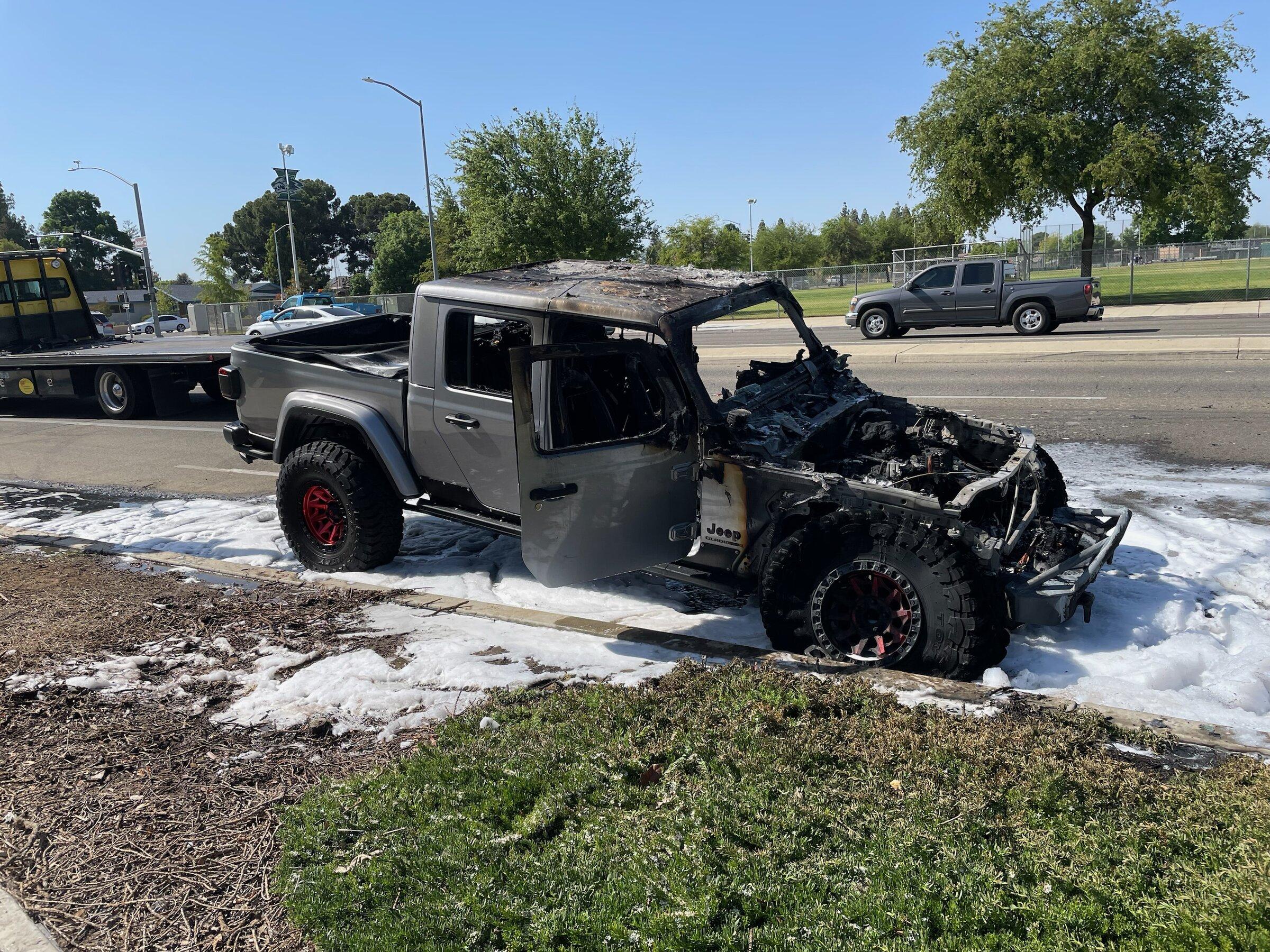

I always turn ESS off but left it on the other day and noticed it wasn't stopping. I was happy my negative thoughts on the system disabled it but scrolling through the menu, it says aux battery is still charging. It says that all the time and ESS does not work. I added a bumper and winch over Christmas and I don't know how long it's been like this. It looks like from searching that the aux battery has issues taking a dump. Will they cover it with a winch? I have only used it once and that's when I rolled the line up on the drum. The engine was running when I did it. I have 18k on the truck so far
That's what mine did. Once the dealer installed new batteries mine burned down!
Hello, Waynesoffroad. Our team would like to discuss this situation with you. Please send us a private message.

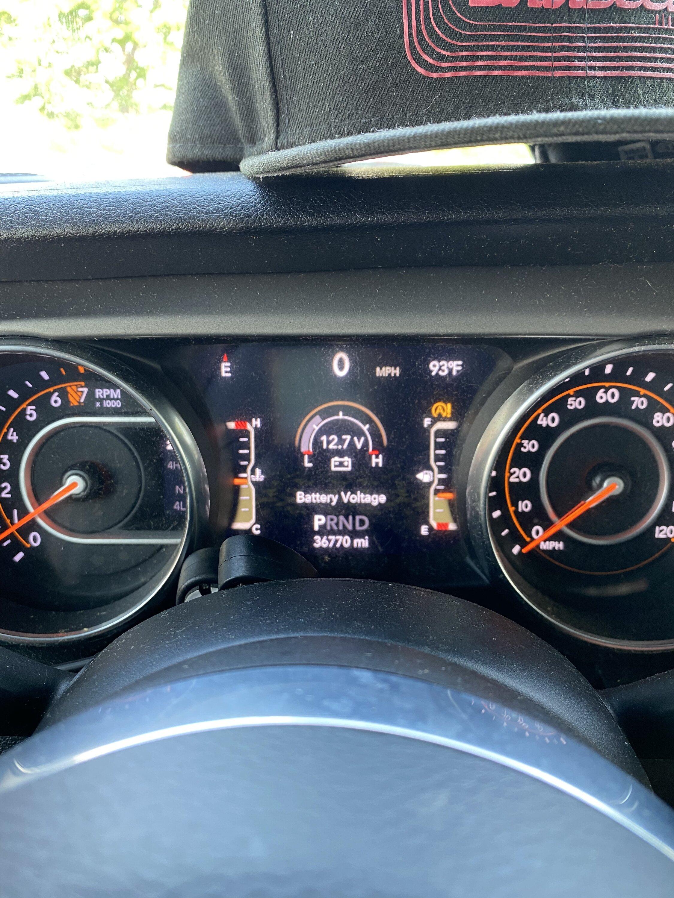

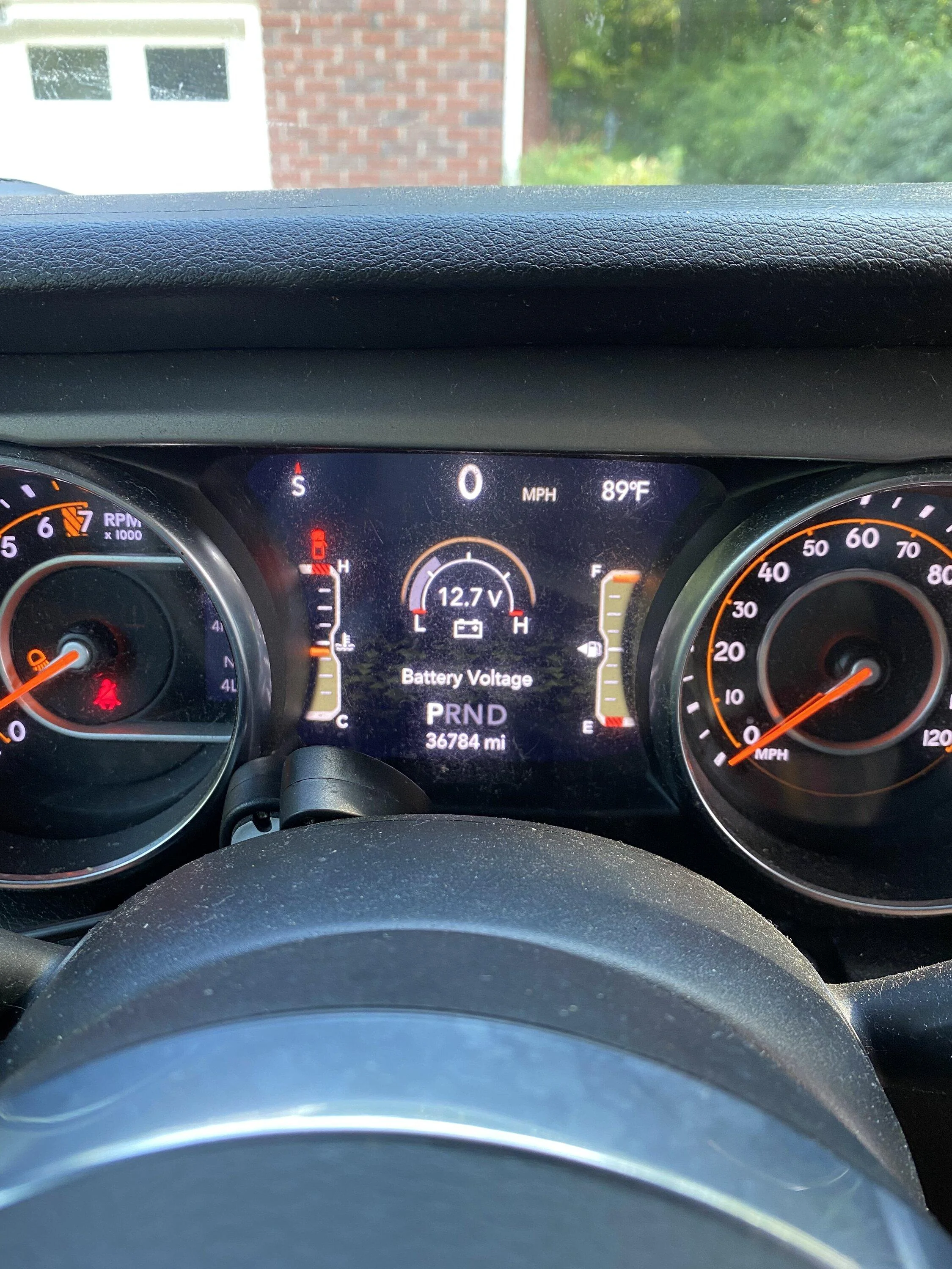

Looks like this issue has hit me now. 2020 Sport S 36,770 miles. The battery was going so I decided to proactively change both the main and aux. Jeep in mind no issues with any functionality to this point. After the change truck started fine but sat at 12.7V. Drove fine over 2 days then yesterday the ESS stopped working. I always keep it off but even so would like it to be operable. Realized after reading posts here that I needed to do the IBS reset. Did that this morning and went for a drive everything was fine. No ESS light and not the voltage driving was showing 14.2V. Stop at the store, come back out and restart and the light is back on and voltage reading 12.7V while running. Highest it will go while actually driving is 13.8 and that’s just for a few seconds at a time. Pic below is with engine running.
Next steps - I’ll throw out on the trickle charge over night and see if that solves it. Then maybe order anew IBS sensor?? Anyone replace there and solve this?
UPDATE: Last pic - Drove to get gas and when I turned out on the lights gone but the voltage still not what it used to read.

Normal operation, depending on how long it's been sitting, is to go into the high 13s, low to mid 14s for a while and then slowly go down to 13.0 to the upper 12s - such as 12.8 for example.
When the batteries are full and things are even, while you drive you'll see 12.8-13.0. It can go lower than 12.8, like to 12.7 for example.
When the batteries are fully charged and in good shape, if you see 12.8-13.0 while driving and then let off, or come to a hill, coast to a stop, hit the brakes going down a hill - basically when there's no torque demand from the engine, then the voltage will climb back up to 14-ish
Then if you get to the bottom of hill or hit the gas again, but a demand on the engine, the voltage will drop back down.
All of this of course depends on the electrical demands - lights, AC, trailer connected and so on.
The idea is it starts out high to top off the batteries after a start, then slowly ramps down.
While driving it only cranks out enough to keep things even there's no need for high voltage so to save energy and fuel, the PCM cuts power to the alternator's rotor.
If the batteries were correctly installed (meaning 100% fully charged using a good AGM charger) then the IBS was reset, all should be good.
Never put partially charged batteries in, charge them then install. Reset the IBS so it can learn from new fully charged batteries
Always charge through the IBS - never directly to the negative battery post below the IBS.
