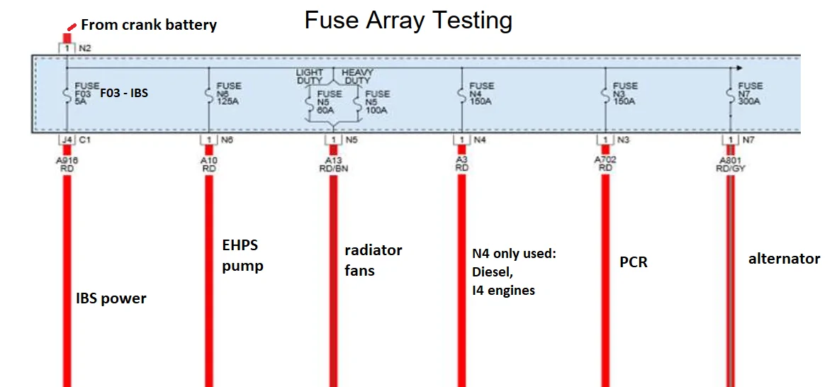

Alternator output goes to N7 on the high current fuse array.
And since all of the other terminals, save for N1, are connected more or less directly to N7, you should have the same voltage at each terminal - if one is drastically different, then you likely have a blown fuse.
