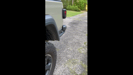

I've been dealing with this for about a year now. I've tried everything from driving like Earnhardt, to old man mode, to letting it sit for days and I have yet to "make" it smoke. It just does it at very random times and conditions. It seems to be worse now that the temps are getting warmer here in NJ. I didn't notice it very much over the winter but that doesn't mean it wasn't happening. About a week ago I got another one of those rare, large clouds in the middle of a very large crowded parking lot. Embarrassing to say the least. That is why it's going back to the dealer.
As far as my video goes, on my post I clicked on "attach files", chose my camera app, chose my video and downloaded it. My video is only 17 seconds so maybe yours is too long?

I definitely have oil smoke at startup. You can smell it, it's blue tinted, and now, multiple mechanics have confirmed it. My biggest concern is carbon buildup on the pistons. I plan on keeping my Jeep for a long time and don't need any of the problems that come with oil burning this early in my Jeep's life, even if it is only a puff here and there. I'll be making an appointment with my dealer within the next few days so hopefully I'll get some answers this time.

Update: I Took my Gladiator into my dealer service dept a year ago but only had the smoke at startup issue so the tech ran an oil consumption test (negative result) and sent me on my way. Fast forward to yesterday. After reading TSB 09-012-22, thanks again @JW Jeep, I remembered that recently, my Gladiator had been pinging intermittently when hard accelerating, but I passed it off as poor quality gas and just switched gas stations. The pinging was very light and inconsistent and only on hard acceleration. It hadn't happened in a few weeks so I didn't give it a second thought until I read the TSB. I have also recently been having a slightly rough idol, but again, only very infrequently, barely noticeable, and nothing that was bad enough to throw a check engine light. Again, passed it off as poor quality gas...not. I took my Gladiator to my dealership service dept yesterday, explained everything, and mentioned the TSB. They downloaded all of my videos of it smoking at startup to their computer system and my service advisor and a level 3 mechanic went over all of the issues with me. They checked it out this am and called to tell me that my PCV was malfunctioning and I qualify for repairs under the TSB. They also mentioned letting Mopar know about the additional symptom not mentioned in the TSB of smoking at startup...not sure how far that will go. I also asked the mechanic if he could please let me know the condition of the internal engine components so that I can post here how bad my engine was getting with this issue at 17500 miles. Now I'm just praying that everything goes back together properly and that I don't have any new issues resulting from the work itself. Not a fan of unsealing a factory engine but here we go. I will post any updates on the dammage, if any, to the engine. I hope this helps someone.
