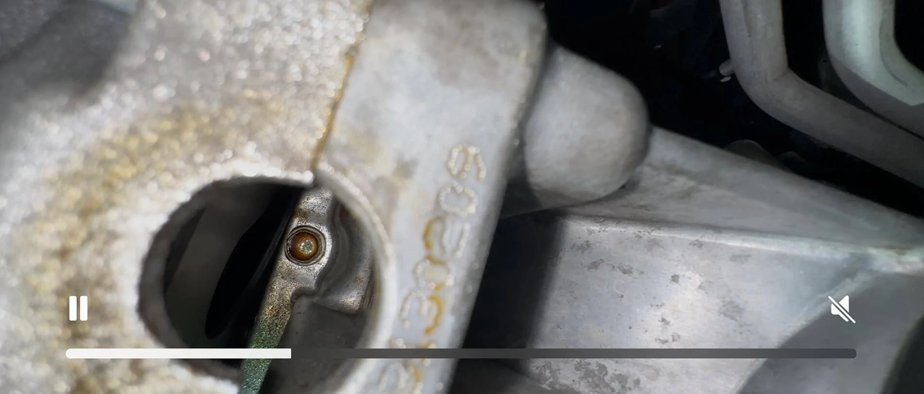

Update: Dealership (I bought used so not a Jeep dealer) said it was a valve cover gasket. Replaced it and sent me on my way.
It's still leaking so I pulled the inspection plugs and found dripping from the upper oil pan bolts.
See pic. Seems to me like it's the rear main at this point? Anyone else have a more informed observation?
Only two things up there that could be leaking. Rear main on the engine or transmission front input seal. Either one is going to require the transmission to be dropped for a fix.
Looks like RMS to me, i've had mine replaced 3 times, its a fairly quick fix.

Update: The Dealership (non-jeep / Chrysler) is telling me that a) they don't see any oil even though I shared the pictures with them and that b) what they do see is "fine" so no further work is necessary.
To be clear...they have the jeep and are in person looking at the same thing I was looking at when I was investigating the leak...and are somehow denying that my photos show oil.
I'm about to drive there and point it out to them...
If anyone has suggestions on how to best handle this as I'm about to be out of warranty soon...I'm all ears.
