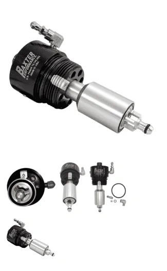

I saw this awhile back - love the idea but have not seen enough feedback.
Not sure if the Pro's justify the cost...
Anyone running this??
@ShadowsPapa - what's your view on this?
https://www.baxterperformanceusa.com/spin-on-oil-filter-adapter-1.html
I see no real need for it.
I believe it's more of a "feel good" thing than necessity.
Look at the millions of Pentastar 3.6 engines out there.

I was thinking along those lines as well - track record for standard filter is pretty damn good. Don't see how this is justified - I have not seen/heard of many issues where you need to have an anti-drainback valve.
