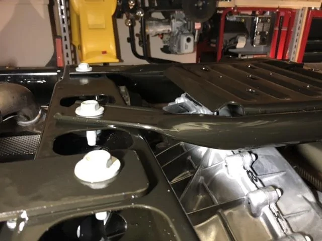

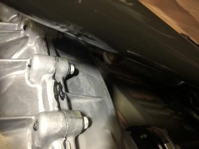

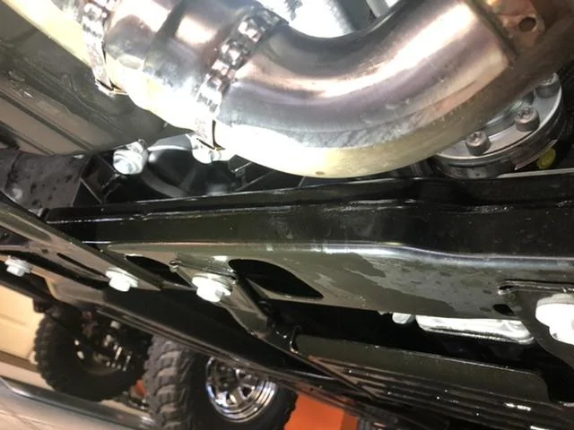

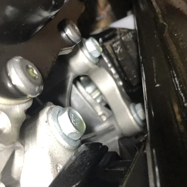

Took delivery of my 2020 Gladiator today and drove 35 miles home. When I got home I noticed oil leaking. Drops in a 4' diameter under it. The engine oil pan and transmission pan are clean and dry. The oil seems to be coming from between the transmission and the transfer case. Its an almost clear oil, that lookslike vegitable oil, slightly yellow on a paper towel but has a green tint dripping from the skidplate. There is oil dripping from this point and slathered on everthing underneath from there back. I called my sales rep and he told me not to drive it and that they would send a tow truck in the morning for it. I am pretty pissed off but know its not the dealerships fault. I am concerned that I could have done damage driving it 35 miles if it ran out of oil in the transfer case. It also a brand new vehicle with 41 miles. I am not sure how I feel about them having to drop half the drivetrain from a brand new vehicle and try to replace gaskets. Would expecting a replacement vehicle of the same options be unreasonable? How would you handle this?

You don't know yet what is leaking. Is it trans or transfer case lube, or coolant? It is a mess now, but how much actually was lost? I'd give the dealer a chance to answer those questions.
Dealer is sending a roll back to pick it up today and is delivering me a comparable loaner. Hope to know more later today or early tomorrow.

my JT has been at the dealership all week and they have identified the issue as a bad transfer case output shaft seal. The part has been ordered and is expected to arrive tomorrow. I’ve been told I’ll have my Jeep back on Monday.

I agree w your process. Unusual for the output shaft seal to fail, and unusual that it had 40+ miles and no symptoms. As long as no deformities/scratches etc. on the shaft, a seal replacement should be fine.
