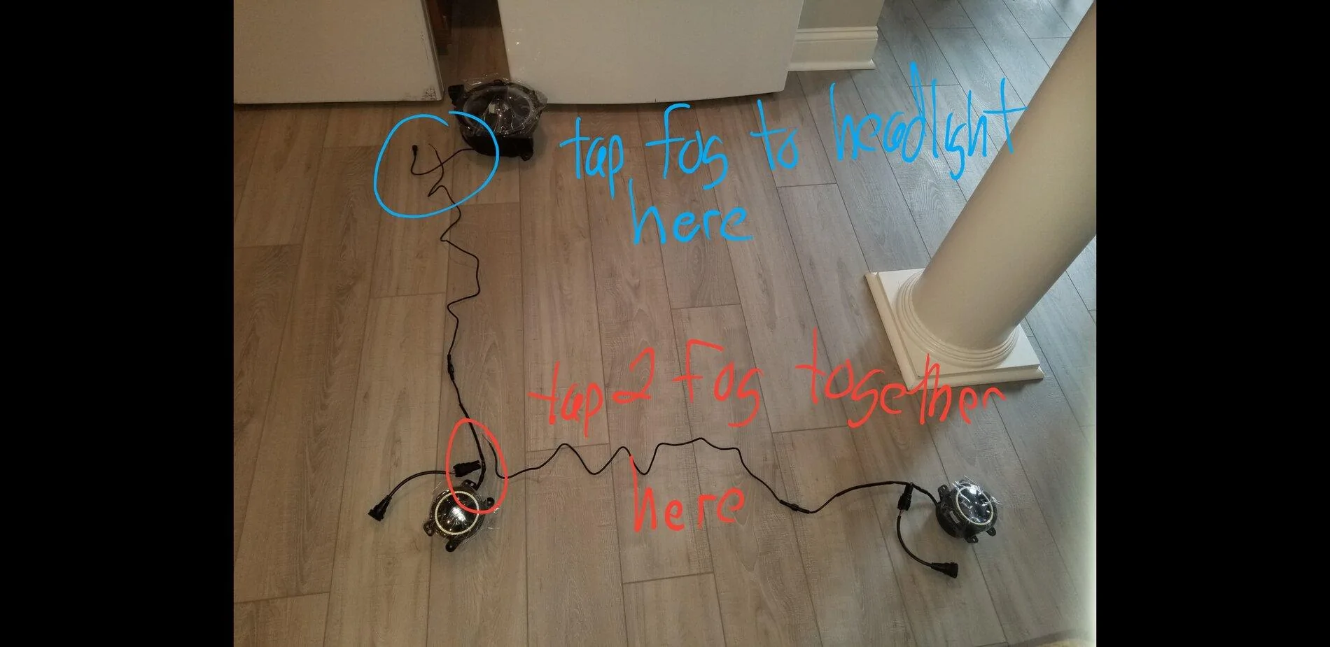

That makes sense. Please see the attached pic to verify I'm right. I'll need to tap in 2 places. I assume the fuse (#52) will be able to handle all 4 lights
You can definitely do that this way. Also, those fuses are plenty.

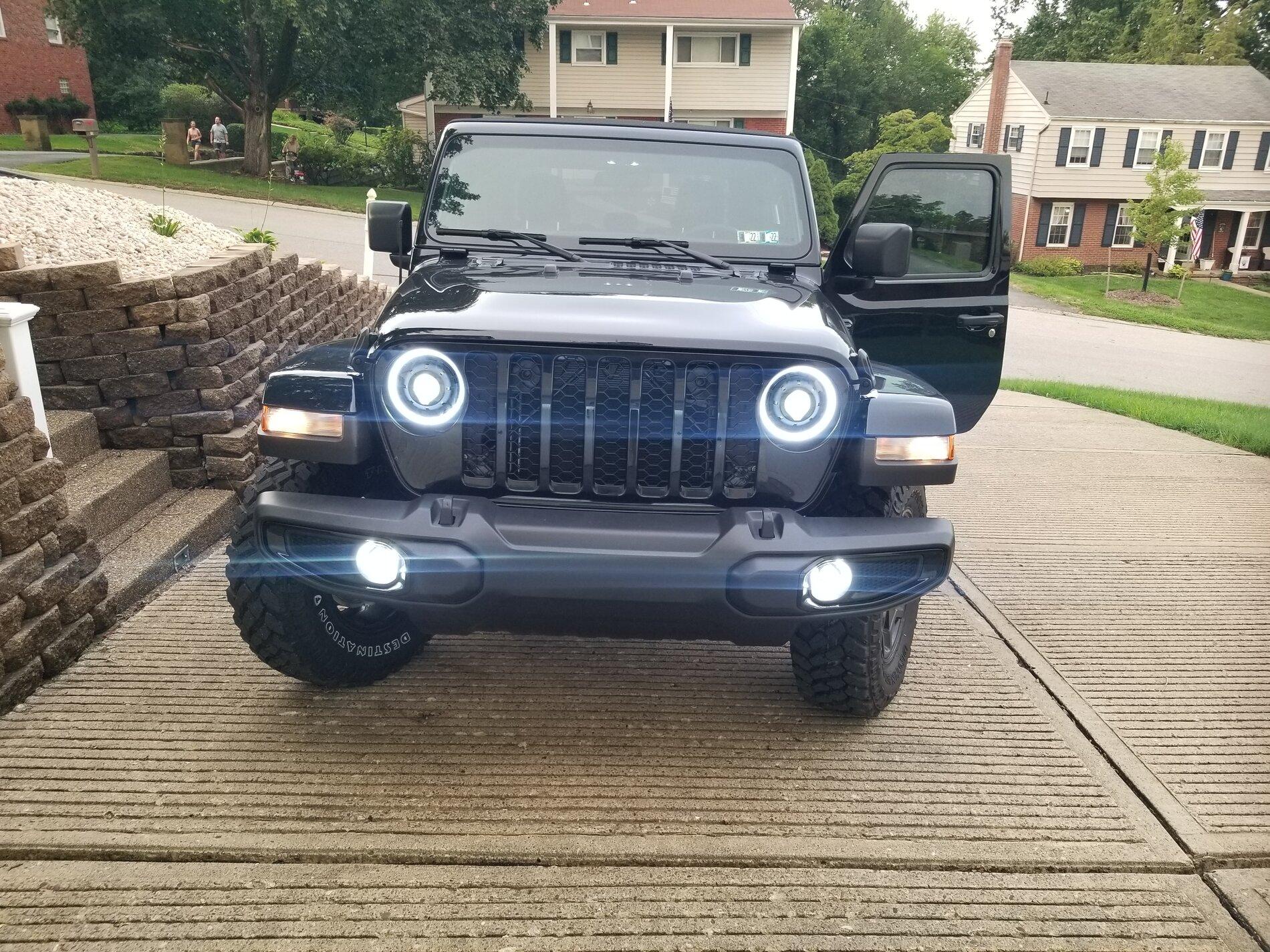

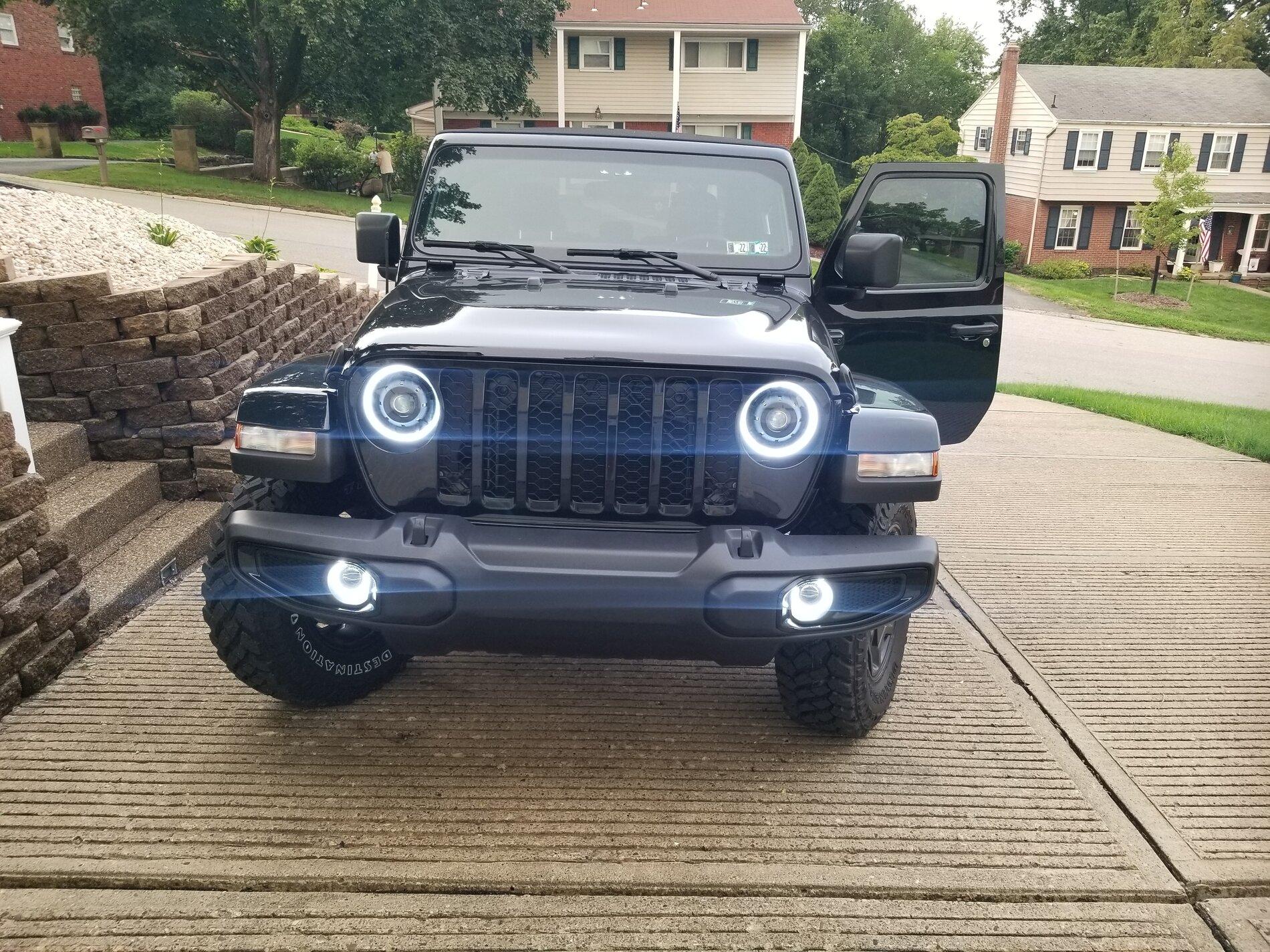

Took my time and after almost 2 hours it all worked on the first try. Thanks for the advice
The 2nd pic is only the DRL.
Looks awesome, Mark! Glad we could help. Please reach out if you encounter any other questions with your lights, and our team will be happy to help!
