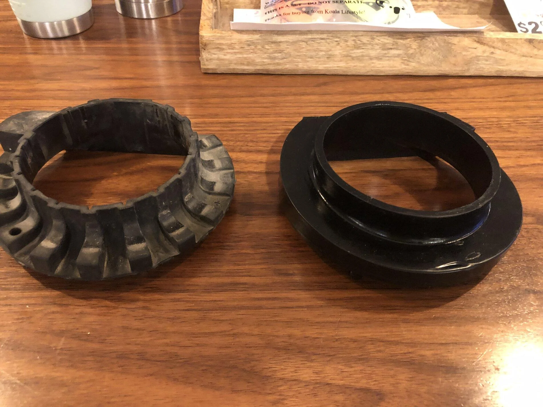

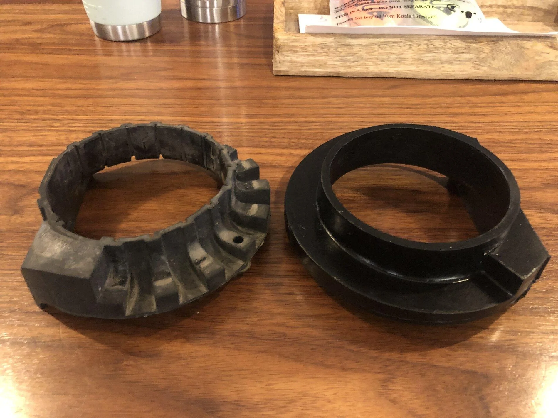

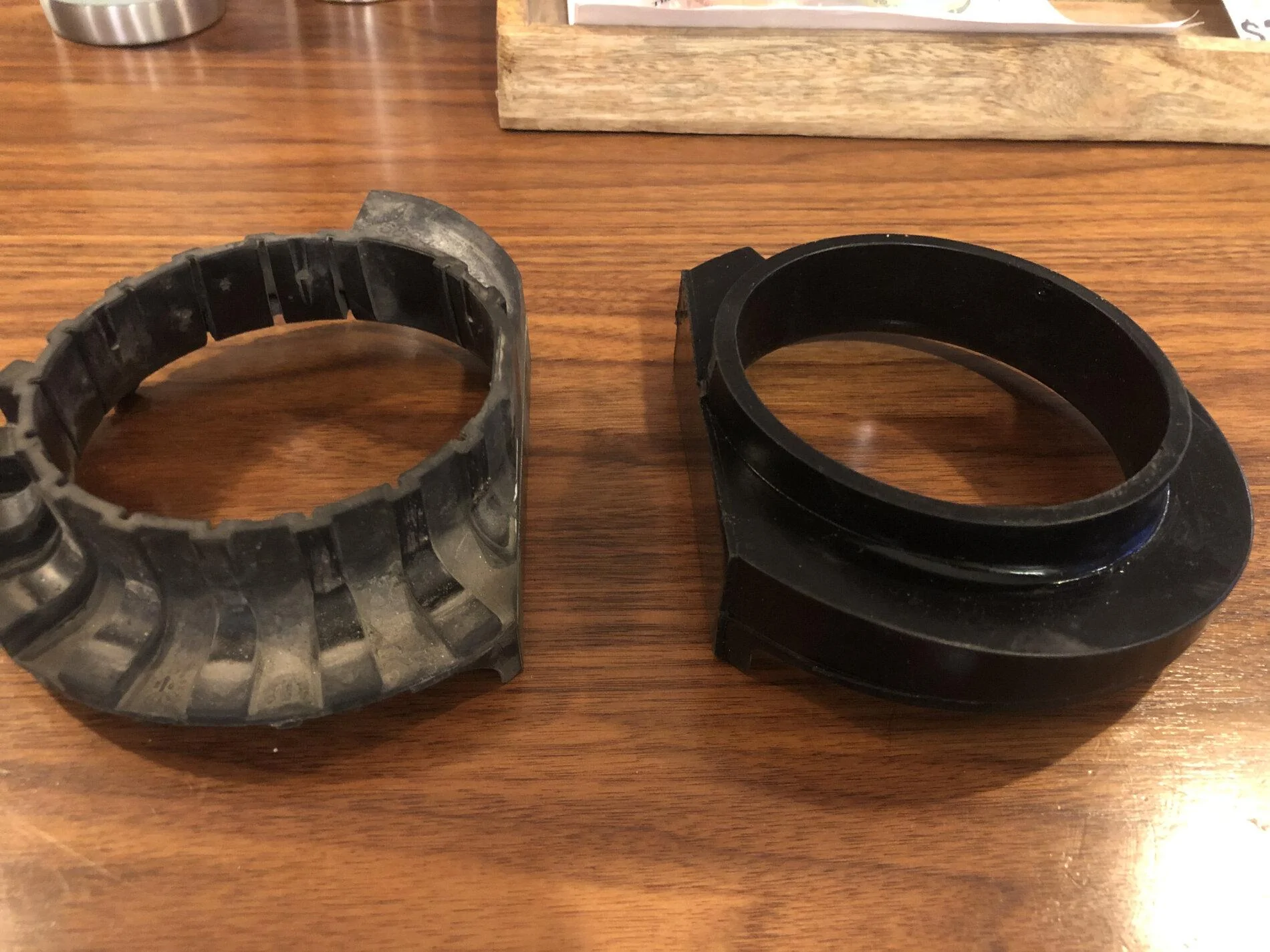

As one response a day or so ago pointed out - at least one type of lift spring has a flat bottom and that would totally explain the necessity of running their own lower pad. Putting those springs on the stock bottom isolators would definitely do funky things.
So I would say after more looking that if the spring bottoms are not IDENTICAL to the factory springs, they would absolutely need a different support or pad to rest on.
I had assumed all were designed with the same bottom coil configuration - mistaken assumption. That alone explains at least some requiring different bottom supports.

Here are some pictures of the stock spring pad vs the Daystar pad, the Daystar is much higher on the opposite side from the side where the coil ends. I put them on my JT with the 1.5” Daystar spacers with 340 and 343 springs.
