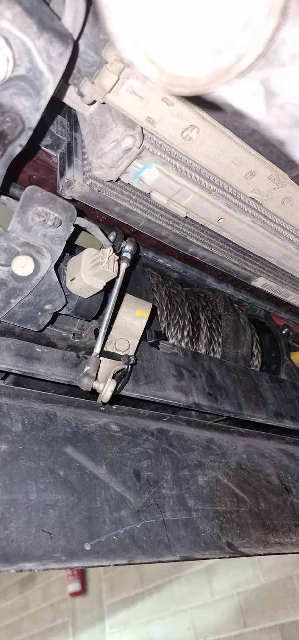

Hi!
Deleting the front sway bar I found a sensor with a little link. Anyone knows what is it? and is function?
It's one month that my sway bar doesn't work because it's disconnected and I don't have notice anything driving.
Thank you!
Jeep Gladiator Front Sway bar sensor 20251020_080714

This one stumped me for a minute. That is a headlamp level sensor. Think that is a European/export model thing.

Spot on Hootbro , I came acrross this when I finished my lift and changed SB links in the last couple of weeks, you can adjust it with a small spanner if needed if your SB links are not the right size to replicate stock

So whats with the zip ties? Cheesy looking I think a part fell off 😂

Thank you guys!
Yes it's an european model. I blocked it with ties because for now I don't have a front SB. Now I'll zip it better controling the right hedlamp level.

How do you keep it in the road without a front sway bar ?

Really I tought there was some problems...but I drive well. Not running. I broke one apex link and now I'm serching for the antirock.

So the EU version has auto leveling headlamps? My old Infiniti FX has 2 manual settings for lowering the headlights when carrying a heavy load or towing, wish the Gladiator have that feature.

It does lol..
Its called a bigger winch
