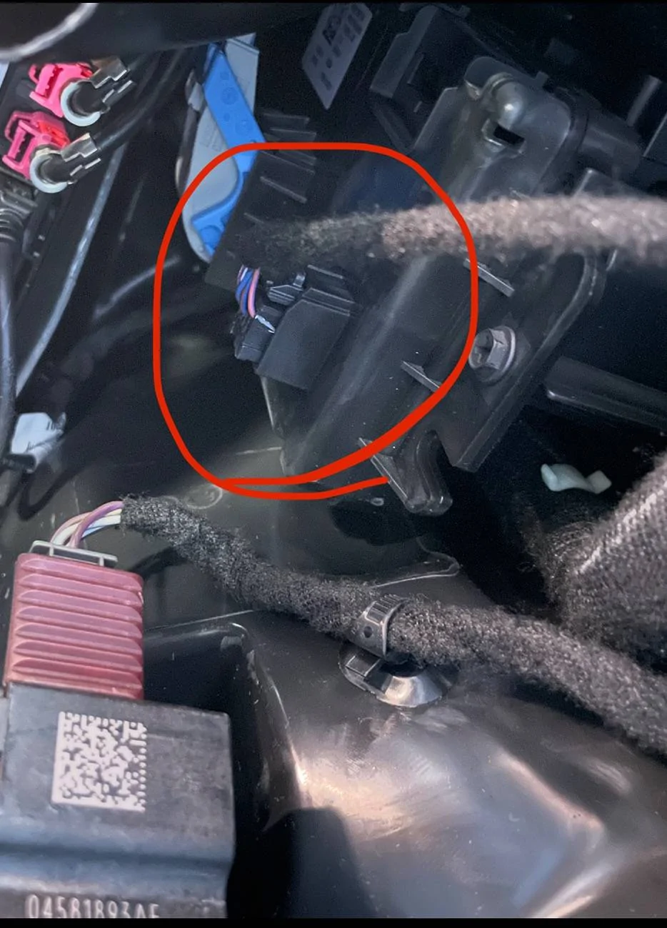

Sun Sensor = 68230114AB Light load sensor for HVAC and Auto Headlights Avoid 68230115AB which is HVAC only.
Headlight Switch = 68542459AA is the one with the auto setting, Avoid 68542460AA it is the one without you already have.
enabled JScan -> Adaptation -> Auto Headlamp & Auto High Beam - Settings -> Auto Headlamp Feature Present On/Off, - Target Value = Active.
enable JSCAN -> Modules -> Body Controller -> Configuration -> Headlamp on with wiper customer settings menu -> Set
(not sure if actually needed but go ahead and turn it on so you can on/off it from the Radio rather than have to jump through JSCAN Menus)
@webduelist - Brother, this worked like a champ! I ordered the part numbers listed, followed the JSCAN menu and, boom, auto headlights. Super easy upgrade the way you've got this outlined. It probably only took 15-30 minutes (once I finally got the bypass cables connected, LOL). This is the most useful mod we've made so far and the wife loves it! Thanks for making this post!
