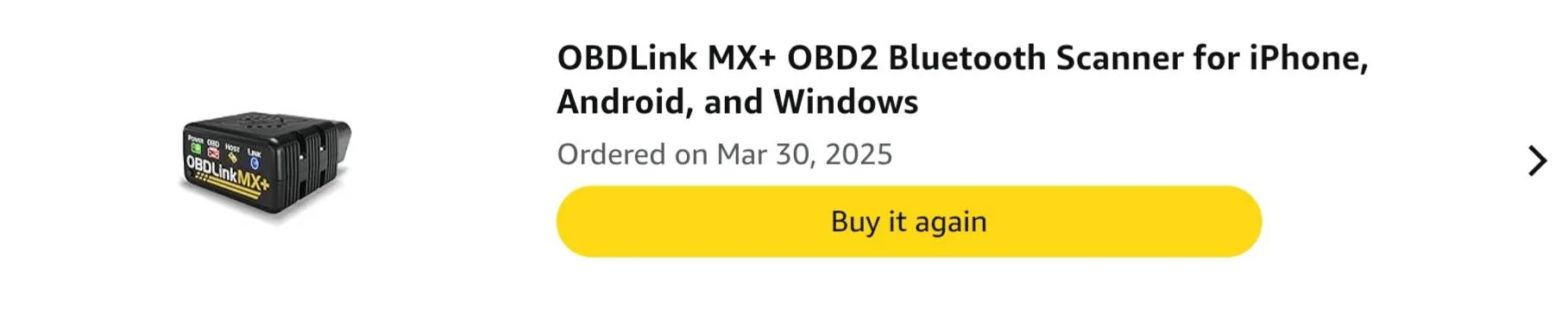

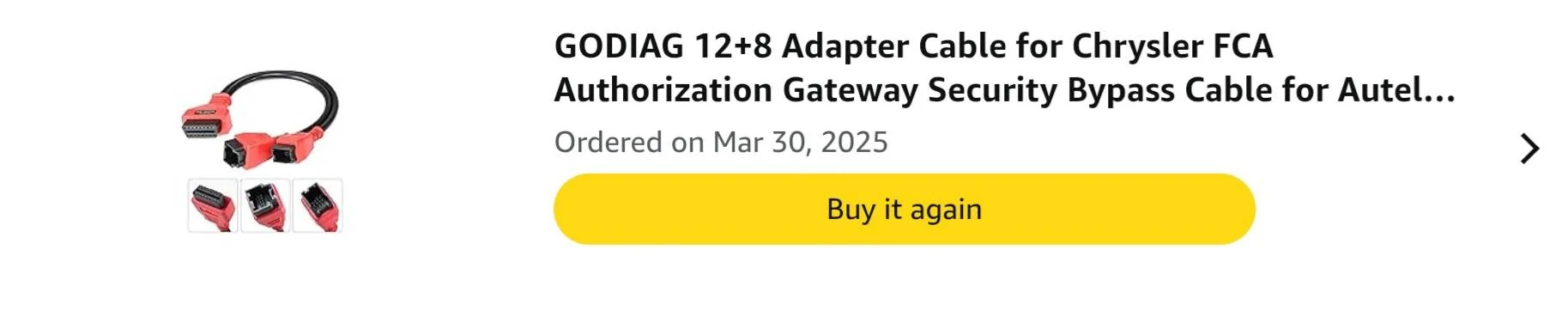

Hello, I’ve been following this thread and today I finally installed on my wife’s 2025 sport her new headlight switch with the auto feature and the sensor on top of the dash. My question is on this J scan. Can you give me some more insight on this please? Where do I download it at and how do I connect it to the Jeep? Is it through the OBD port?
You'll need an obd scanner and the bypass cable. Google play store has Jscan.
Jeep Gladiator OEM Auto Light Switch install? Screenshot_20250523_211813_Amazon Shopping
Jeep Gladiator OEM Auto Light Switch install? Screenshot_20250523_211829_Amazon Shopping

When it comes to JScan, the $15 VEEPEAK OBD2 dongle has done everything I have asked of it. I know there is other OBD2 dongles North of $80+ that seem to be popular, but if you do not want to spend that kind of coin, the VEEPEAK will work for JScan and any changes you make with it.
https://www.amazon.com/dp/B011NSX27A
