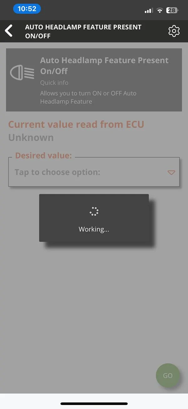

Need help. I have a 2025 Nighthawk and just got my Sun Sensor = 68230114AB and Headlight Switch = 68542459AA. I followed the JScan settings Adaptation -> Auto Headlamp & Auto High Beam - Settings -> Auto Headlamp Feature Present On/Off, - Target Value = Active and enabled the Modules -> Body Controller -> Configuration -> Headlamp on with wiper customer settings menu -> Set, and it isn't working. I don't see a setting on the head unit. I even enabled JScan: adaptation/ auto headlights/ twilight sensor, and still not working.
Under the Adaptation/Auto Headlamp & Auto High Beam-settings I see there are Auto HeadLamp OFF Threshold and On Threshold. I looked at those, but they only have Voltages as values, and I don't want to mess with them without knowing.
I have all the wires and everything, and I know this will work.

I did the upgrade last night. 25 nighthawk and it works perfect. Used the same parts as you have listed. After replacing the the parts I did have some related codes so I cleared them first, Then I only enabled the Auto headlamp to activate. You may want to check and make the sun senor connector is fully seated. Good Luck
